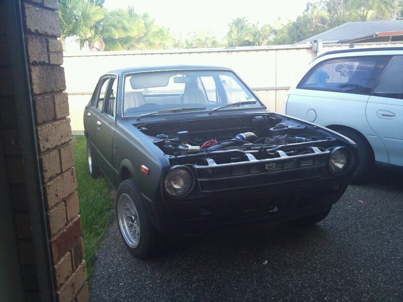

another pic.. it is going in to be painted this weekend these pics are a few months old, getting painted white.
the timing is fine, and when i drive the car like a grandma it drives perfect, its only when i push it at high rpm it seems like its not getting enough fuel..

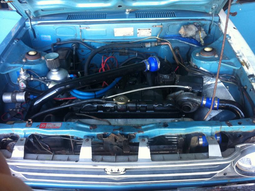

I will upload a pic when i get home tonight, It was running fine at start of jan, and yeah standard carb and the intake pipe just screws on to the top of the carby, with a rubber seal. It has always worked fine. I Have already cleaned the carby and put a new kit through it..

If you look at top pic you can see the intake pipe coming up from the front mount and onto the top of the carby..
Mate post a pic of your engine bay.
What carb are you running? Have you boxed the carb, or run a boost reference line to the fuel bowls?
The Aisan carbs have the 2 little vents for the fuel bowel at the inlet of the carb.
Boxing the carb only stops boost loss thru leaking gaskets and linkage bushes.
Sounds as if he is running the right setup, with an electric fuel pump and a RR FPR.
