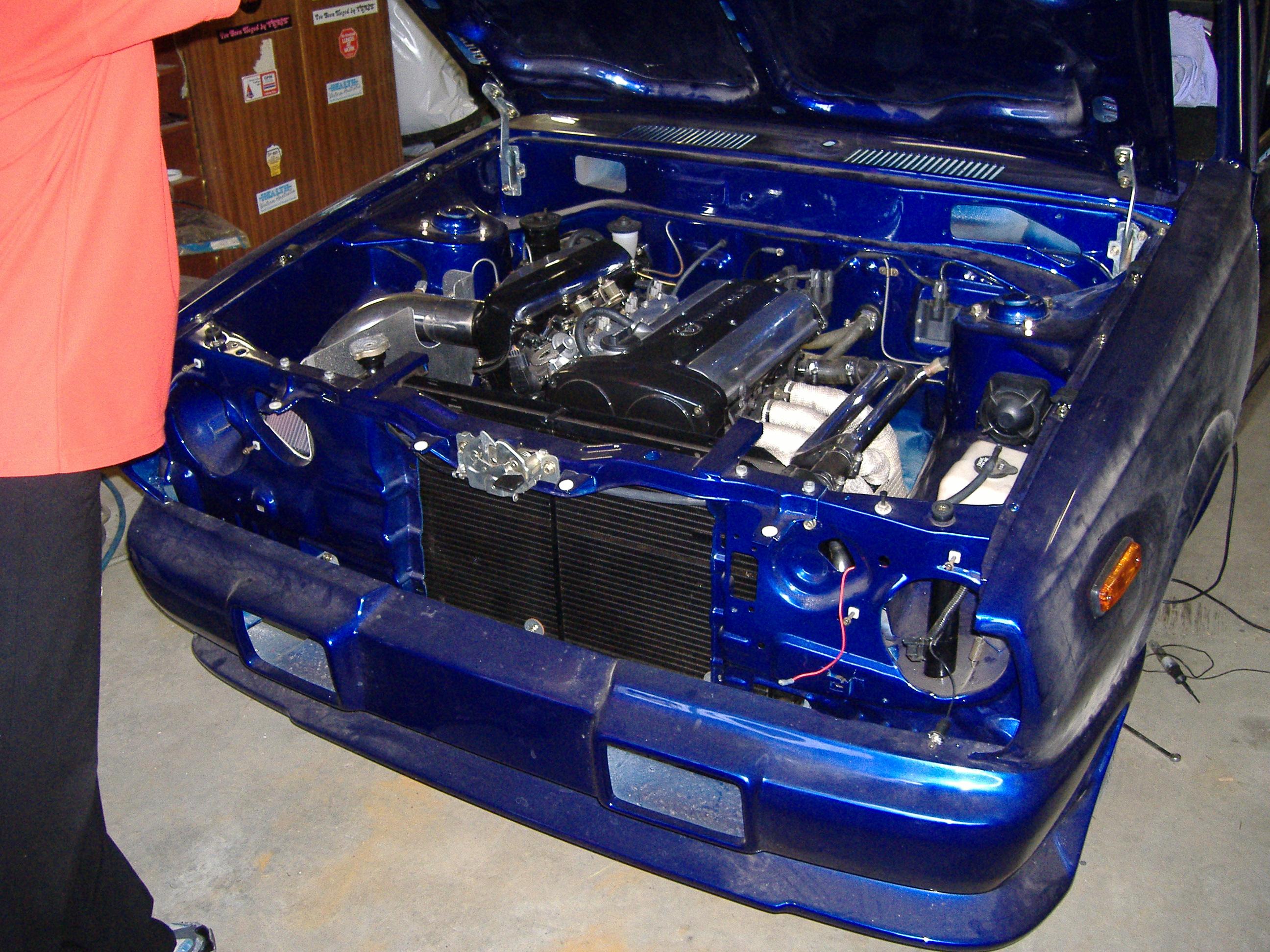

It was a fibreglass kit of an old hyundai excell. I got it free in the qoakka. So i got it chopped it up stretched it and shortened it and fibreglass and bogged it to the body. It is a big and time cunsuming job, so without sounding rood i don't think you would be willing to pay how much it would cost for me to make it. The front fenders also have to be chopped and stregthened to allow the front bumper to bolt up. But if you like doing it its worth it in the end :fuzz:- Ke30 2 Door 20valve Conversion

Hey Mate will try and get some time to upload some more soon. The kit i got for free out of the quakka, Just cut it up stretched it out ect and fiberglassed it on. Took a bit of time though;)- Ke30 2 Door 20valve Conversion

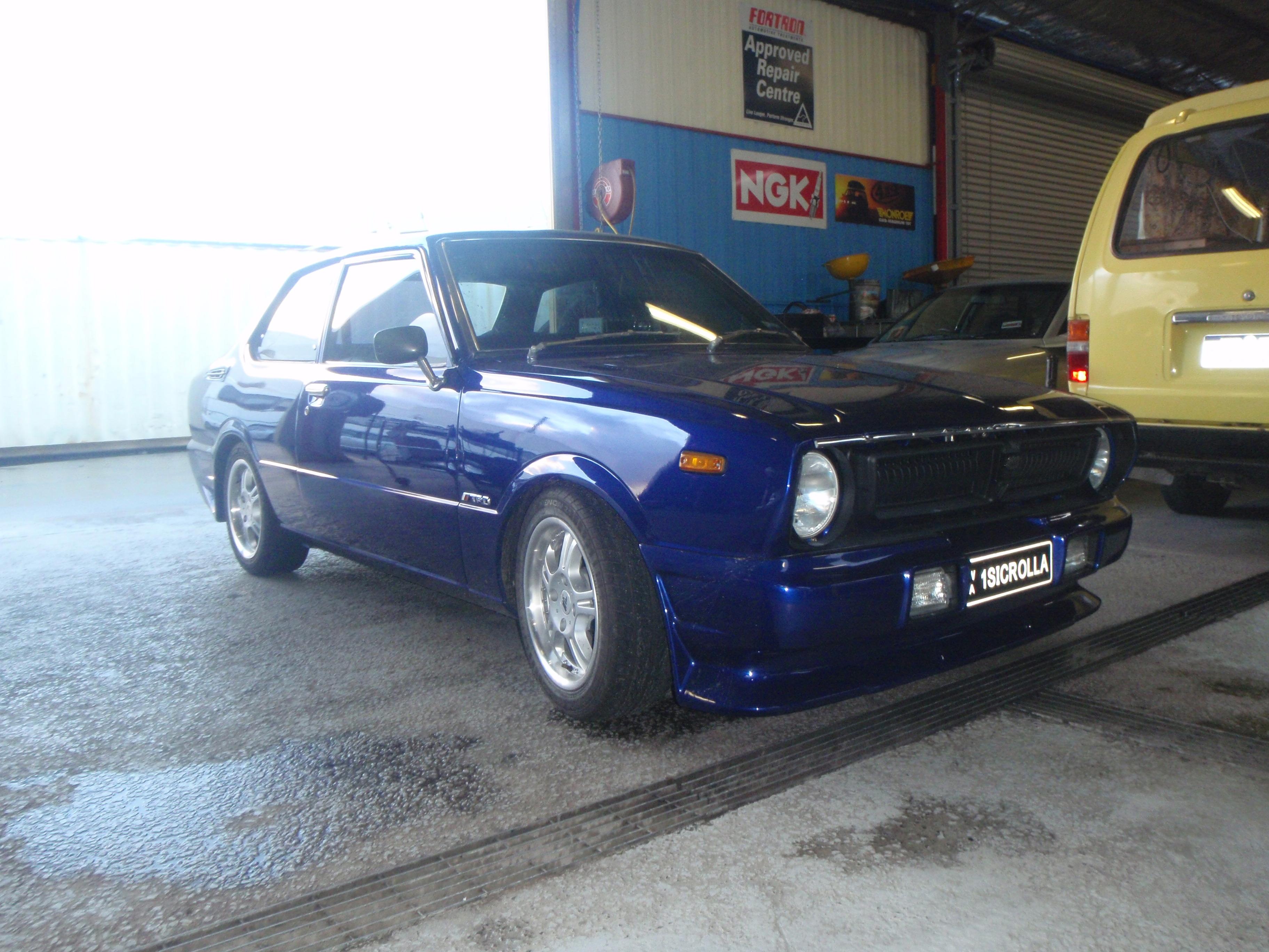

Hey :D The car has been driven know for a few weeks. Seems great. The only prob so far is the slave cylinder on sharpleft hand turns, its close on the inner tie rod end. I am in the middle of putting a stereo in it right now. Here is a pic in the workshop on the weekend. - Ke30 2 Door 20valve Conversion
