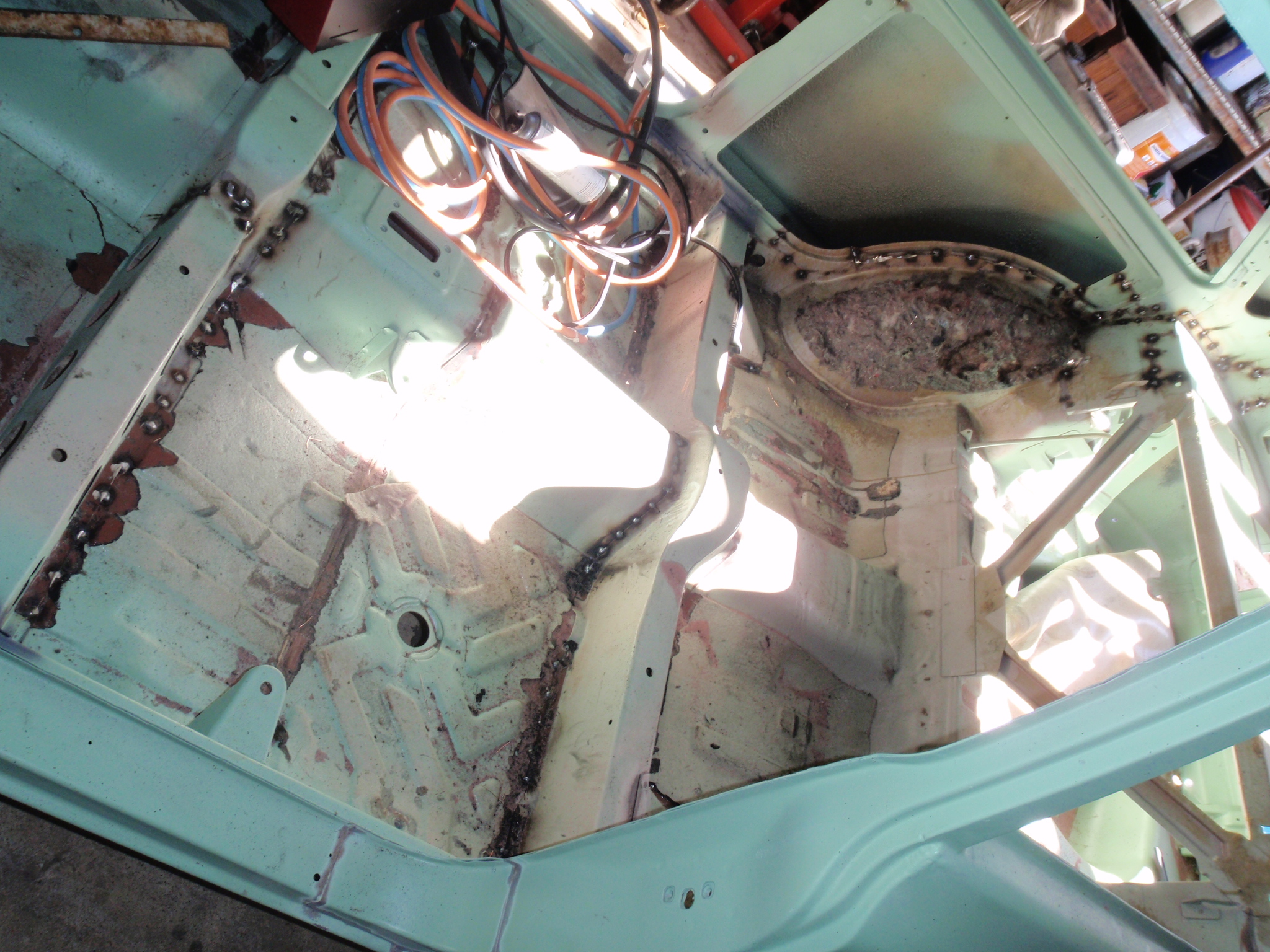

  2. I Have not been doing much good stuff recently just mainly seam welding like in the pics and trying to find some solution to finding some bushes and stuff. more to come though!!

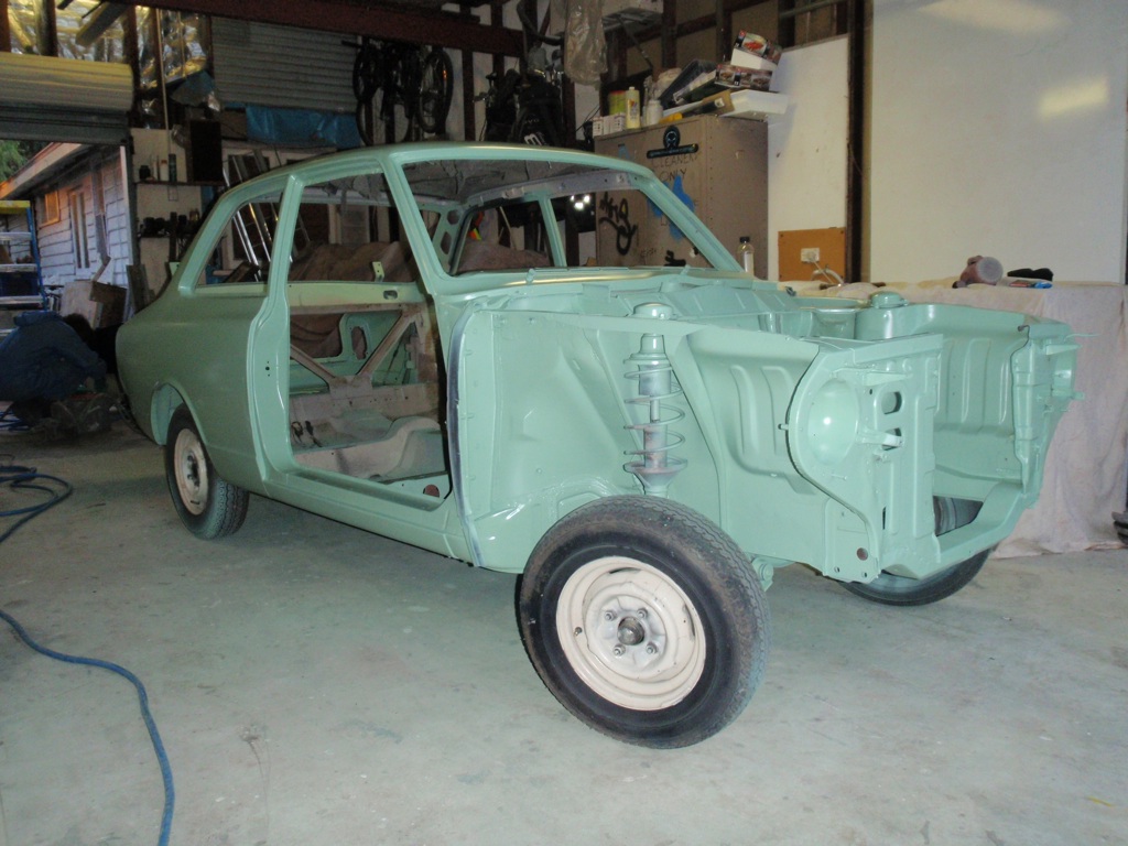

  18. Over the past couple of weeks i have en researching and deciding on what front end setup up i will go following closely to a couple of threads on here. So this is what i have come up with, Front shocks: Pedders Ke20 inserts (Ordered for Monday) Springs: Otomoto Coilover sleeve kit 4kg/mm springs (Paid For) Brakes: Hopper Stoppers Kit (Will Purchase this week) Just to clarify Do i have to order the early model corolla kit but when i asked hopper stoppers if they would fit a ke10 they weren't to sure due to them coming out with drums. Can any body confirm this before i get them. I'm sure its the right one because you can put the ke20 disks on the ke10 so i don't see what the difference is. Not much more at but I'm hoping in 2 to 3 weeks time the whole front end setup will be done and the rear is next!!!!!!!!!!!!

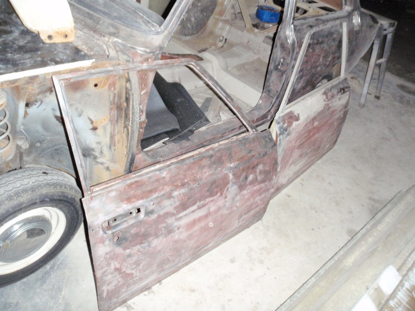

  20. There wasn't much rust at all in the car. there are a few small holes from where the body trim has been sitting and a there is a water trap at the beginning of the rear wheel arches under the body but i'm going cut it right off, sand blast it, rust convert it, re weld and prime again. I have been given a really good shell with minimal rust but most of the panels are bogged like hell. i would rather have the body perfect anyway because you can always track panels.

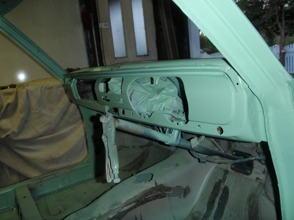

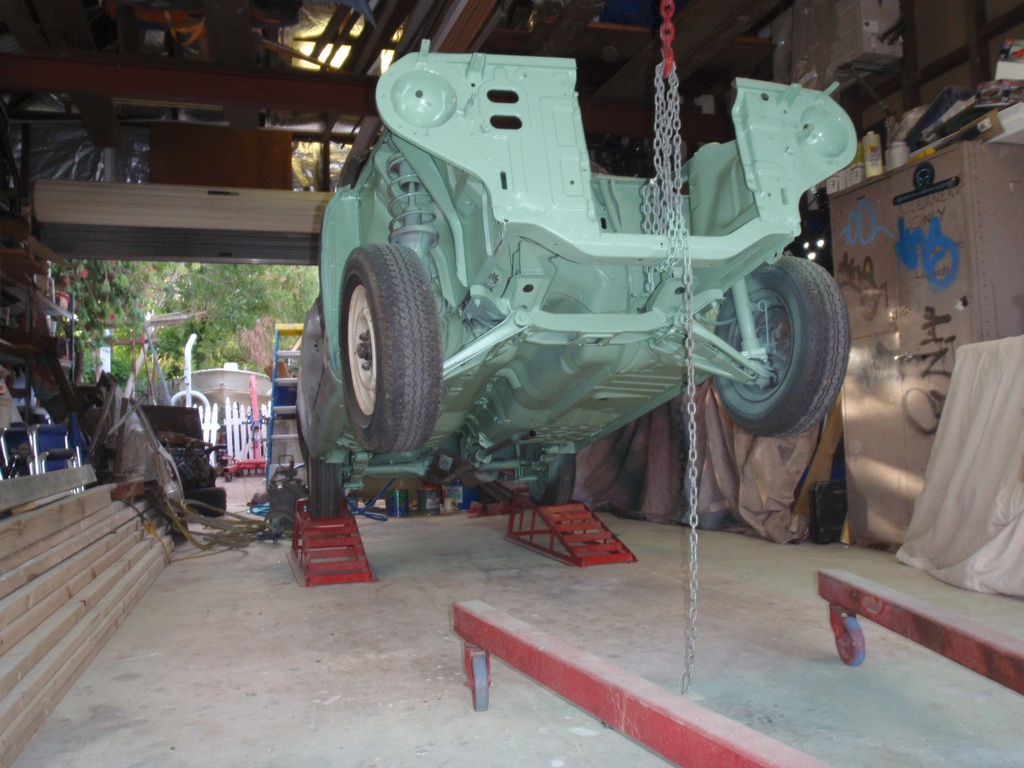

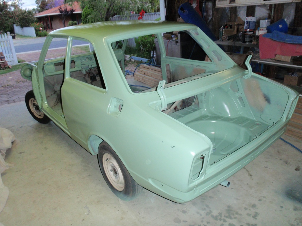

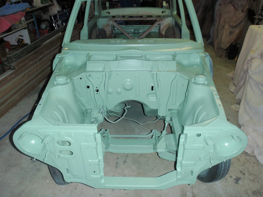

  21. WOOHOOOO more progress. I used a marine grade epoxy primer throughout the entire car. i still have bits of rust to cut out but i didn't want the bare metal to be sitting there for too long. feel free to leave feedback guys!!!

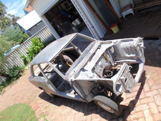

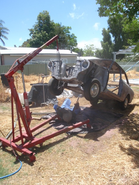

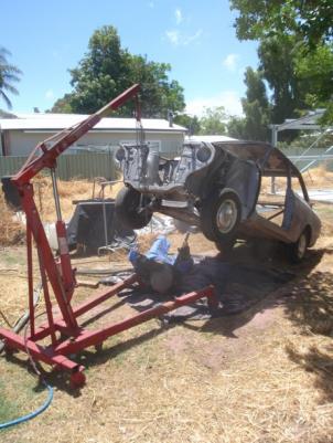

  22. On friday we thought we might just tidy up the front end and all it cost me was a carton!!! I got a few cool shots in the process. THe car is now being primed on monday because we found a bit of rust i want to cutout..

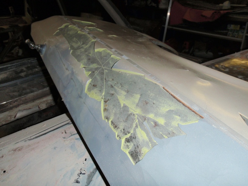

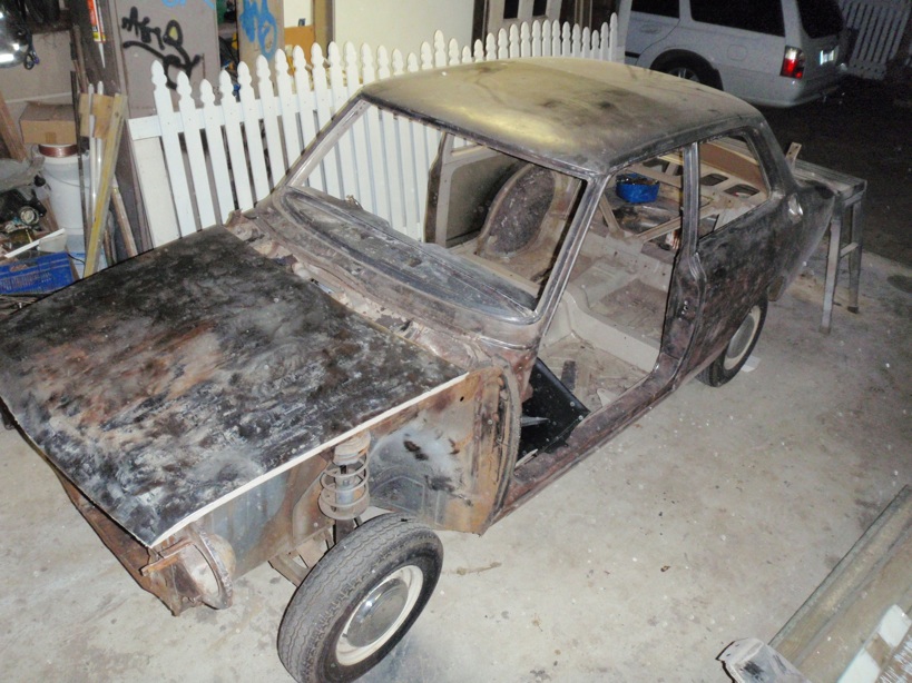

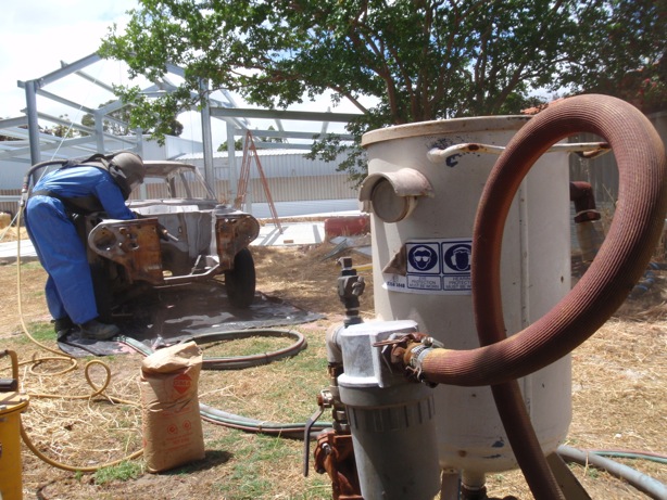

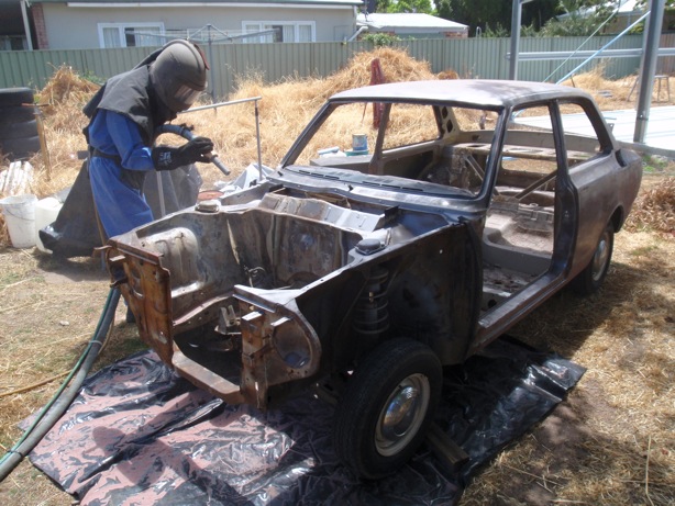

  25. Cheers boys, its good to share the passion... well there hasnt been a huge amount of progress in the past few days besides more paint stripping and thank god I'm at the last stages of that. The next big part is going to happen next friday when the bloke across the road will be firing up his sandblaster to clean up the firewall and little spots of rust and hopefully if there is enoughlight left in the day to have everything sprayed in primer! But there are a few things i need to have done like Make sure all the paint is off and Undercoat the car in that black shit. Oh and as you can see in the picture that is why i need a new fender haha!!
