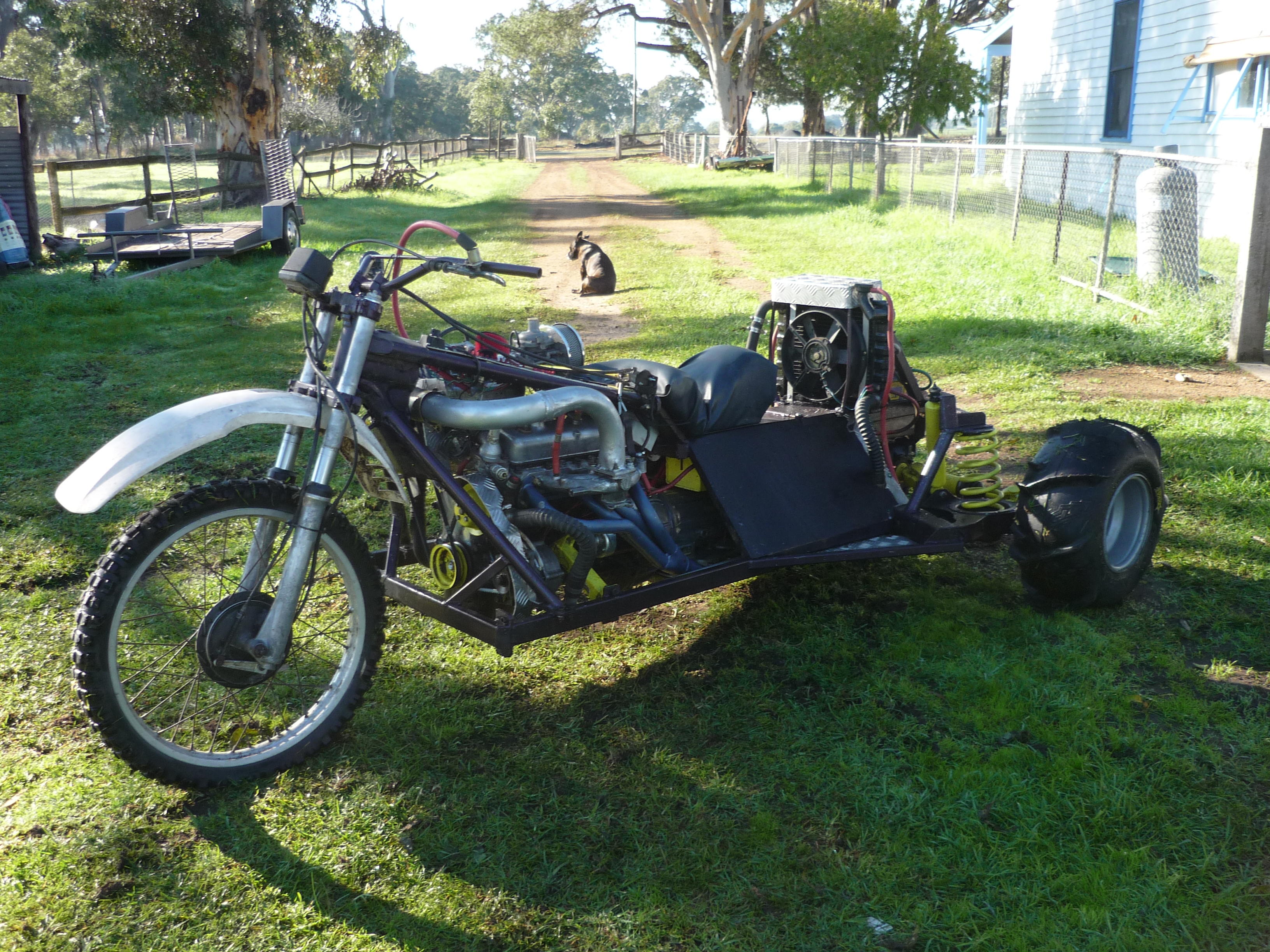

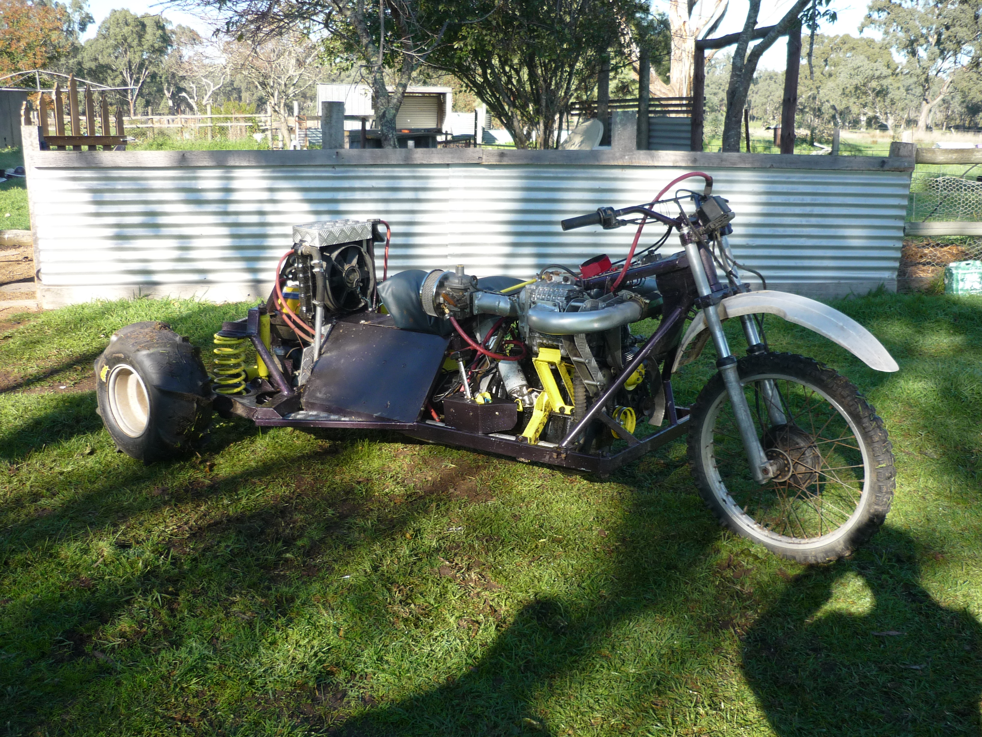

  11. finally got some pics up just blown the 3rd head gasket having trouble with the timing it seems to be advancing 8-10deg over 3000 rpm i think the msd unit should retard it it mite be time to find an expert ($$$ permiting)
  12. got new ed gasket fitted extractors are on tuned up going great responsive on the throttle sounds sweet pics/vid soon
