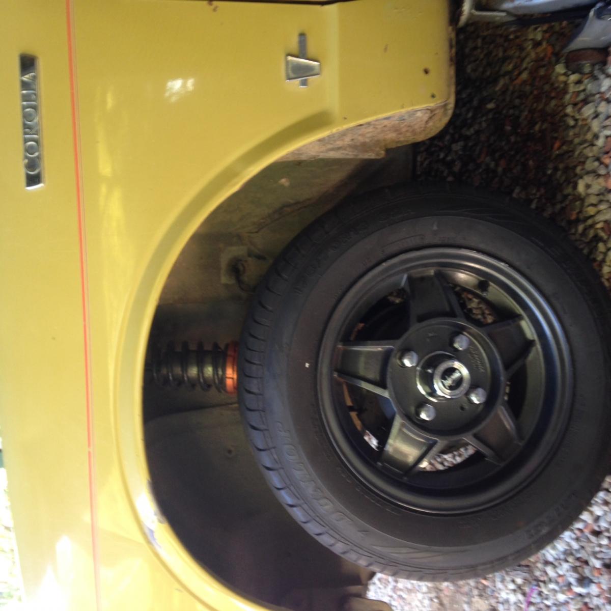

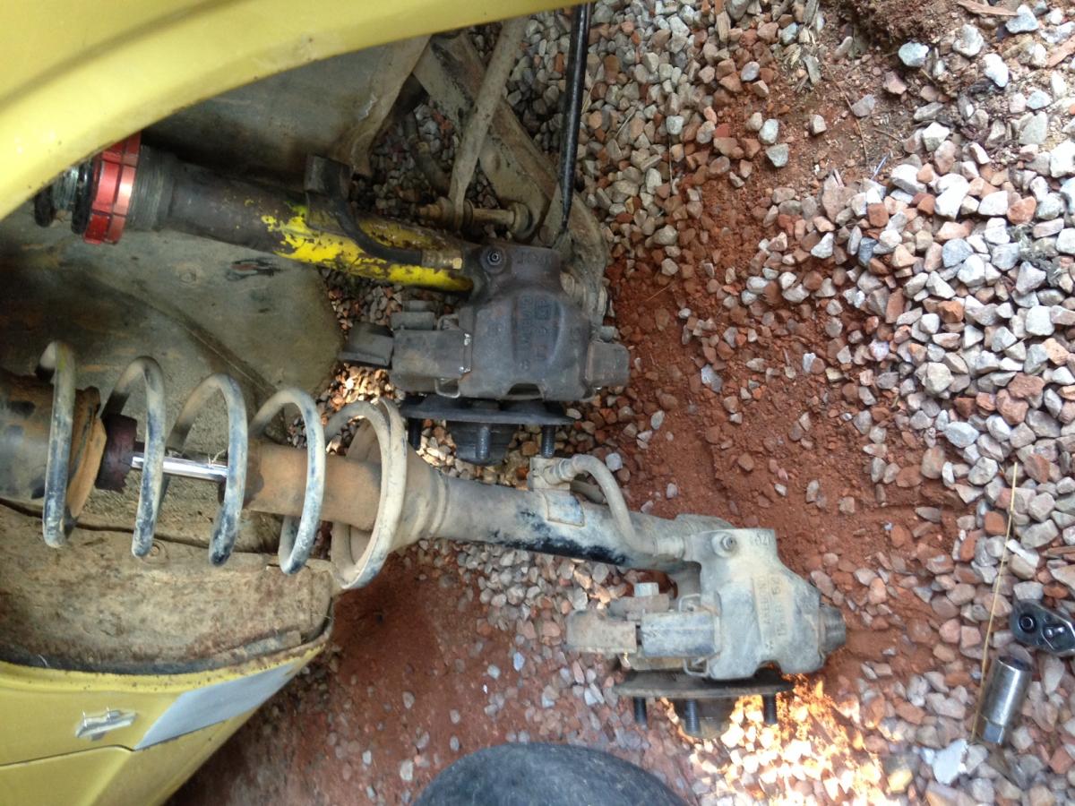

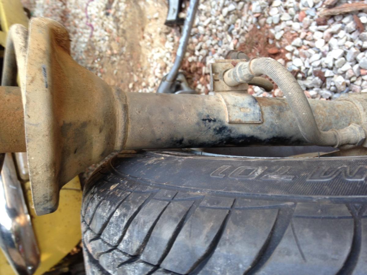

  1. Thanks for the replies guys. Pretty bummed! There aren't any other explanations for this problem hey. Well, is a bent strut unsafe, even if I ran lower offset wheels? Would like to get it fixed, but don't have the means myself. Any idea how much it would cost to fix the strut once I confirm bend?
  2. Are ke20/ke25 struts different, because even on the standard strut there is hardly any clearance, and yet previous owner assures me that there was lots of clearance on his ke25 (no spacers used). They are pretty high offset, but I thought they would fit my car based on the 25.
  3. Hey Rollaclub I bought a set of wheels that were run with no problems on a lowered ke25, but when I put them on my KE20, the front right wheel and coilover hit. the actual rim presses against the coilover, whereas i have a few mm clearance on the drivers side, and everything is good. All wheels are the same size and offset etc (13x 5.5 + 35 offset), and the coilovers are just modified ke20 struts (weld on coilovers made by previous owner). I tried a wheel on a standard ke20 strut and there was a tiny bit of clearance (<5mm from the tire). So this problem is only in one corner. All i can't think of is bent strut, but it doesn't look bent. Is it possible to change the angle of the hub any how? HELP?

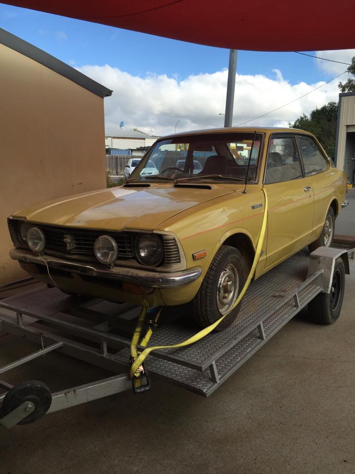

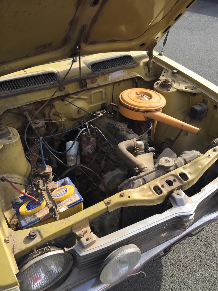

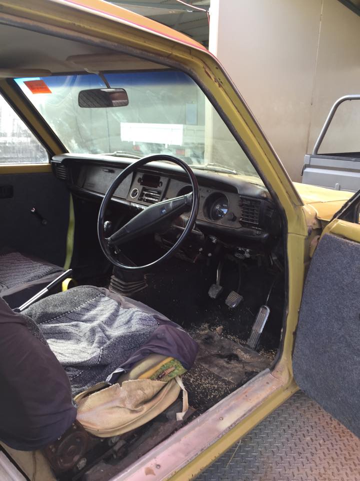

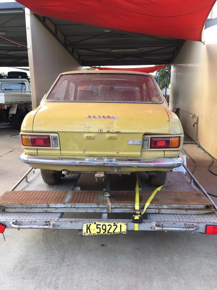

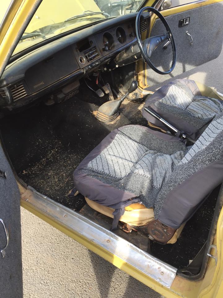

  6. Hey guys/ gals! I am hoping to pick up my KE20 this week, having it couriered to Sydney as we speak, so I haven't seen it in person yet. Excited. This car is going to become my daily driver, but ill need some advice on getting it back on the road. Heres what I know about it so far: -KE20 2 door (unsure of year) -Has been in a shed on a farm in Western NSW since year 2000. - Previous owner pulled it out, cleaned the points on the dizzy and got it started. - It drives (well, apparently) - Manual 3k 4speed. - Standard as far as I know, apart from foggies. -Has minimal rust, but some fairly sized dents (may need new boot lid and FR guard) So where should I start in terms of getting it ready for Blue Slip given that it's been sitting so long? I have access to a spare 4k engine and KE55 Suspension. Should I expect the gaskets to be damaged, parts seized, rust in fuel tank? What would you guys do? Any help super appreciated!
