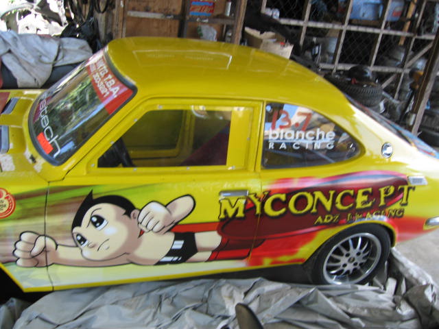

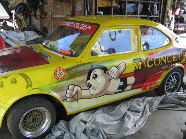

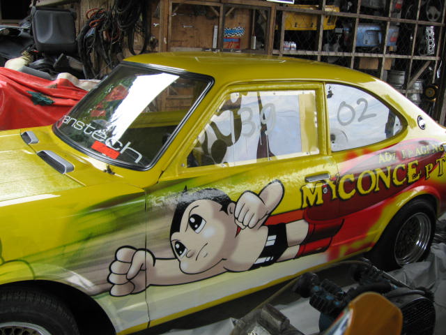

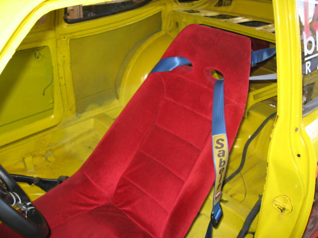

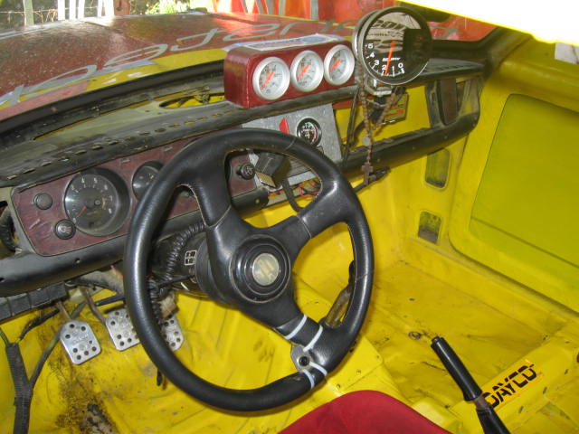

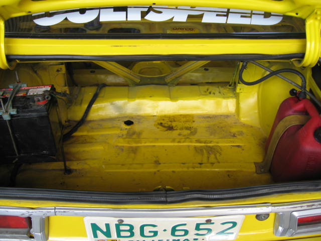

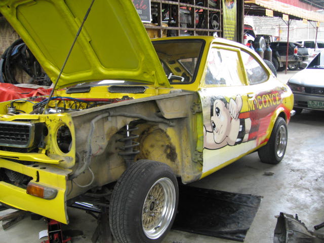

  1. i have some pictures of the car. i took them 2 days after the race which was stopped due to heavy rain (you can see traces of dirt inside and outside the car) i ran 13.72 on the 400meters. i won the first round. it will be continued on january 8. i just retouched the artwork on the sprinter and added one more for the hood. check out the chick on top of my hood.

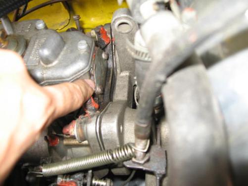

  4. (I'm probably being laughed at now since i posted this again... i can't post the picture on the GENERAL MECHANICAL forum... well, stupid me....) has anyone replaced the gasket on this part of your carb? will silicone work even without opening the back lid of the carb? the mechanic said there's "air" coming out of it...

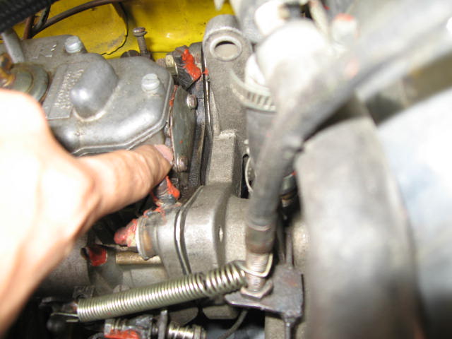

  5. has anyone replaced the gasket on this part of your weber carb? is there a repair kit available or will silicone work even without opening the back lid? oooops, what happened? i can't attach a picture on my msg.
