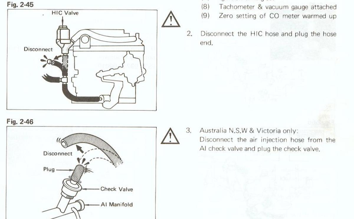

Hi all, Just after a little guidance/ assistance. Now I have used the search function and it has not helped, hence the questions. The KE70 I have has a standard 4K-C and carby on it. I'm about to put a carby kit through the carby and clean the damn thing, as the car will not idle and I suspect that the idle circuit in the carb is blocked or there is a restriction. Now I have checked the timing without vaccum assist and its at 8 degrees, cleaned the points, spark plugs and dizzy cap and rotor button. The valve clearance have been just adjusted, I have replaced the fuel filter and cleaned the fuel line between the tank and filter with compressed air. I have replaced the fuel line between the fuel pump and fuel filter and I have clean the fuel line between the carb and fuel pump. Now reading the Toyota engine manual, under tune up it talks about removing the vac line to the HIC valve and block the hose and remove the var line to the Air Injection check valve and plug the vac line. Now for the life of me or its my dyslexic day I am trouble finding both of these. I am assuming that HIC = High Idle Control, now the only check valve that seem to replicate this is a green valve that attaches to the air cleaner on the passenger side of the vehicle. Is this it ???? And I have no Idea where the Hell the AI check valve is ??.......... I can see the Exhaust Gas Re-circulation Valve but from my experience these are usually 2 different things. One channels exhaust gasses back into the engine the other usually pump air into the exhaust like what was found on the Holden VK commodore black 202 engines. I have upload the page I'm referring to in the manual below. Thanks in advance. Cheers Luke
