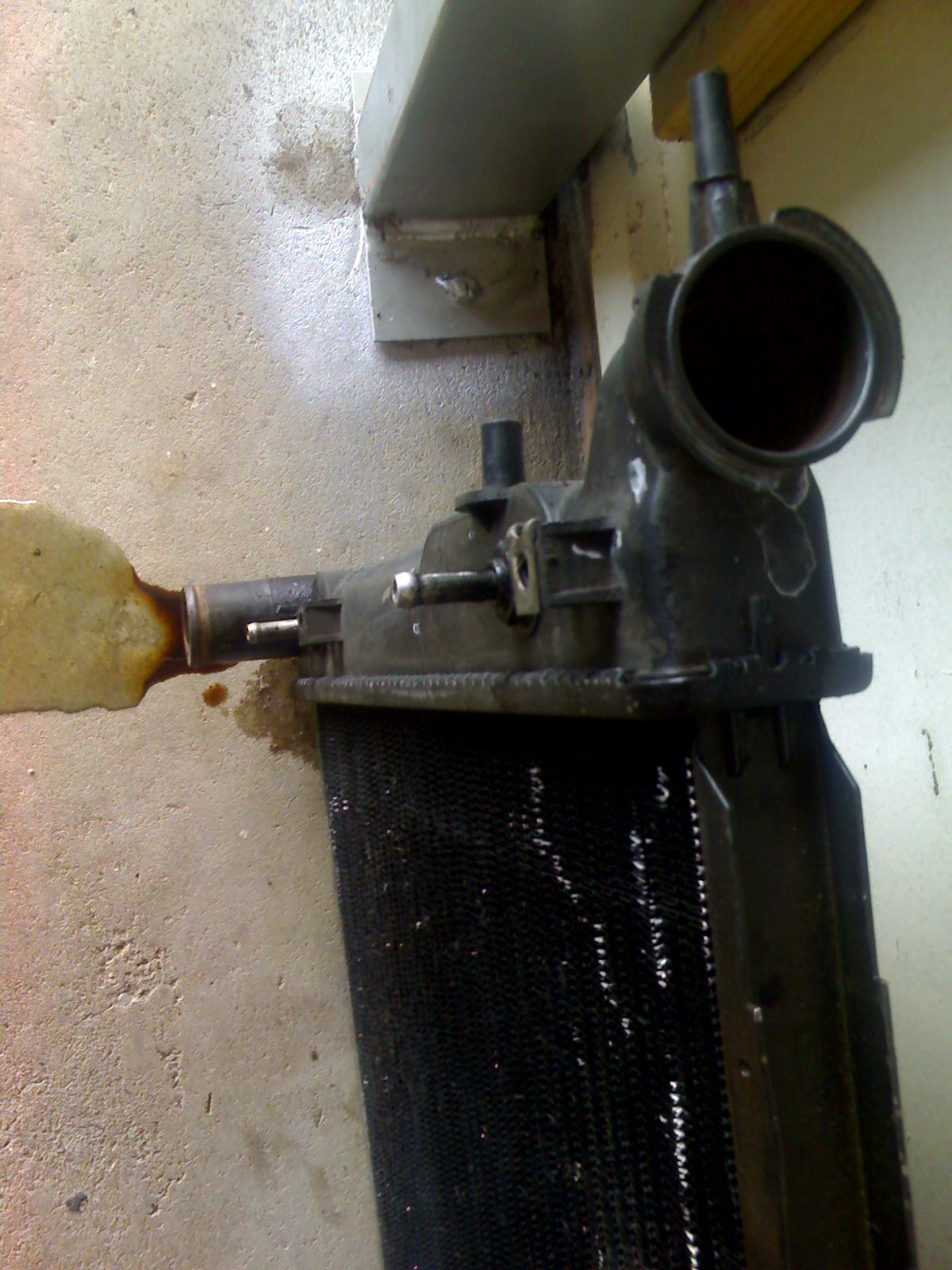

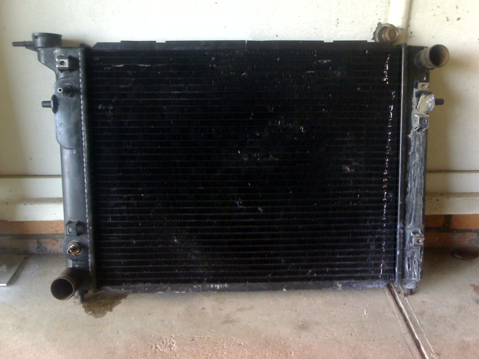

thats a v8 one a v6 one is thinner and is alluminium if you were pushed for space i personally would get a seperate one to the radiator
True it came out of my sisters VS v6.
The B&M oil cooler might be the go and i might try and find a radiator from the wreckers as a temporary base.
