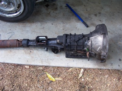

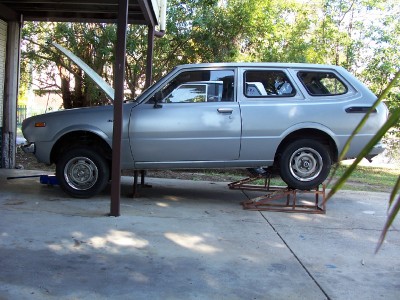

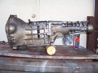

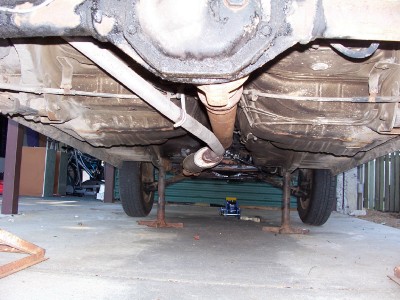

well today ( friday 15th june,it was D day to do it ).so out came the 5 speed first from the ke38 wagon i purchased earlier this year,then put the panel van up on ramps and stands. out came the 4 speed gearbox that has lived and got this car around for 28 yrs nearly (yep factory box.lol),

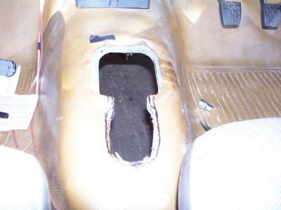

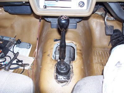

cut the new hole for the 5 speed box changed over the thrust bearing from the 4 speed to the 5 speed (the other one was dry and noisy) and put the gearbox to driving heaven in.the only thing i found trouble with was the gearbox mount ( the guy who did the conversion in the ke38 wagon,didnt use one.BUGGER THAT) i had one and had to redrill holes in the gear box cross member to line everything up eg tailshaft.
other than that it all went very well and the whole job from start to end was only 4 and a half hours from the time i pulled the 5 speed out of the wagon and had it the panel van and test driven,other people may do it quicker but hey I'm 42 now and don't like the ground as much as i did 20 years ago.

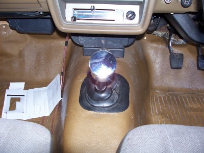

some pics
enjoy

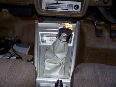

WELLL DONE SIR,,, Do you notice much difference with the shifter being back an extra 2-3 inches..??? does it interfere with the handbrake at all..... reason for asking is that i will be doing the same shortly myself to my vehicle..

I did the same in my ke55. had to cut a new hole. made it alot more vertical(the shifter) makes it easier in my opinion to change gears

Firstly thank you,well so far i have only test driven it around the block.personally ithink the shifter position is much better now and i have no troubles with fouling the handbrake at all. i have had the car up too 80 km/h so far and found no wobbles,shakes or strange noisies.the gearbox may be a bit noisy but hey, beggers can't be chosers.

as for the hole around the shifter,i now have a piece of sheet metal nicely cut and the shifter hole a neat fit with it sealed up from exhaust gases etc. with a good rubber boot and the celica console finally secured properly.

I got a KE70 5 speed, but had another 5 Speed here that i just swapped the gearbox extension housings over with to keep the factory position (I like to keep everything in stock locations, but thats just me).
I will agree that the ratio's arent the same with you as mine runs outta puff quicker than it used to in 1st gear.
