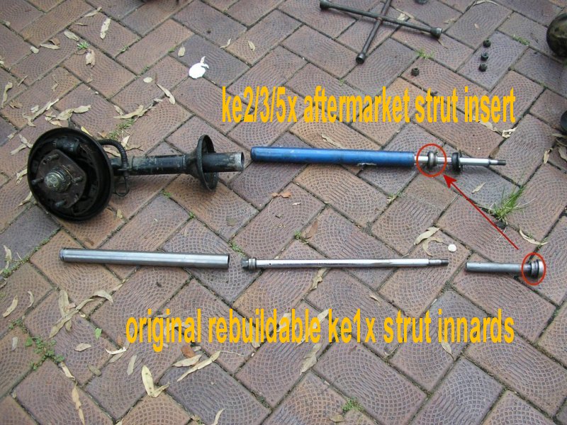

Just use aftermarket ke2/3/5x strut inserts. They slip straight into the ke15 strut bodies, but you need to use a 1" spacer. Attached pic shows how.
