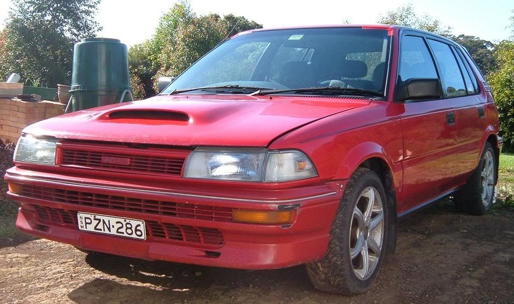

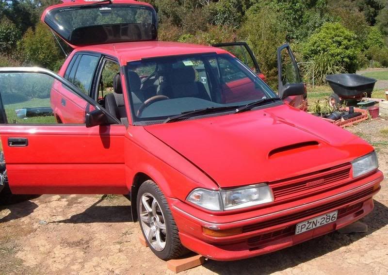

Beejays 1990 Ae93 Sx Hatch With Gze Powah

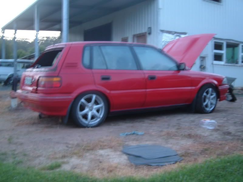

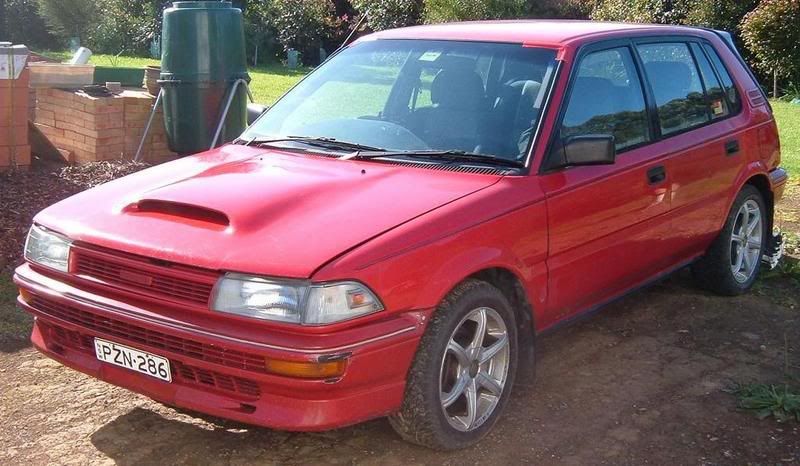

I've upgraded from my AE82 4AC CS sedan P.O.S to this little beauty. Bought in Newcastle a few weeks ago, it was in the June floods. Didn't run and the problem was slightly unknown but came down to the alternator and/or starter motor.
Water came up close to the stereo inside the car, which has caused a bit of surface rust, it will have rust protection carried out in the coming weeks to stop any more problems

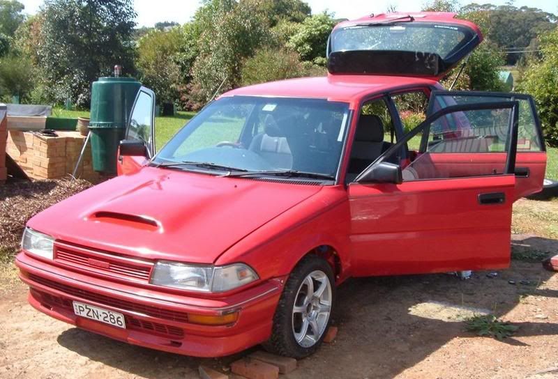

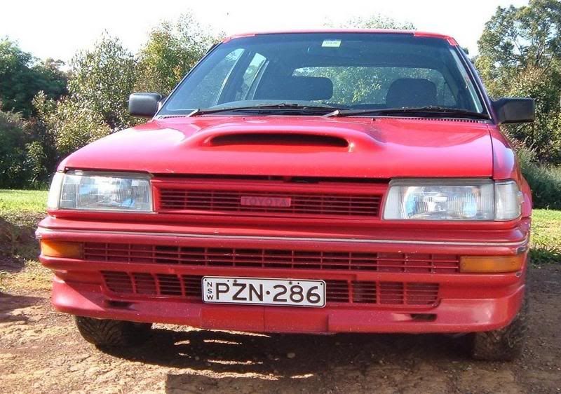

Vehicle: 1990 Series I Toyota Corolla AE93 SX Hatch.
Engine: AW11 MR2 4agze, standard boost and tmic, Microtech LT8s ECU.
Mods: 2" mandrel mild steel exhaust,rear performance muffler, 3"ish tip and pod filter at the moment. (Airbox bought off ebay is in the post)
Driveline: standard SX 5 speed
Brakes: standard series I front and rear disks.
Suspension: Standard SX struts and King Springs superlows (the car isn't going anywhere at the moment, so it allows me to check for and fix any fouling)
Wheels: 17x7 BSA mags and 205/40x17 silverstones on the front & 215/40x17 silverstones on the rear. Rear mags have been sprayed, fronts are in the process.
Shifted to the shed: 15X6.5 6 spoke mags with 195/50x15 kingstars (generic Hankook BTW) on the front and Bridgestone Potenza G3s on the rear on the back.
Exterior: Door strips removed, Red Rollaclub.com sticker to come)
Interior: JVC headunit and 2 Lightning Audio 12''s to be installed one the car has been cleaned up
Future changes include: KYB struts, CAI improvement, source some tinted and/or pinstriped Nova tail lights, 15-20% black window tint, front and rear splits, new carpet....the list goes on.

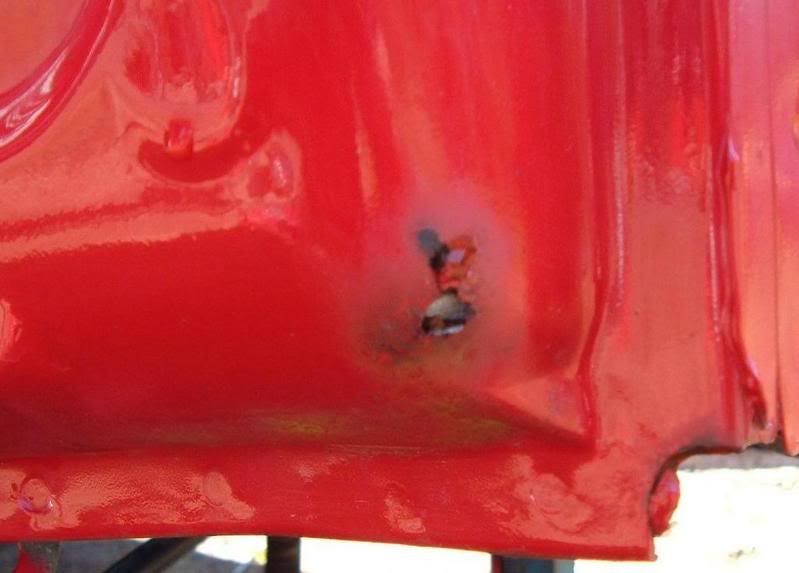

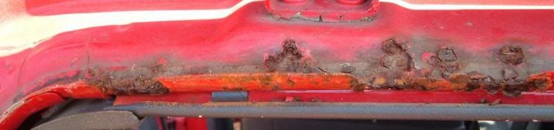

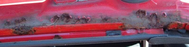

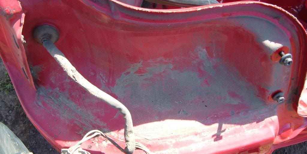

ouchy rust
the right side upper hatch sill
the left side upper hatch sill
left side rear corner
and the spare wheel well

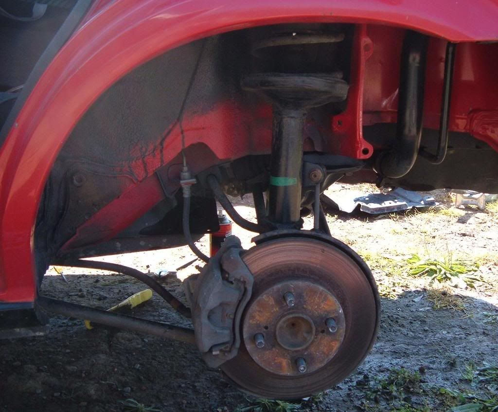

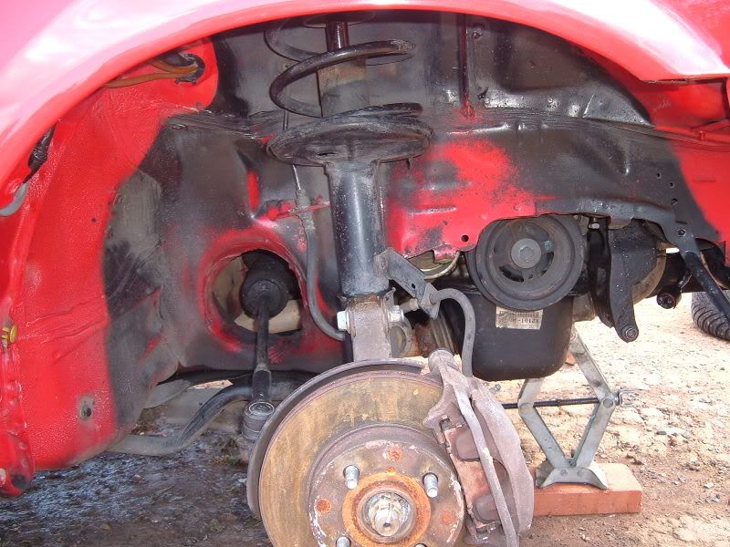

cleaned up all the wheel arches, they were full of mud, cob webs and brake dust, will respray with deadener eventually

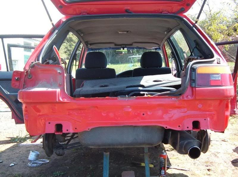

yesterday i stripped the rear out totally and dealt with crap like this, the joys of a new car.

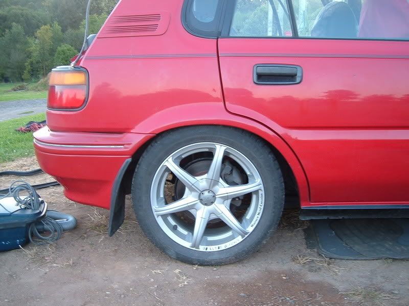

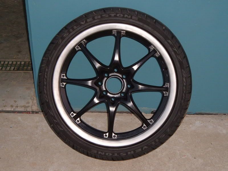

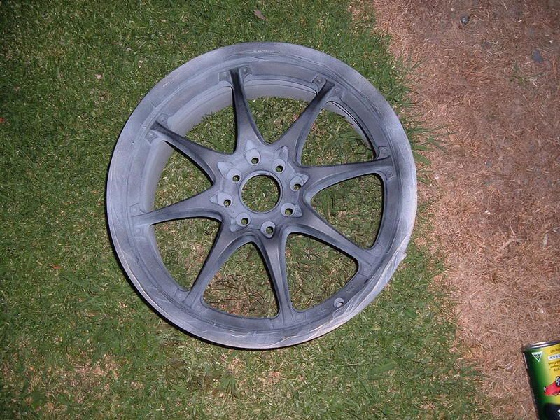

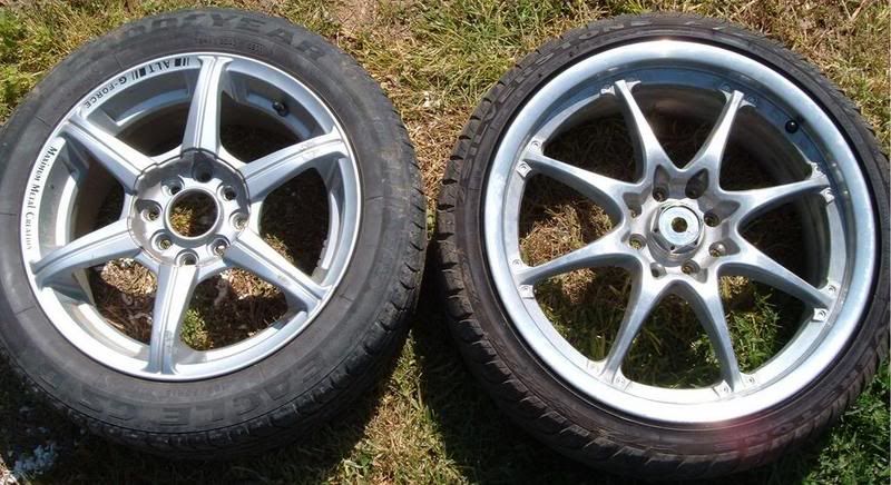

15s along side the 17s i am currently stripping the chrome off and respraying matte black with a polished lip.

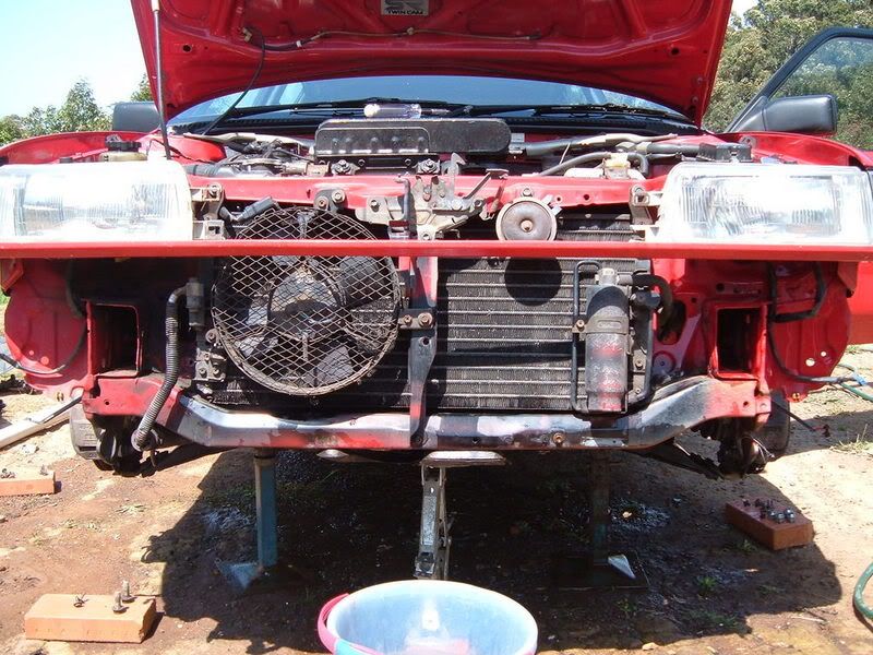

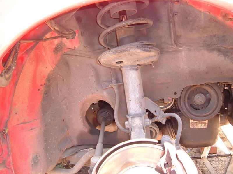

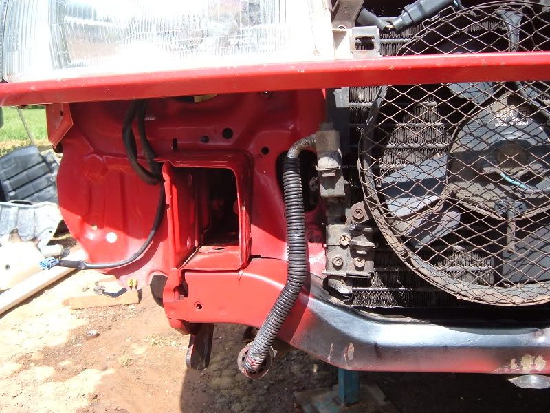

*Stripped front end, pulled front bar apart and cleaned it up.
The oil cooler was left in the front but it isnt connected to the
sump/filter. there was crap everywhere and the cooler was still full of
oil 3 years after the conversion.
gave it a clean up

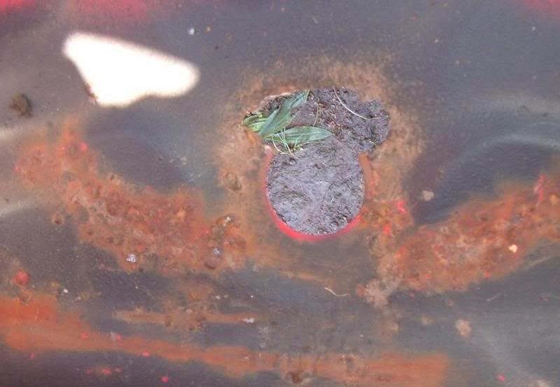

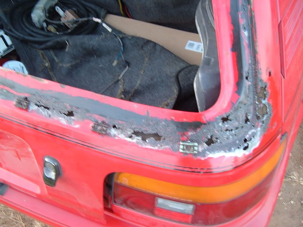

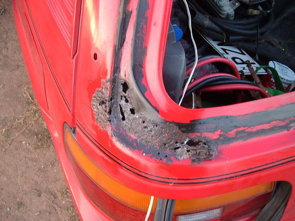

Then stupid me used the butt of a large screwdriver to tap the loose
rust out from under the corners of the rear glass and then.....POP and
then i had no rear glass, all over in under a second, which in a way was
good because i could then see the full extent of the rust and after a
brush up with the wire wheel on the drill this is what the damage is...
so now i need a new boot and i think the easiest thing at the moment is
just settle for a cheap local cs/csi boot with no rust and do whats
neccesary to fit the SX spoiler (might even spray it black before
putting it on)

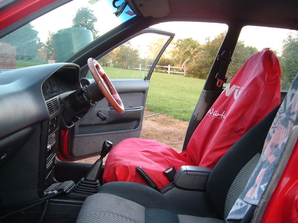

*Stripped passenger seat(drivers to follow) cleaned it up and wrapped up
a wurth red throw over cover (used to protect customers cars when
driven) but they match the paint and the planned colour coding, so they
come up good when put back into the car.

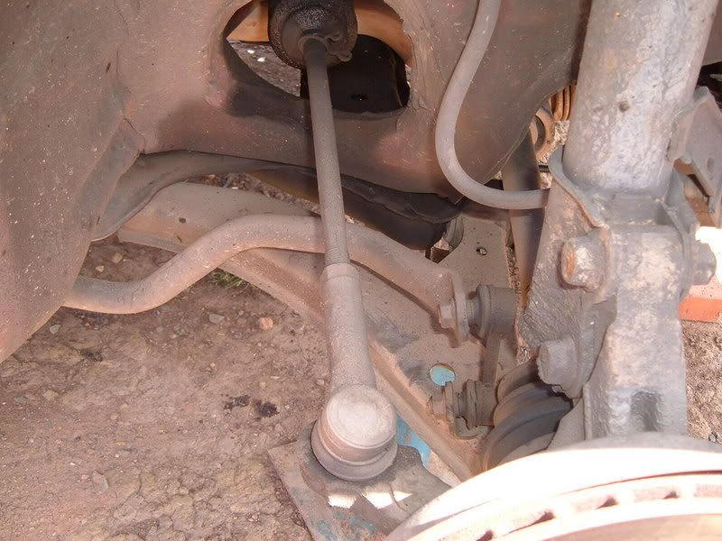

cleaning up the wheel arches, they were full of mud, cob webs and brake
before
after

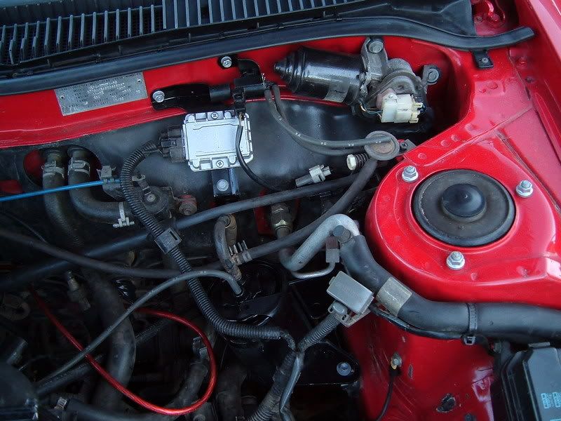

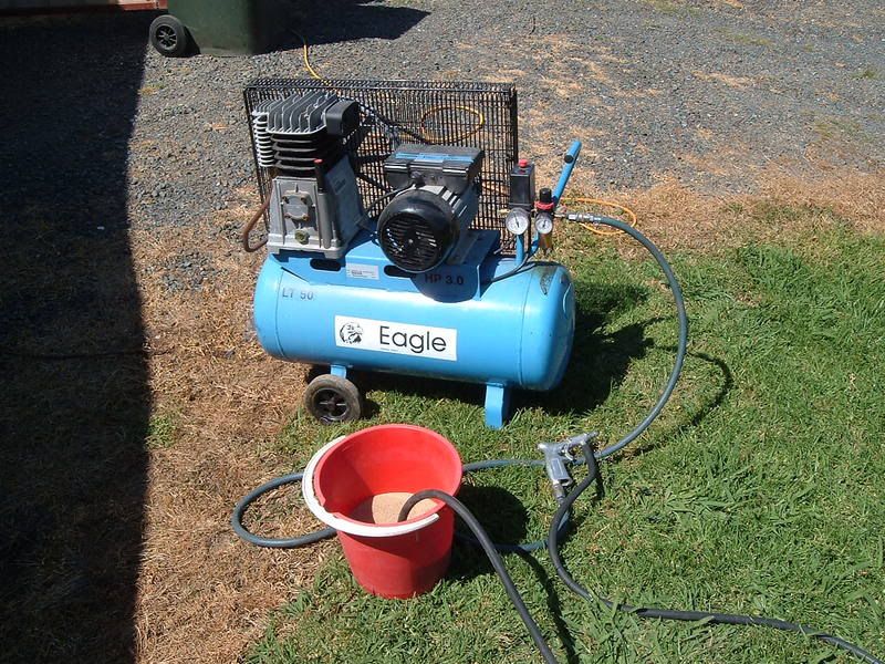

spent 2 days removing, cleaning, sandblasting and painting bits and
pieces from the engine bay including the strut brace, ignitor brackets,
carbon canister and the nuts , bolts and screws that belong to them,
will get better as I do more.

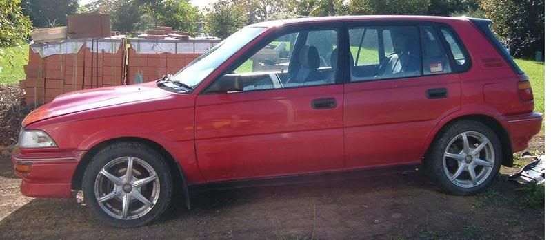

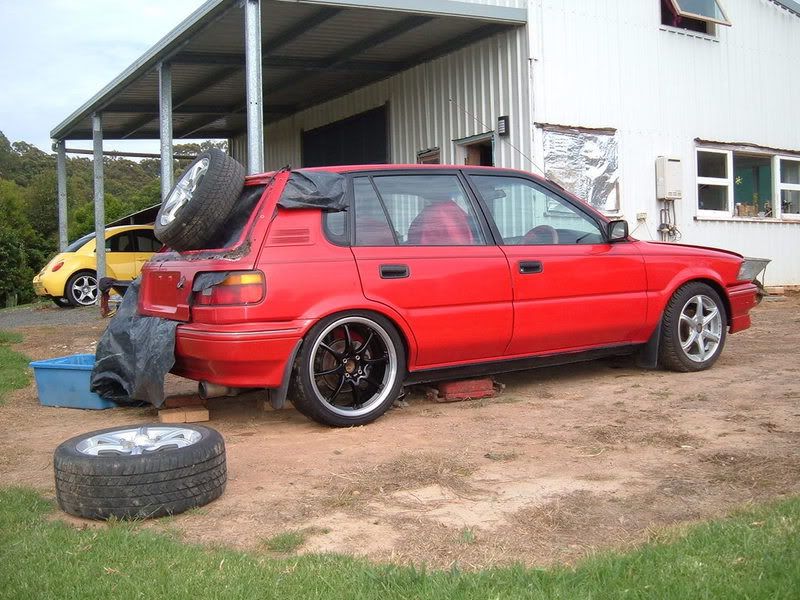

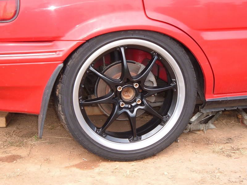

I couldnt fight the urge to test out the superlow stance (actually super
super low in the rear) and maybe its because of the shot struts but the
drivers side rear sits an inch lower that the other side and i'm
surprised that the superlows in the front only dropped it by maybe 2
inches max(considering the extra weight from the gze, but then its only
a C52 g/b)
(sorry about the blurriness but you can see the height drop, but i don't
like the way its lower in the rear)

scored 3 17s off my uncle in-law for nothing, just had to try and find a
forth one, so i rang BSA wheels (i tell you being deaf makes it hard to
understand Chinese people) and they had one left over, which they
insisted was brand new and proceeded to charge me $236 plus $25 freight.
when i get it the next day i noticed that tyres have been mounted to it
because the chrome top coat has flaked off everywhere and the 4/114.4
stud holes were covered in surface rust and same with the mounting face
of the rim. not happy Jan, any way 4 rims for the price of 1 (tyres to
come at cost price hehe)

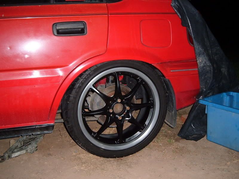

stripping the chrome (looks painful)
painting matte black
fast forward and one is done looks sweet i reckon
the rim on my car before it was painted. (stripped to bare metal_still
looked better than crappy chrome IMO)
and so i get home from town/work at 7 and convince myself i must fit it
up tonight (in not much light) and here it is (btw my wheels are too big
with the current suspension in, theres only an inch of travel before
scraping.
That is all....
Lol been hard at work ay, I have bought all that is need for the suspension overhaul for the sedan, new kyb shocks with new king lows, am getting front and rear whiteline swaybars and strut braces. My front inner guards are looking a little like your before pic, exept it aint grease and brake dust, CV has almost exploded lol.
