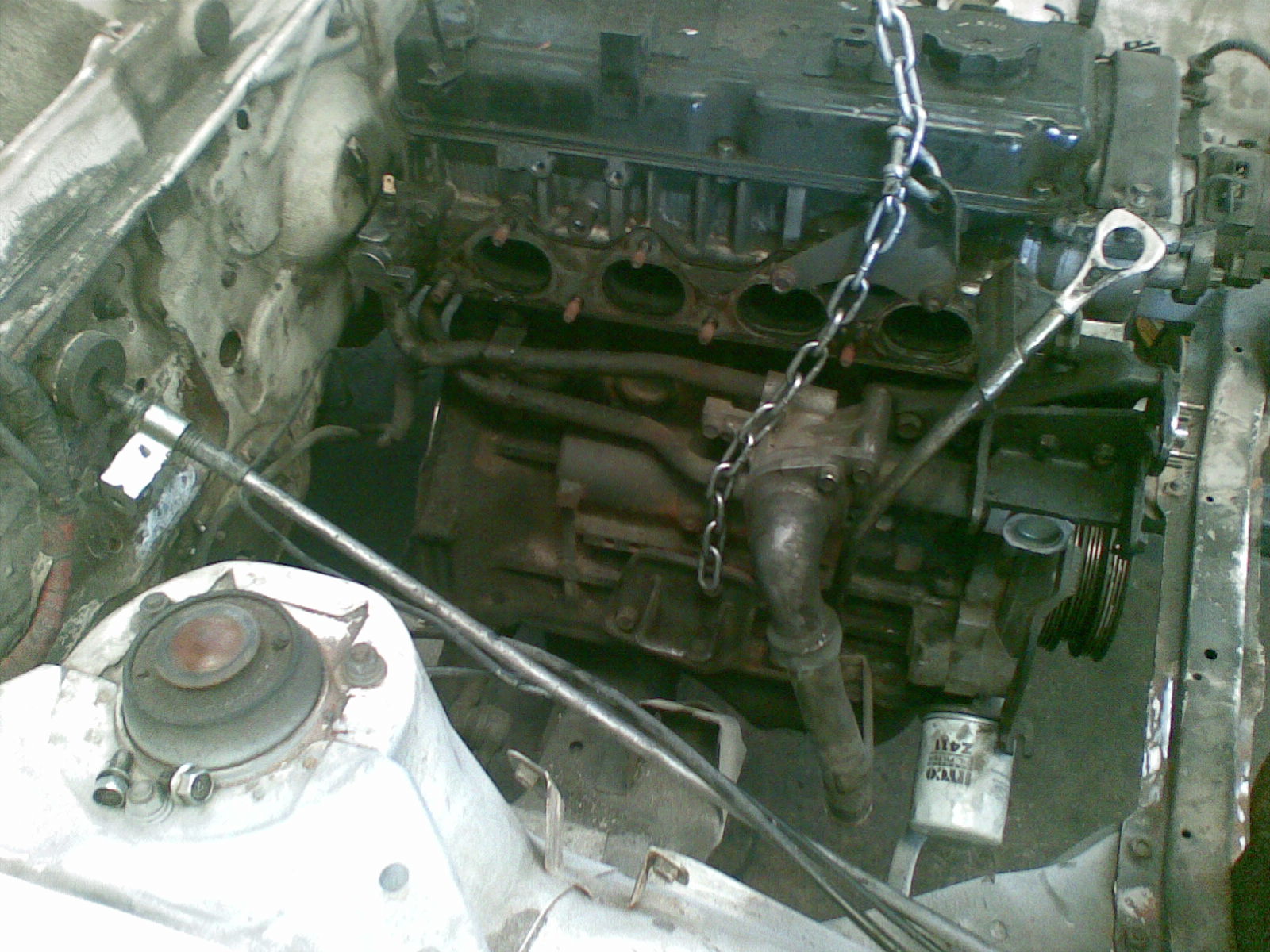

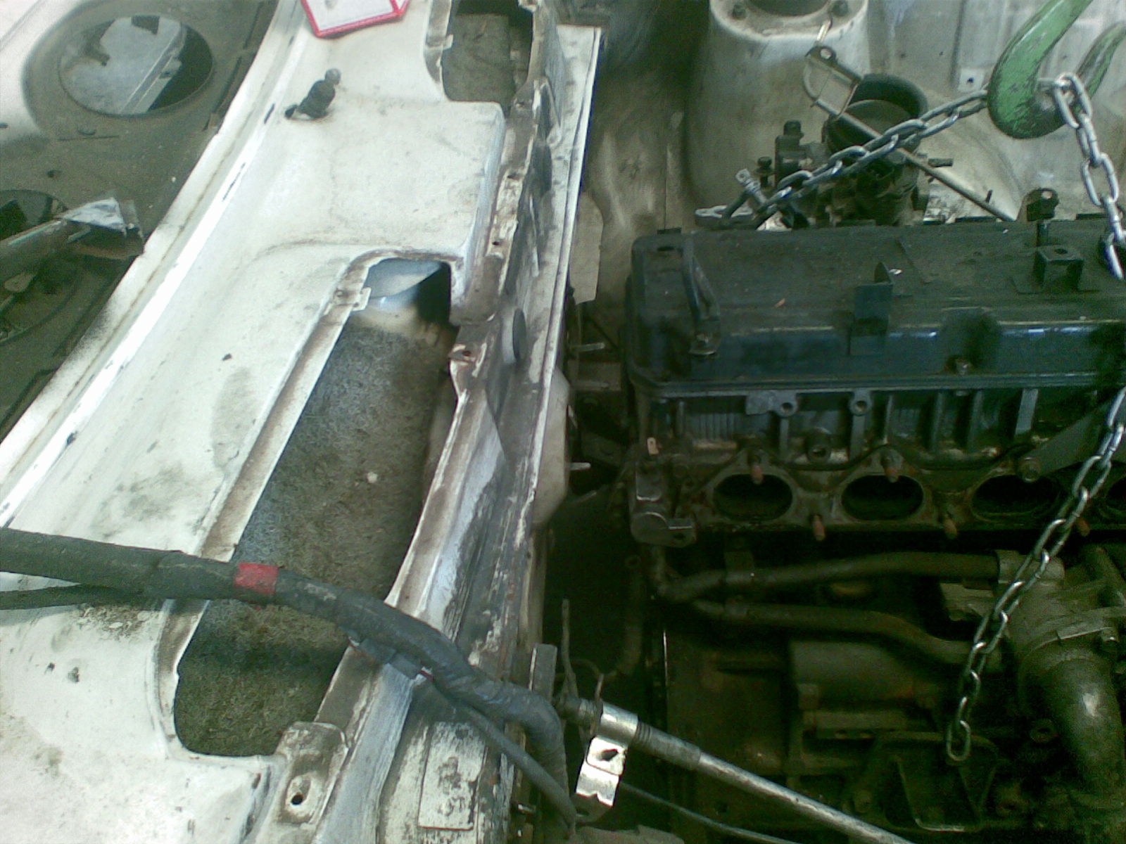

I have a spare 4g64 engine sitting on floor that i sat into my rolla, if i could post a pic i would (don't know how) but the mounts miss out by about 10mm front to back, the engine sit back more. however volvo mounts yes volvo mounts should fix this on the drivers side, and a i think barina mount on the inlet side (had a flick through catalog) there is enough firewall clearance for your cam sensor yay for multi coil!!!
ahh upload button shall try to put pics up, remem a 4g64 is from a triton but so it rwd set up hence the shit off the front and it being a little longer. Oh and you may need to whack the sump with a block of wood as the sway bar is about 5mm to far back, its all clears but basically rests on the sump so i would recomond a small dent or mod
Oh and good new the box from a triton same as all early rwd boxes should should line up with the original cross member and fit the tunnel, assuming i measured my dads ute and my car up right!

Please note that all info above i.e. mount etc are for the 4g64 engine which is a 2.4 litre from a triton, the turbo is bolted to the block on a 4g63t which makes life a little harder. However i have not got my 63t yet so will see yet

Uh i can't remember but it is a very flat one with slightly offset pins i am gonna use the mount brakets off the 4g64 i have and then use the rubber bits from a barina on inlet and volvo on exhaust, havnt looked at this too much yet but looks like it will work. I am in brisbane.
