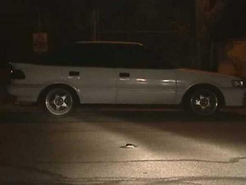

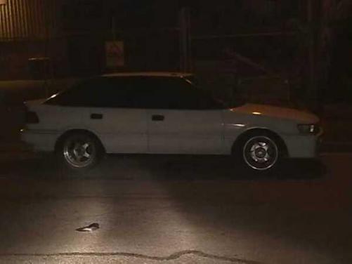

crappy phone shots of the fitment of the rotas
might be also swapping the rota's in the near future, for something english made of a similar size and offset. will just depend on price and shipping.
