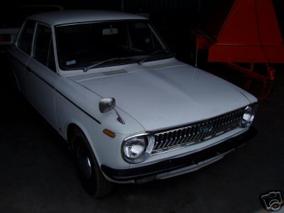

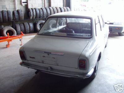

did u buy this off ebay a few weeks ago? i wanted this so bad
