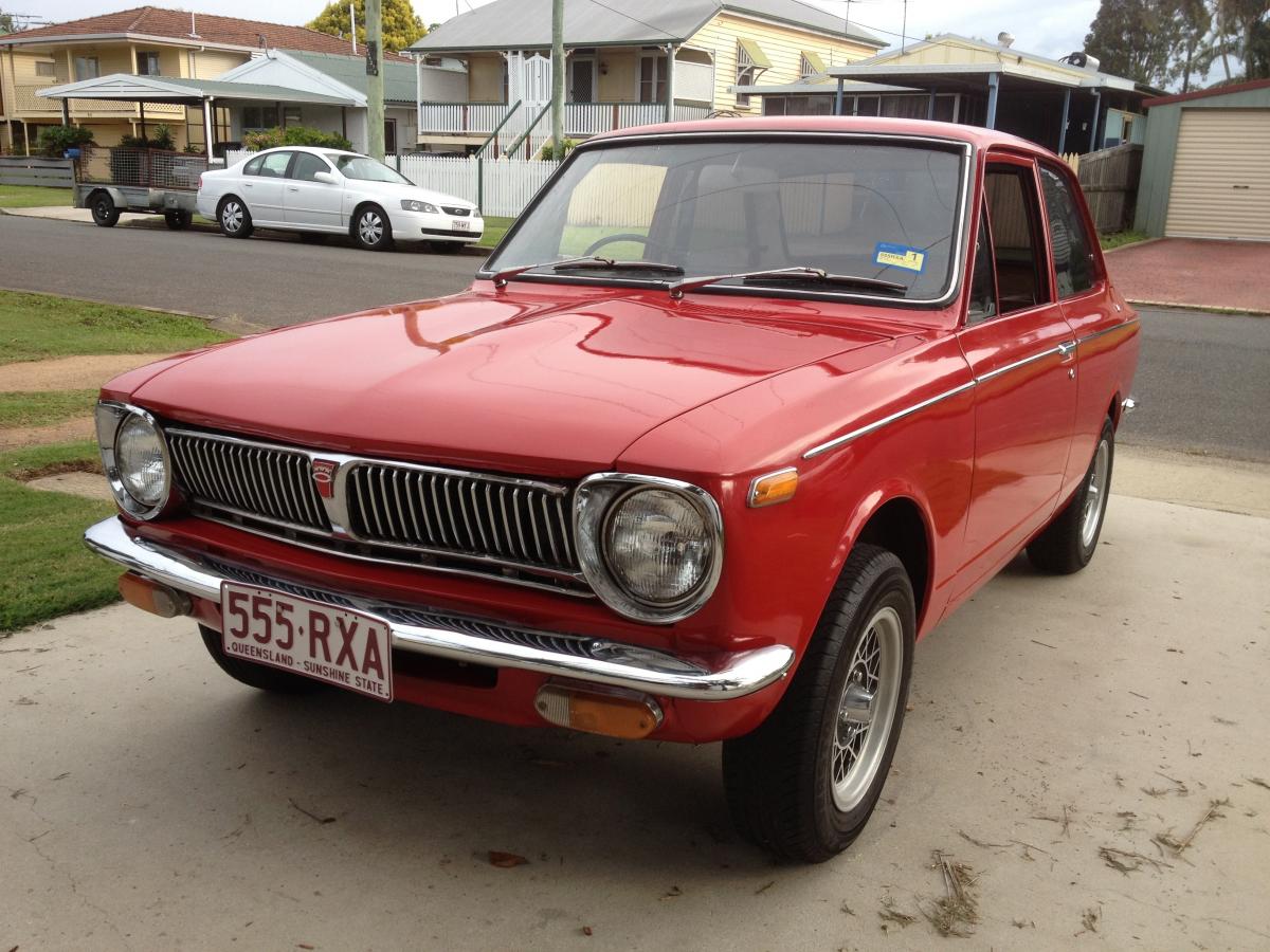

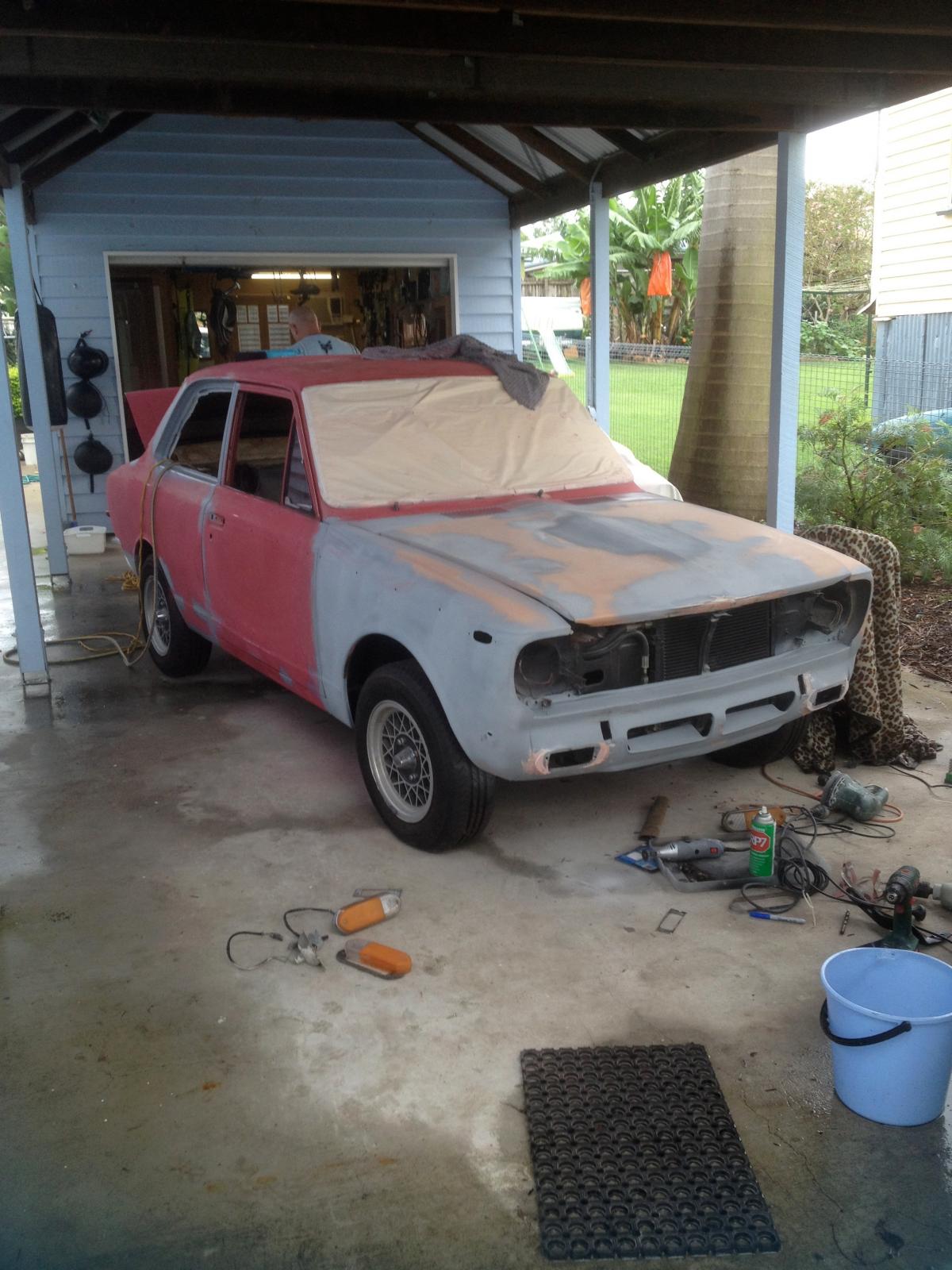

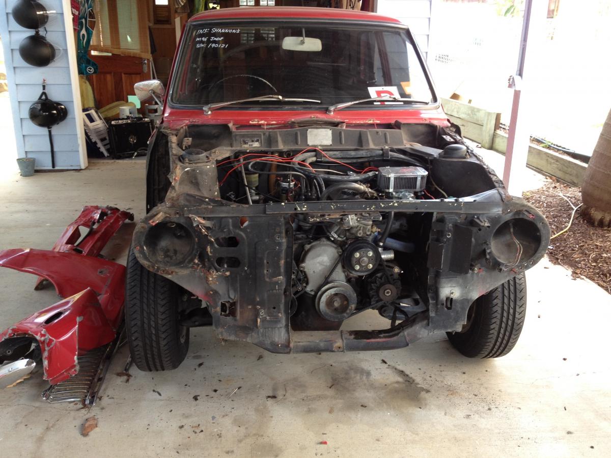

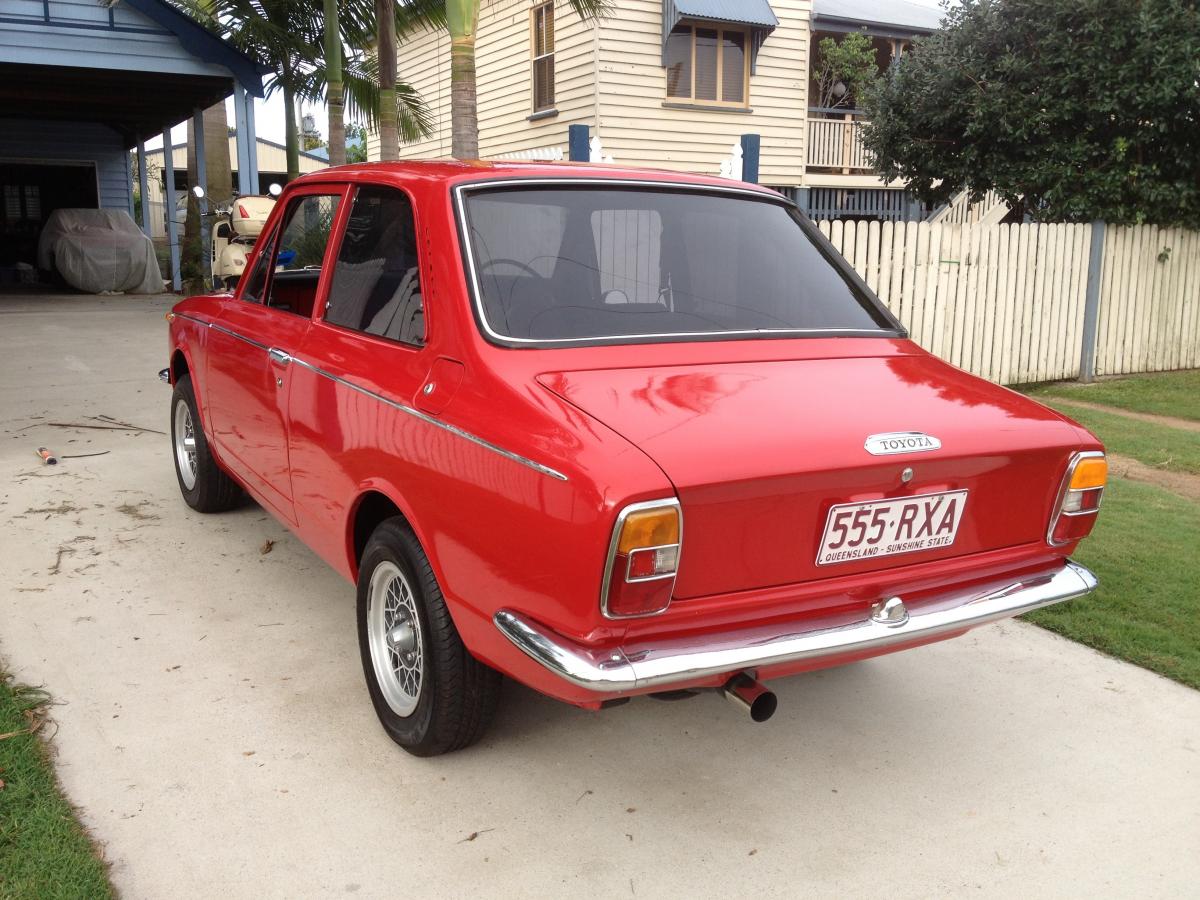

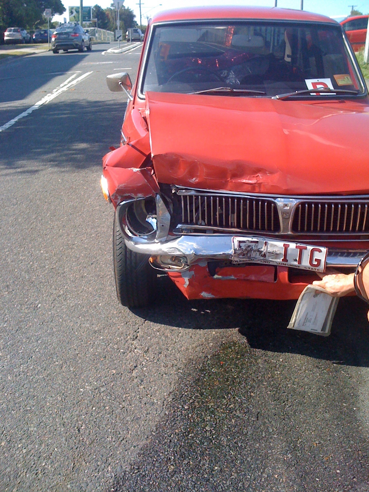

  8. For inspiration Restored in 1999. Kept for kids. Then daughter crashed. I was lucky to find the parts. Thanks Joel. And gave it a go. Frame straightening required. Finished product, better then before.
