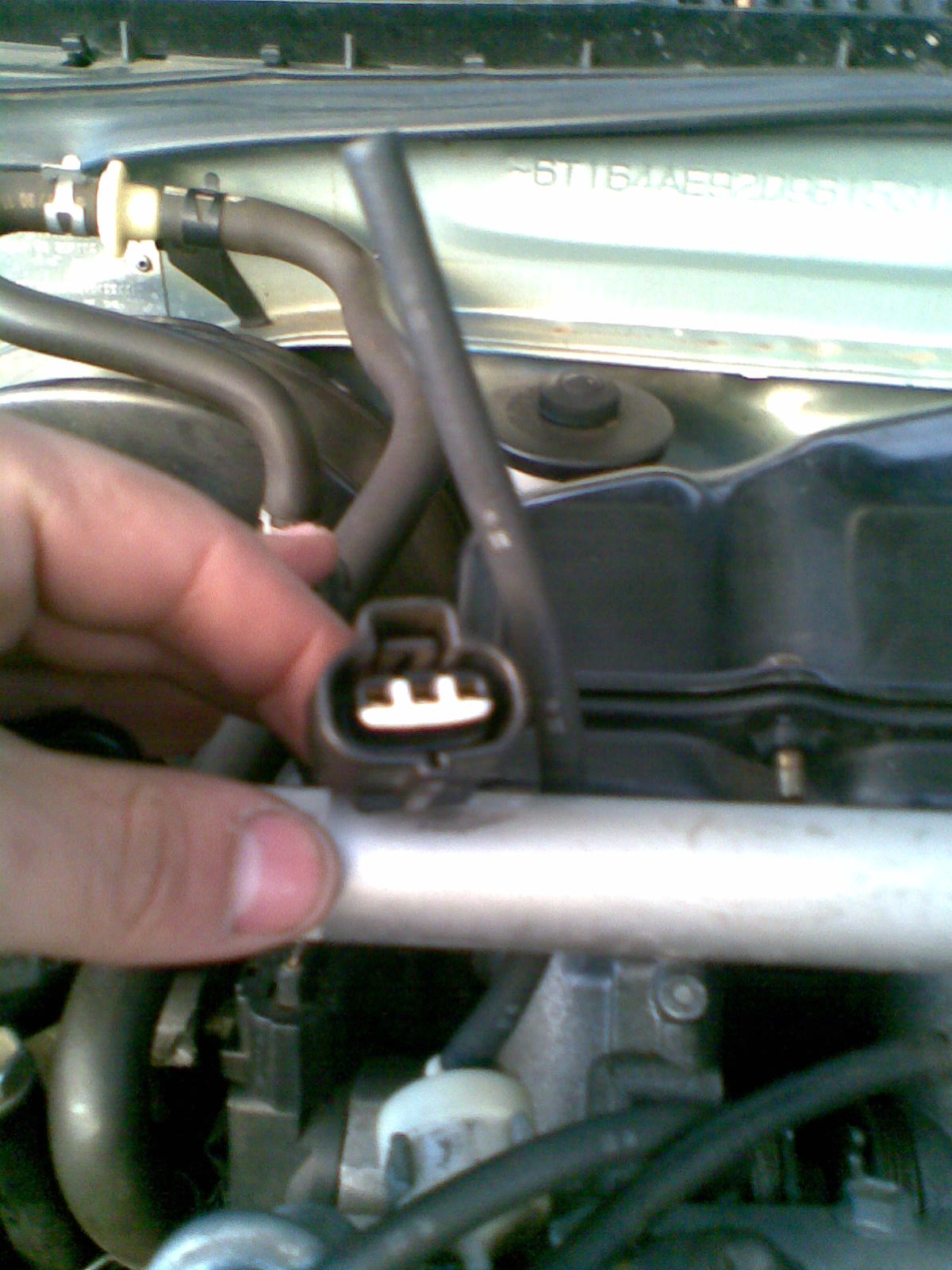

Where exactly are you plugging it in? Any pix?
Possibly you are plugging it in to somewhere where it gets a poor signal. Is your intake standard, as in factory airbox used?

I'm plugging it in to the correct spot.. The vacuum feels a little weak though when i put my fingertip on it. Could this be a problem? There is a small air vacuum one-way valve in there.
My intake is standard and i am using the factory air box
There is also a slightly bigger vacuum hose near the fourth ITB which sucks pretty hard. I find that when i block that off, the idle goes down to a more suitable level. However i am afraid this will cause damage to the engine.. any thoughts?

Heres a photo of the plug and vacuum hose hope it helps:

The big hose at the 4th throttle is supposed to go to the Idle control valve. The icv isnt connected electrically on my car, but i still find it runs poorly, surges and dies if i don't have it at least plumbed in place.
We probly need to know, are you using a standard ecu? Is it fwd, rwd? What have you deleted, and what have you left on it etc.
If you are using a standard ecu you will need to have the idle control valve connected and working for the car to idle properly.
You don't need a one way valve in the line to the map sensor either, if thats what you indicated.
Sounds like you might need to source either an idle control valve or the big hose which connects it to the vaccum array under the quads.
If its plugged in via a valve it won't react to changing vaccum. It'll just max out and probably flood your motor.
