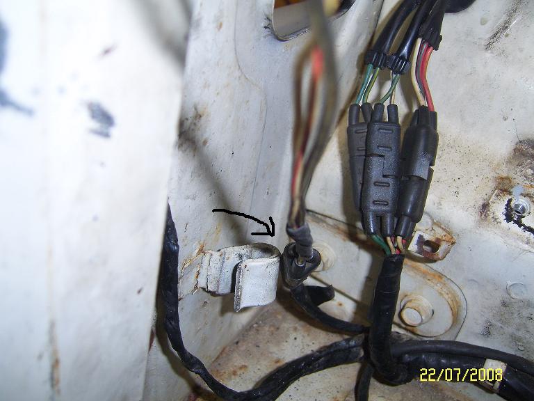

Has anyone changed the alternator in a ke11 from the external to internal regulated type?
There is an extra wire going to the regulator compared to other KE’s (I think) which is for the “Turn Signal Flasher”
I understand that when changing to internal type reg the Charge Warning Light wire runs straight to the alternator but I don’t know where to put the Turn Signal Flasher wire.
Could I just join it to the Charge Warning Light wire and to the alternator?
Turn Signal (Flasher Can) is just picking up Ignition switched 12v..
Easy as piss to change over to an internally regulated unit.
Internally regulated alternators just use the L wire (Lamp) on the D+ terminal on the alternator..

+ve side of your ignition coil, or any other wire inside the cabin that comes live when you turn your ignition switch on..
It is probably Tee'd in somewhere already, I don't think removing the external regulator will effect it..
if you remove the external regulator on the left hand front of the car and strip the wiring back to the right hand side you
end up with only 3 wires into a plug. They are then modified to fit your new alternator one for your dash light (yellow/white)
and one from your accesories to charge the rotor in the alternator (White/red) and the Black/White runs to your starter solenoid
which is left untouched. Hope this helps.

D+ (Dynamo) is where your charge light wire connects to your alternator (All that you need on an internally regulated bosch alternator) helps get the field rotor magnetism going..
Then your B+ charge wire back to the battery..
