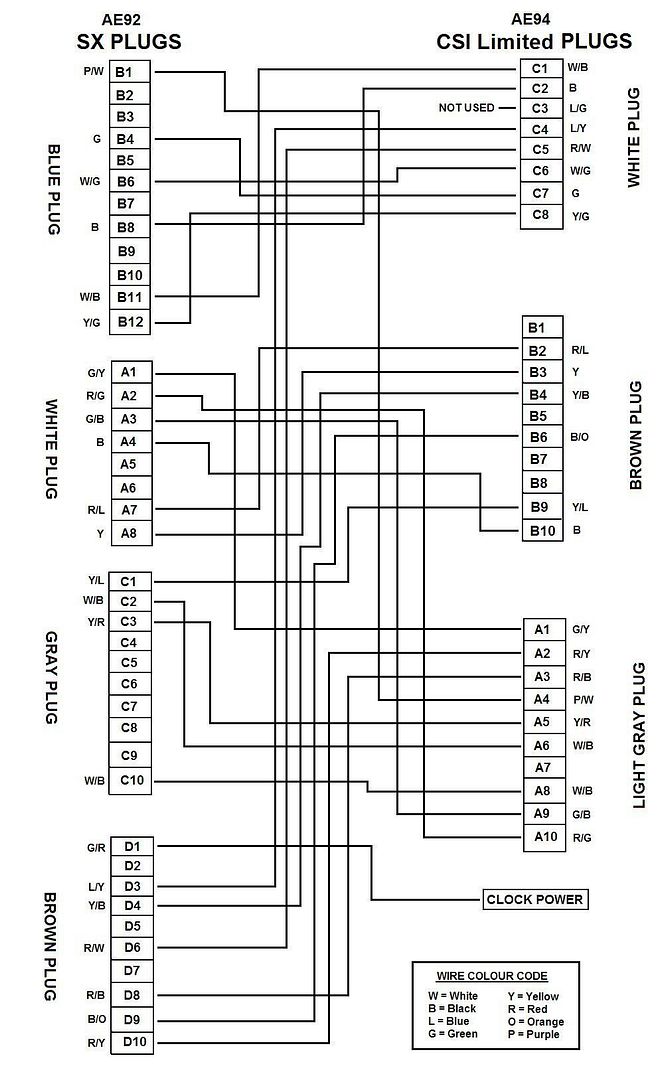

May 17, 200521 yr comment_44327 I currently got a se model rolla which i would like to replace with the sx dash that has the tachometer in-built in the dash. Just wondering if the sx dash cluster would be a simple swap over for my standard one. Thanks for any help. PS. Would any one have a spare or would know where i could get one? Daven. Report
July 13, 200521 yr comment_57596 the sx cluster will fit in any model ae92. they have the same fitting parts. however its a wire job and also a bit of a fiddle with stuff. for example, you will need to change the oil sensor to a guage one...$80 new from toyota. also the clock will need to be wired up to the accesories so obviously it doesnt flatten your battery and it still operates whilst your radio does. no I'm including a diagram here but don't be afraid because i would think that both a csi model and se model would have the same plugs and coloured wires. *i could be wrong tho*. I'm doing this to my cs corolla too. its hard to find one, i tell u that now, and u need all the plugs with it too and some wire long enuf to know wats what coming out of the back Diagram: Report
July 13, 200521 yr comment_57664 hehe. credits go to a mate of mine :) I'm happy to share tho :n: Report
July 15, 200521 yr comment_58043 i think you will find that the clock requires a constant 12v, accessories, illumination and an earth to work as it was intended to. Report
July 15, 200521 yr comment_58190 dave...ask 4AGE-SX on twincam...he did it..seems to work fine for him. he made that diagram! ^^ Report
July 16, 200521 yr comment_58340 ok man. i wouldve thought that that wouldve been handled through the plugs...i mean your wiring to the plug and then those wires from that handles it if you know what I'm getting at. Report
July 17, 200521 yr comment_58461 no idea what your getting at... all i know is the clock needs a constant 12v to hold memory,a acc wire to turn it on, an illumination wire to dim at night and of course an earth for it to work properly... Report

August 9, 200521 yr Author comment_63263 how about the one that doesn't have the extra gauges in the centre console? The exact same as my dash, tho the fuel and temp replaces the door light and toyota logo while the speedo remains where it is and the tacho next to it. Is this not an sx cluster? The one you have there is a Csi limited model one also appears in secas. I'l post a pic if i can find one of what the cluster looks like. Other than that, thanks for your help and the diagram insalubrity_macca. :jamie: Report
August 9, 200521 yr comment_63323 oh and just for the record... *MOD* i have a word document with heaps of info and pics in it about this as well. (how can i upload it?) mate the cluster ur refferring to is the same as mine. It has from left to right 4 guages. Fuel, Speedo, Tacho and Temp. SX CLUSTER: (u can't see all the guages...def is sx tho coz speedo goes higher to 200 and theres the battery guage instead of the light and the tacho goes to 9,000rpm etc etc etc) And ur old one is an SE model which has...from left to right...the toyota logo, speedo, fuel and temp and then door open ...right? And you want to swap ur SE cluster for a CS one? or CSI? (which are the same) Edited August 9, 200521 yr by insalubrity_macca Report
