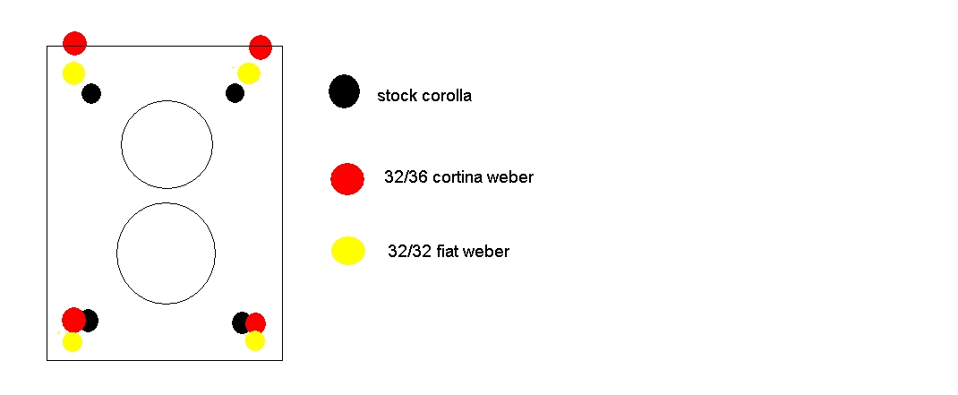

Just found a pic I did for somebody else to try and explain the bolt spacings.
You can see how close the fiat/alfa weber is to fitting on the stock rolla manifold....
Have fun! :)
