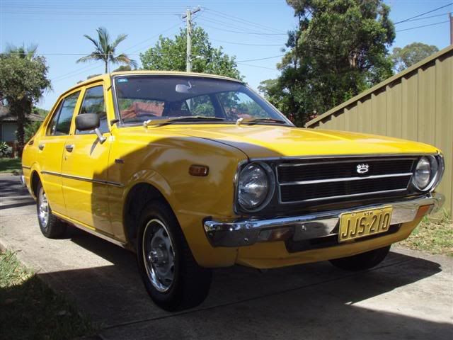

Heres a piccy for a looky of Lola and for brag sakes :P

lovely looking car I might add.. look after that one carefully!

Nice rolla man that thing is fkn overrated! :P
