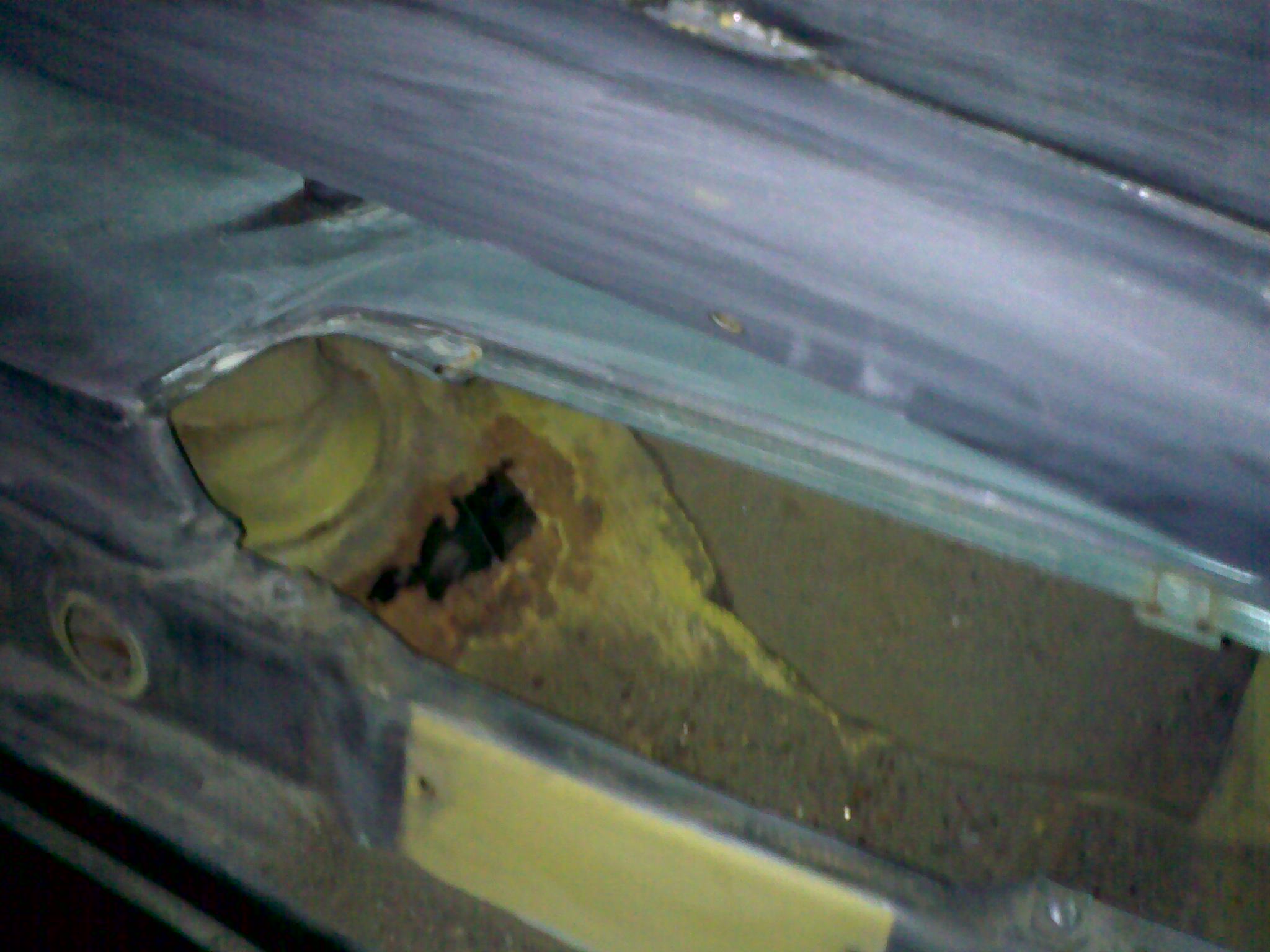

Hi Guys,
While I was working on the car last nite I found some ugly spots of rust above the fire wall near the air vents behind the bonnet. :lolcry:
I'm looking to weld them up tomorrow but unsure where to buy some steel plate offcuts and what kind of metal plates to use.
I looking to cut out the cancer and I'll be using my Mig welder to install new plates.
What sort of metal sheets are best to use?
