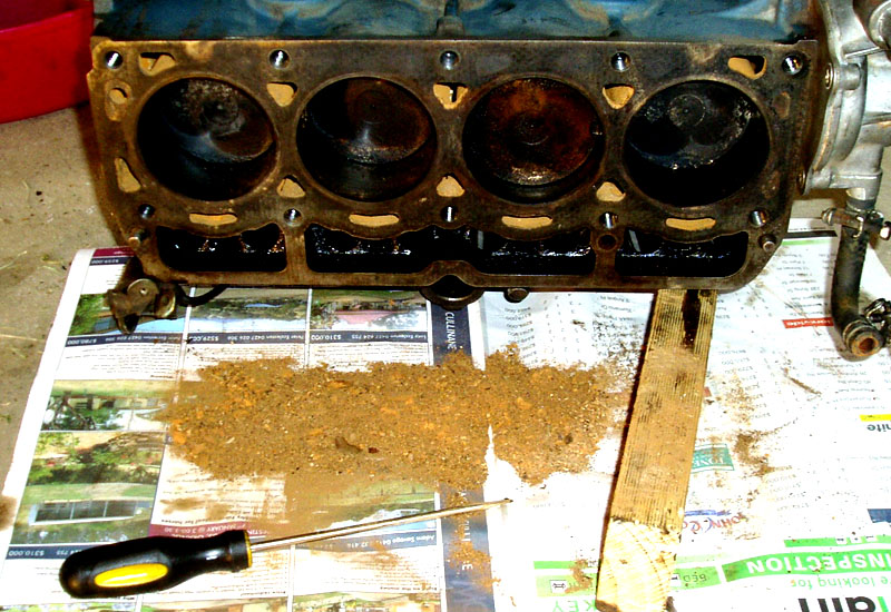

Then I tipped the block upside down on two bits of wood and banged it up and down a few times. Unfortunately I vacuumed up the rusty mess that came out, then I started in the coolant holes with a small torch and a screwdriver. Just scraping that around in all directions in each hole produced the extra pile of rust and stuff pictured. Most of it was on the bottom of the waterway at the rear cylinders, but quite a lot had bridged between cylinders or between a cylinder and the block. That all acts as an insulator that keeps the heat in and slows down the flow.

jesus! looks like the previous owner didnt know what coolant was :dance:
surely when you get a head skimmed they pressure test it to make sure its usable, and also hot dip it? i know my head came back as clean as a whistle :dance:
ah, miss read :D
either way, i think id rather strip block and send that and head in to get cleaned properly.
