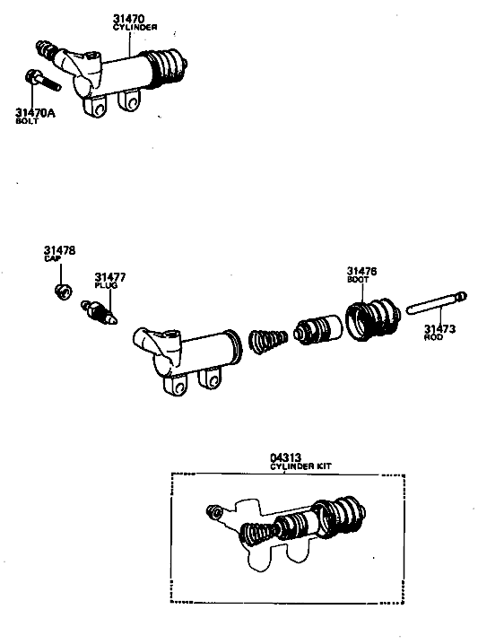

LittleRedSpirit Posted January 20, 2010 Report Posted January 20, 2010 hey guys I'm posting up once again because i have made another thing wrong with my conversion ha ha, i have lost the bit that goes from the slave cylinder to the clutch fork does anyone one have one lying around or know where i could get one and if anyone has a picture of one because i don't even know what it looks like I'm lost. Quote
Redwarf Posted January 20, 2010 Report Posted January 20, 2010 You can make a new one out of a bolt the correct diameter. You just need someone to tell you what length it is. Quote
Chief Posted January 20, 2010 Author Report Posted January 20, 2010 hey guys thanks for the quick reply's spirit is that a part number over the rod? but yea if anyone has the size or somthing for it that would be awsume thanks for the help. Quote
toyota_ae71 Posted January 20, 2010 Report Posted January 20, 2010 Same thing happened to me, I had a spare meter or so of threaded 10mm rod. I then measured from the inside of the slave cylinder to the clutch fork and cut the threaded rod to length, but it still wasn't quite right. Ended up making about 3 of them until it felt right to me. Cheers. Quote

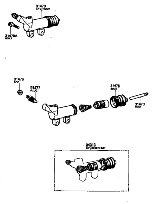

LittleRedSpirit Posted January 20, 2010 Report Posted January 20, 2010 31473-20031 Its the same for adm or jdm t50. Quote
LittleRedSpirit Posted January 20, 2010 Report Posted January 20, 2010 31473-20031 Its the same for adm or jdm t50. Its 65mm long and about 8.5mm thick. Its rounded off on either end. Theres probably a few cars with similar ones. What stops it falling out is the groove that allows the boot to hold it near the exposed end. Quote
