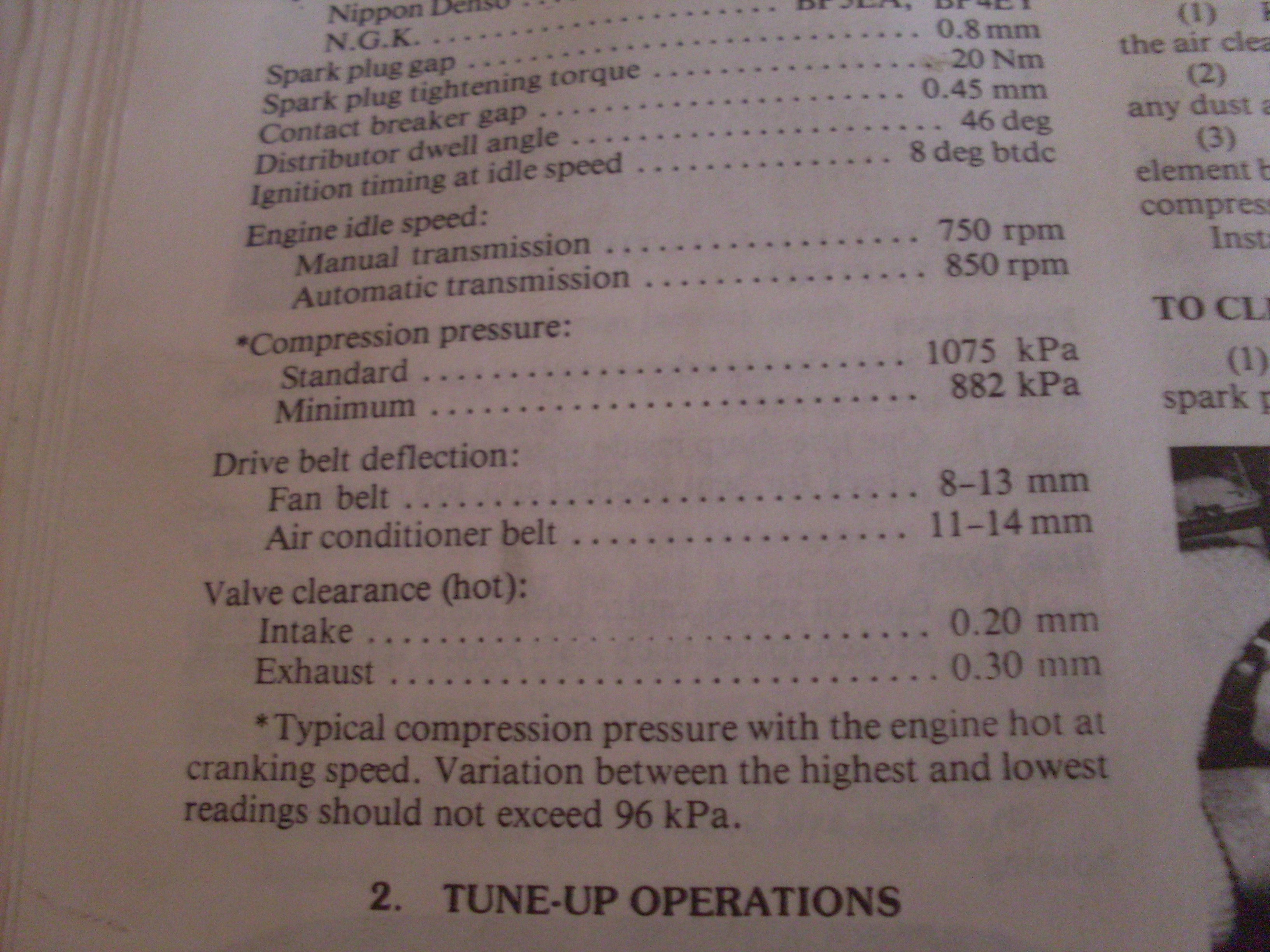

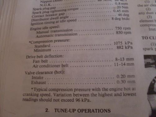

in my manual it says valve clearance (hot) :
Intake : 0.20mm
Exhaust : 0.30mm
this is from my 82 e7 manual.
