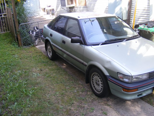

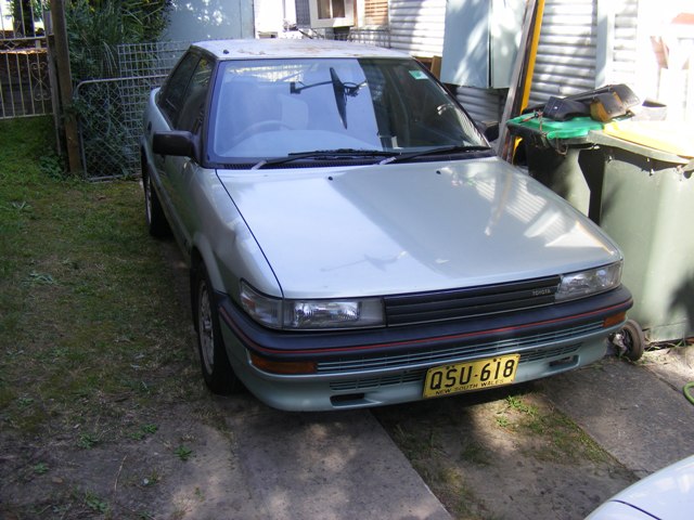

Soooooo an early birthday present from the wife got me this gem

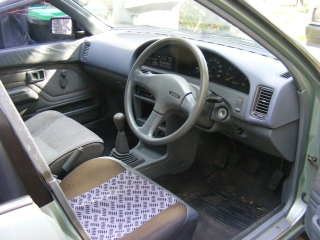

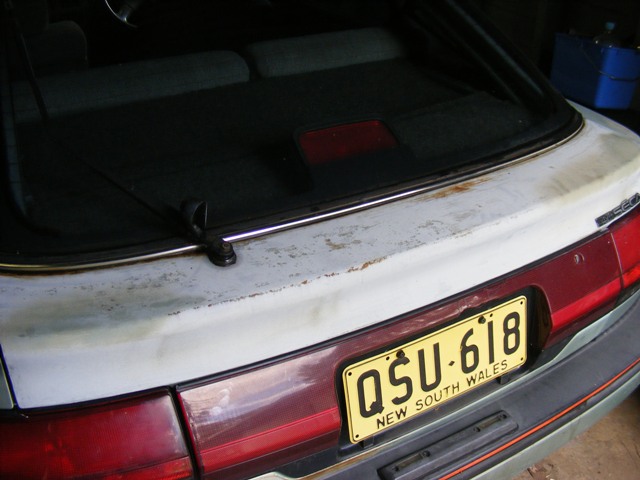

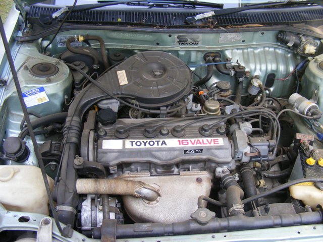

Needs some paint work mainly on the roof & bootlid interior is pretty damn good (tacho dash FTW) but it runs and drives like i just picked it up from the dealership
Not a powerhouse (4af woohoo) but its not too bad up in the rev range and very responsive

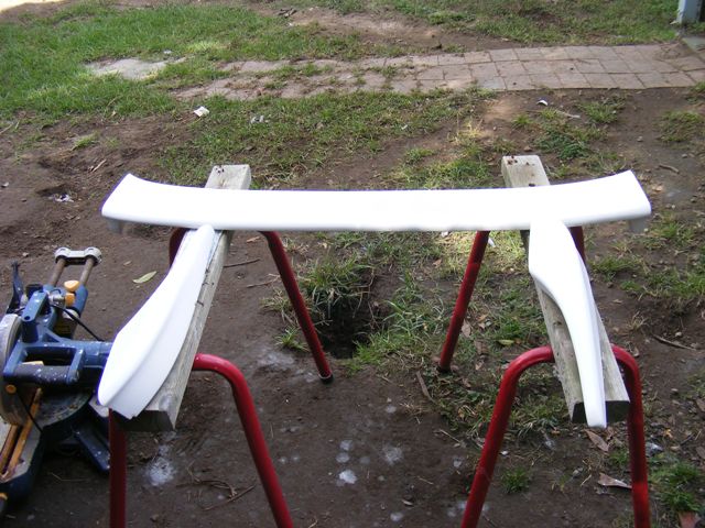

respray & fit rear wing from ebay (factory version not ricer special)

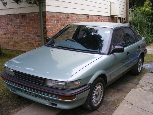

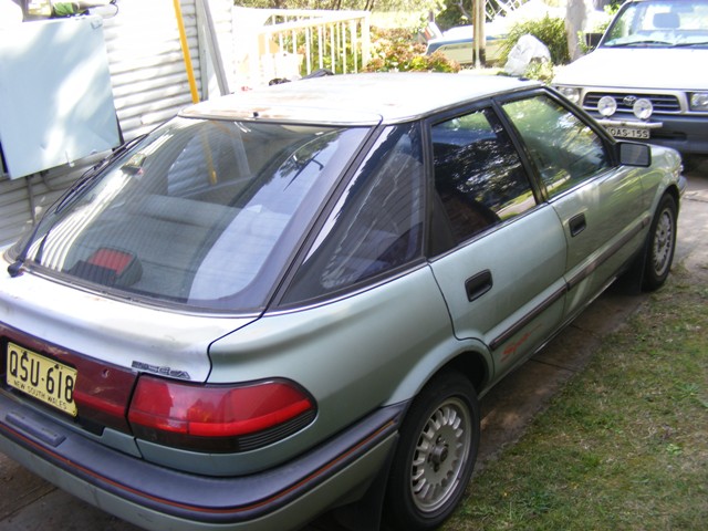

Anyway enough chatter, a few pics

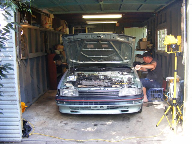

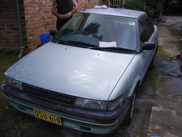

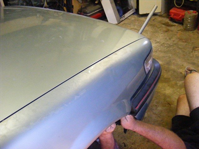

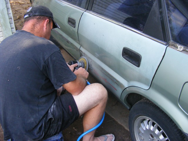

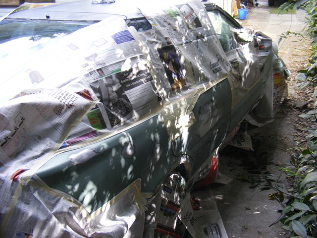

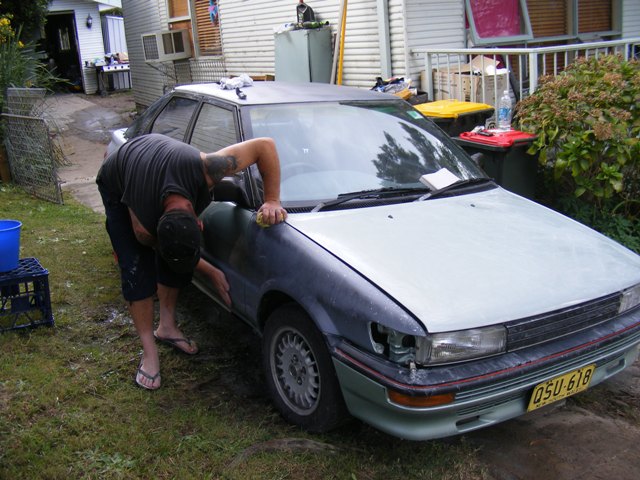

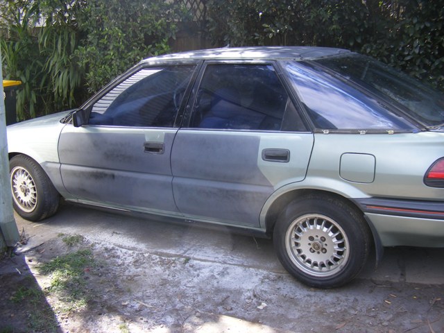

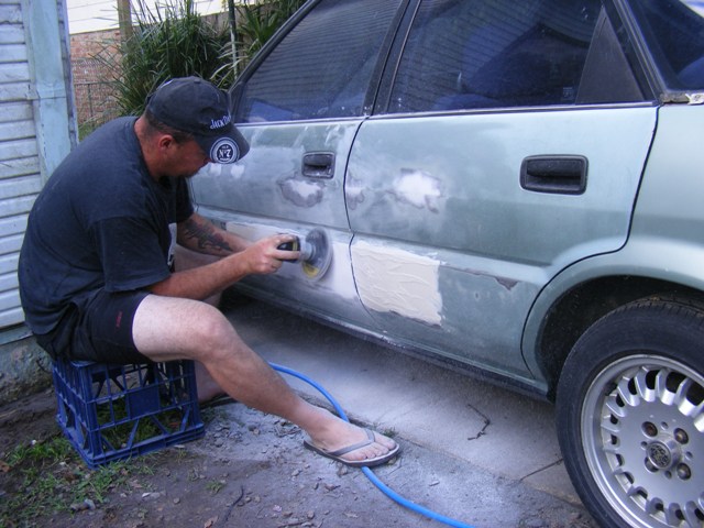

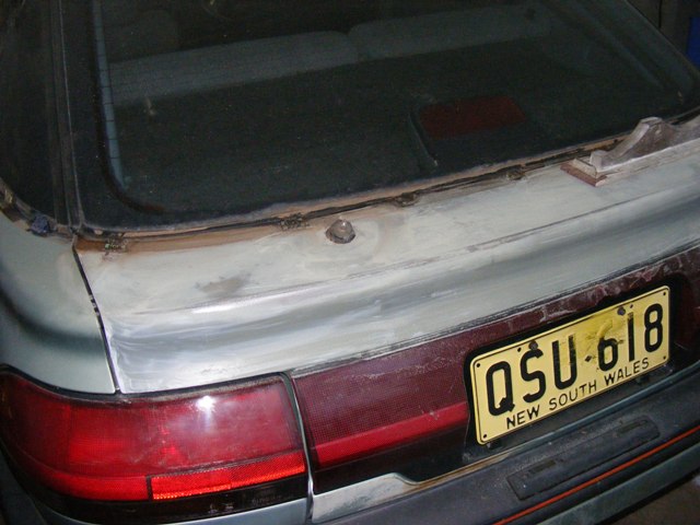

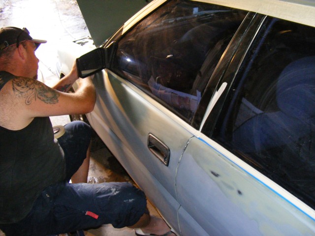

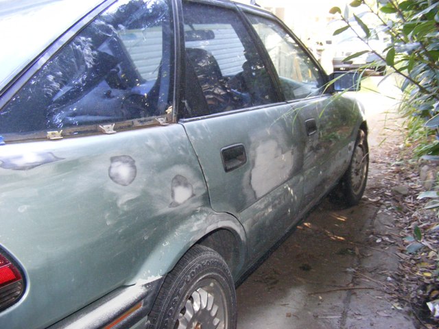

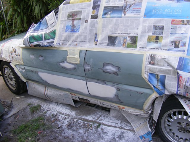

Well we had a pretty good day considering.

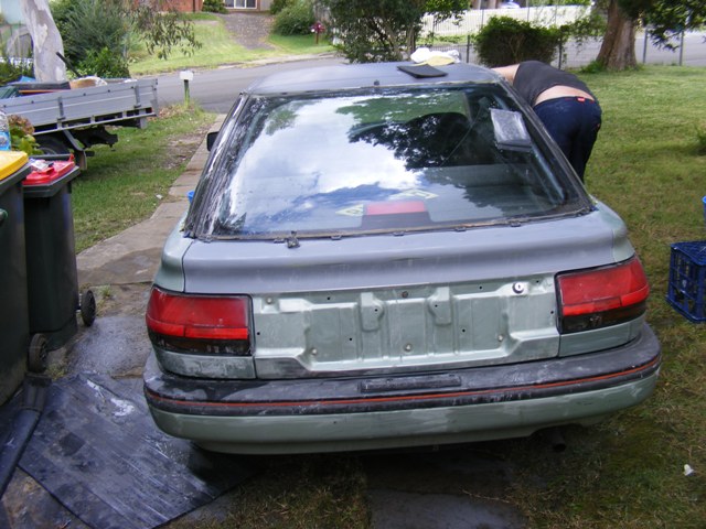

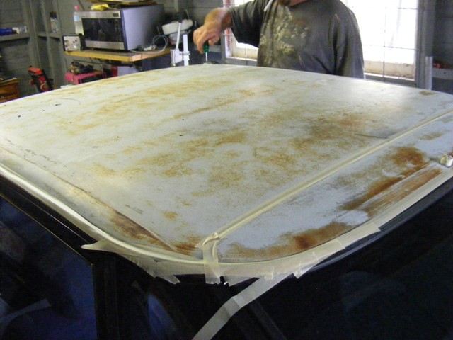

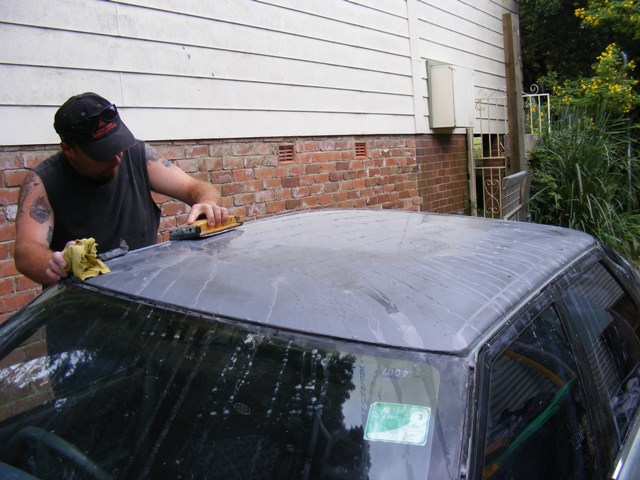

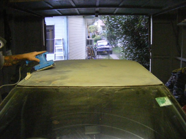

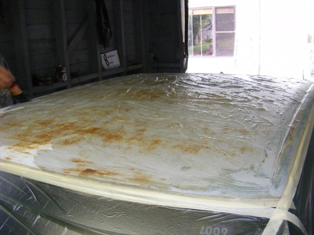

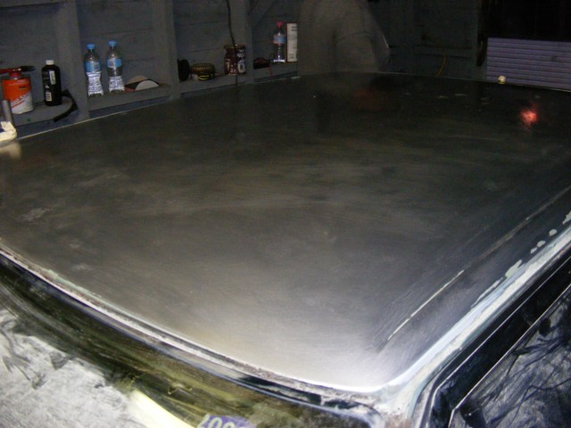

Went and picked up paint and a whole lot of other gear and then got to work masking up to strip the roof & boot

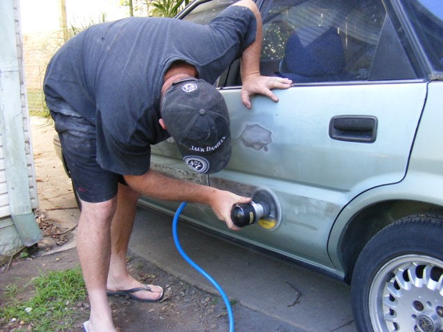

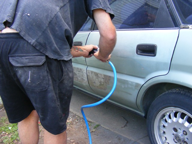

Paint stripper was being a bicth it took 3 coats and still didnt penetrate all the way so we got the sander out to finish off
polled most of the mouldings off and found 20 years worth of crud
After that we applied wax n grease remover and put rust converter on the roof
Roof is Back to bare metal and it looks awesome
And we decided the roof is going to look so good we are going to respray the whole car this weekend
The majority will be just rubbed & scuffed up a bit and then full 2-pack respray yo
Anyway here is a few photos of progress today with more to follow tomorrow

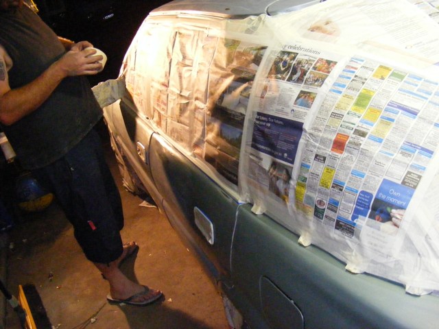

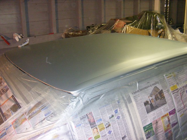

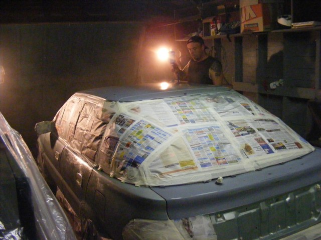

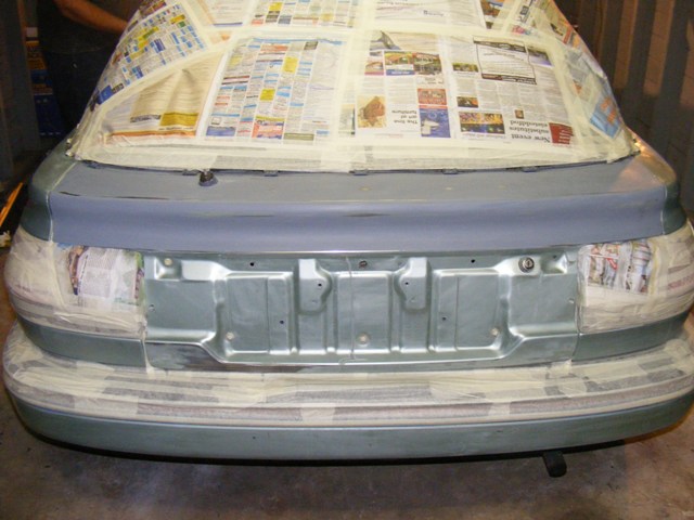

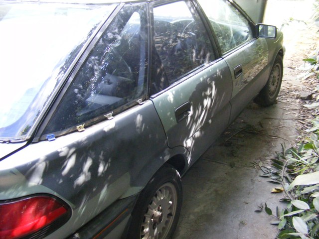

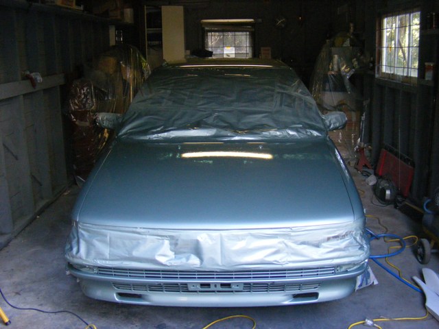

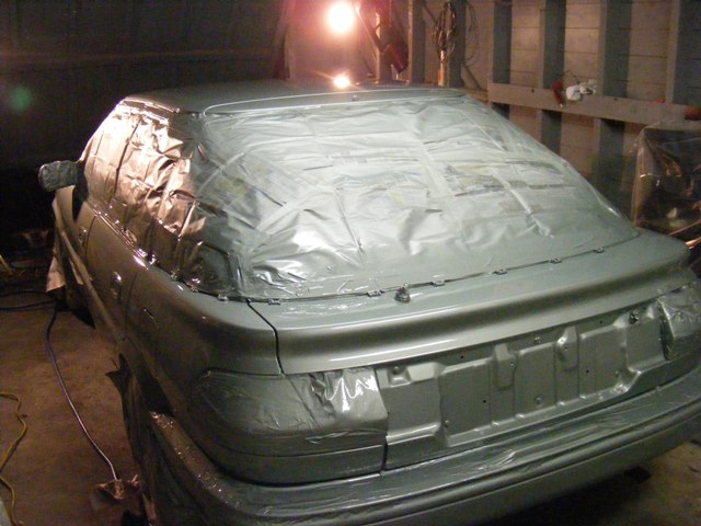

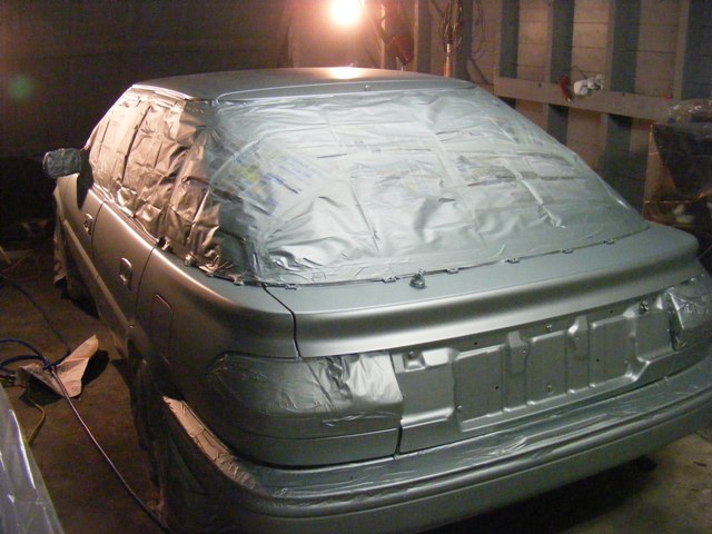

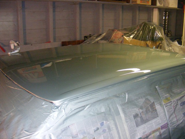

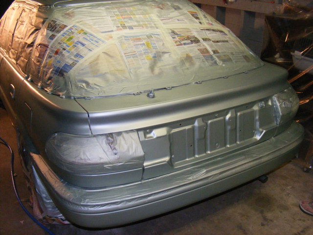

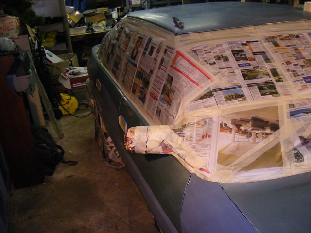

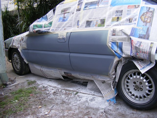

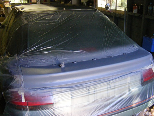

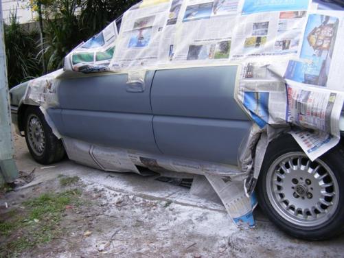

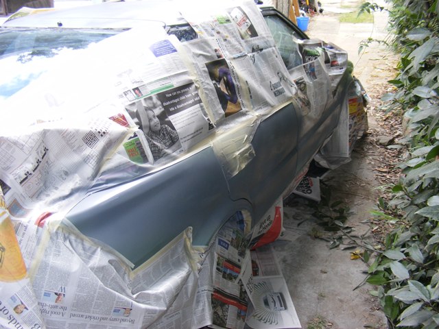

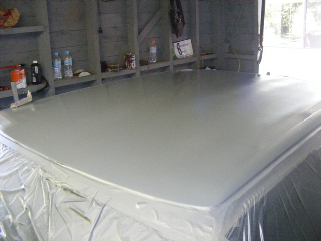

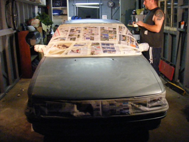

Well we had an extremly productive day yesterday, got the whole car wet rubbed back then spent a good three hours masking up and decided we'll just spray it now so up in the garage till 10;30pm and we got 5 coats of colour and 3 coats of clear
I have to say it looks pretty damn good for a backyerd job. I can't take much credit though as it was my mate Graham who did 90% of the work
I will take some more photos once we strip off the tape and put all the bits and pieces back on
We still have to spray the wing on monday (which is in the first pic) and i will also respray the wiper arms and window frames black as i'm sure they are going to look pretty dull with the paint looking so new

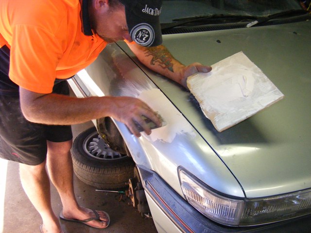

I can't take too much credit, the guy in all the photos is my mate Graham he was a panelbeater for 10 years

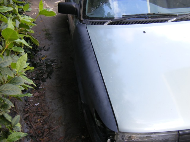

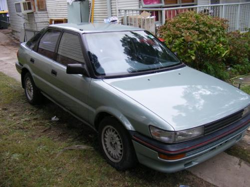

A few more photos unmasked and with mouldings lights etc back on
Still need to spray & fit the wing and respray wiper arms and door window frames
