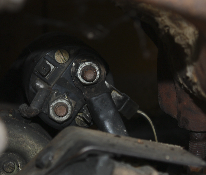

postive of the battery goes straight to the starter motor,
now there should be thin another wire on starter motor aswell this gives the signal to start check if it has one/or if its connected
yeah pos to starter, and the Smaller wire is there plugged were it was yesterday. can get a pic to make sure its plugged in right spot? ill upload in a sec.
I earthed the starter out, and its deff getting power there and spins, But the Solenoid doesn't throw out.

i think you have it on the wrong terminal, put it on the top left one
to test it put a screwdriver across the top left terminal and battery wire.
also I'm 70% sure the solenoid has to throw the fork out before the motor spins

Ive tried it on all three, Nothing.. I will try the screw driver though see if it clicks itself, Might be Screwed?

can you hear the solenoid beening thrown out? as i said I'm 70% sure the solenoid has to throw the fork out before the motor spins.
it could be the starter motor is gone or some teeth missing off the ring gear on the flywheel.
if the starter motor is throwing the fork out and spinning but doesnt turn it over, try turning the engine over by hand a little bit then try agian
if it starts it means theres some teeth missing
when you first got it did it use to start?
Ok Got it Going.
I used a screw driver on the pos cable and the small wire i have it plugged to, and it wound over straight away... So my guess is there is a problem with wiring in the loom or up near the key for the solenoid.

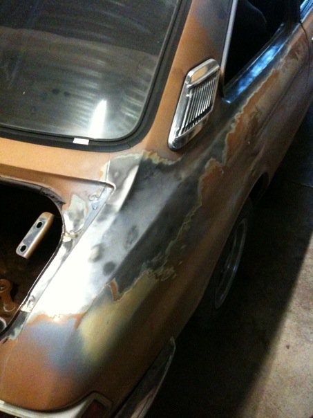

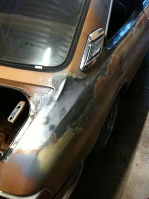

So this arvo after work i thought i would try the wire brush on some parts i suspected had rust under the paint.. turns out there is a lot more rust Growing in spots you wouldn't tell.
So new plans again,
Buying Gravity feed Gun tomorrow, And Filler primer.
Will be Wire brushing Almost every part of the car, And rusting Proofing and Cutting out what i find.. And Primer it this weekend i hope. Engine Coming out tomorrow, and thinking about seam welding The bay to make it look neat? Or could i use Bog in the engine bay? Strut towers and all? Smooth it right out ????
Then Flip it on its side, for wire brushing, new bushes and all. Then Sound and Rust deadening.
This has gone from something i wanted done Quick to something that will take me long over 6 months, I'm a apprentice so I'm trying my best.
Any one know were i can Buy Brand new Window Rubbers? Mine are cracked and falling apart... Something i WILL need.
Will update with pics later.
Paint stripper? Or should i wire Brush the whole lot. Its coming off Fine and Quick, leaving the surface smooth...
Motor and Box coming out this arvo, have a Few mates Coming round to Give me a lift.. I don't have a engine Crane..
Will upload pic tonight :D

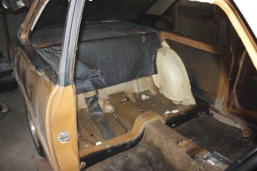

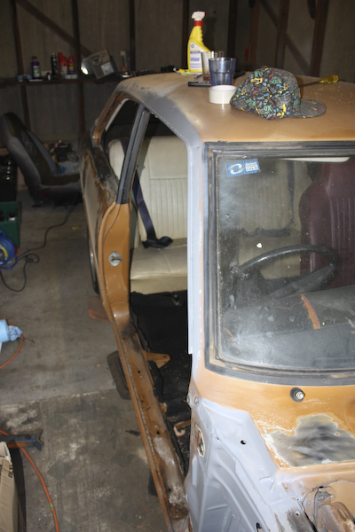

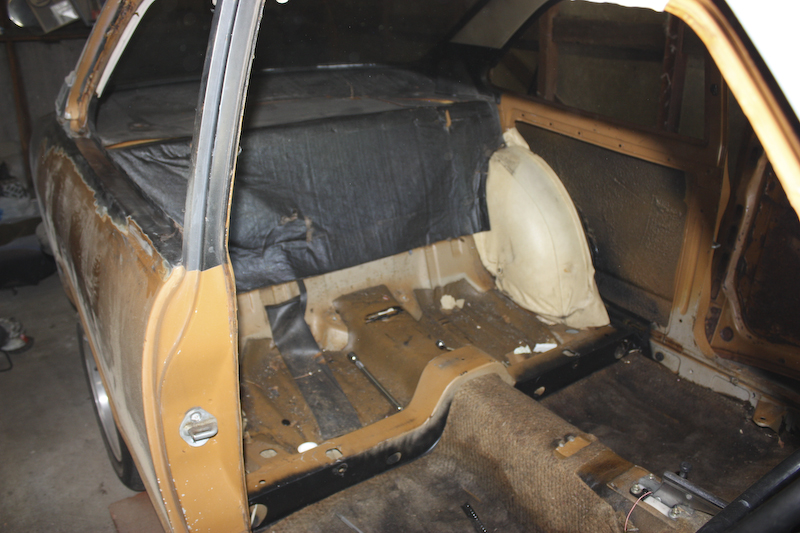

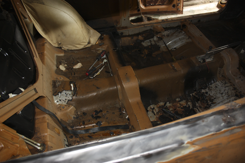

So i thought i would have a break. And upload some pics.

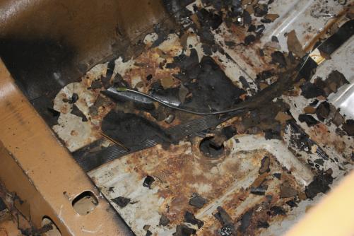

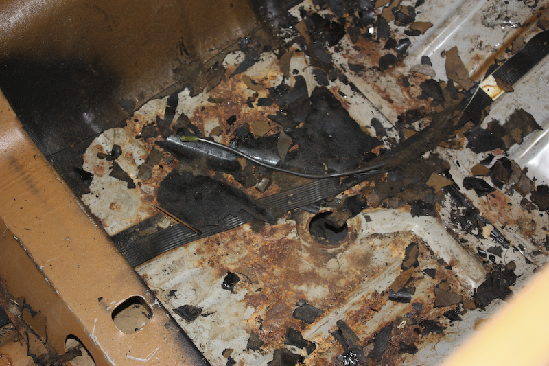

This sound deaden-er is a pain to remove... Any tips? I'm Currently using, Old flat head screw driver, And a Chisel.
mainly surface rust i have Found sooo Far. Only seen a Small section.

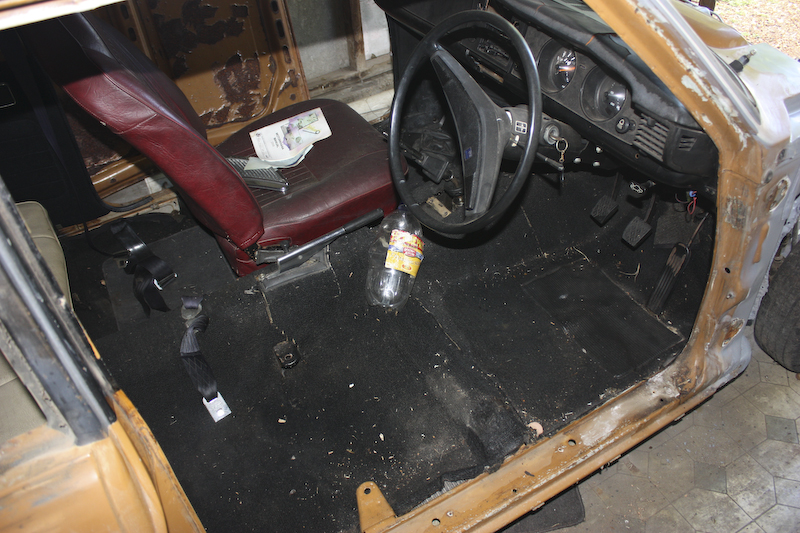

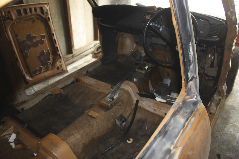

Doors Off.

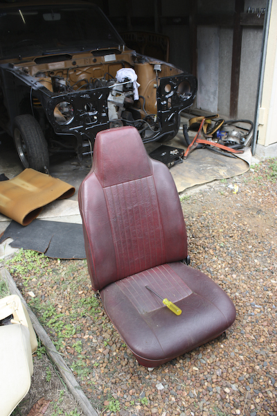

driver seat out.

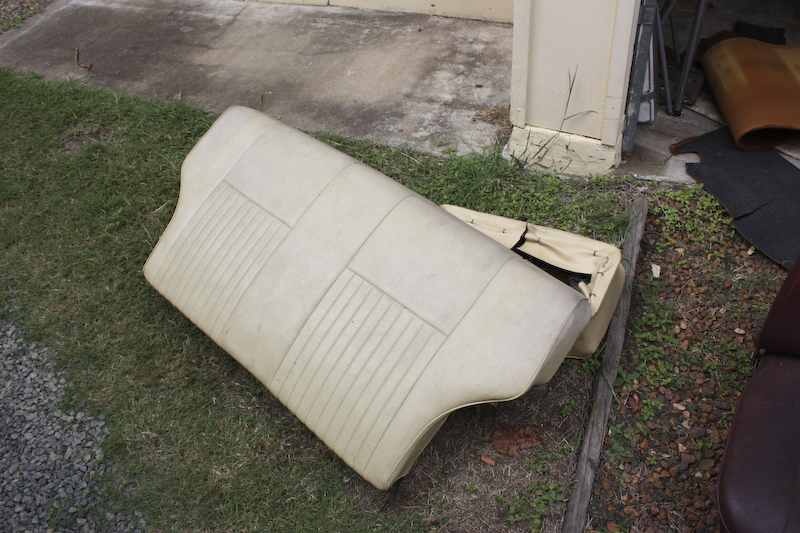

Back seat out after all the trouble i had.
Ready to start Cleaning out.
THE RUST!!
Trying my best to remove the shit as quick as possible.
The seats are looking ok, Few marks and wearing but they look straight, should be able to use them to re trim :D I don't know were the Drivers side went :D lol it has a cover on it so i don't know what its condition is like, ill try find it later.
