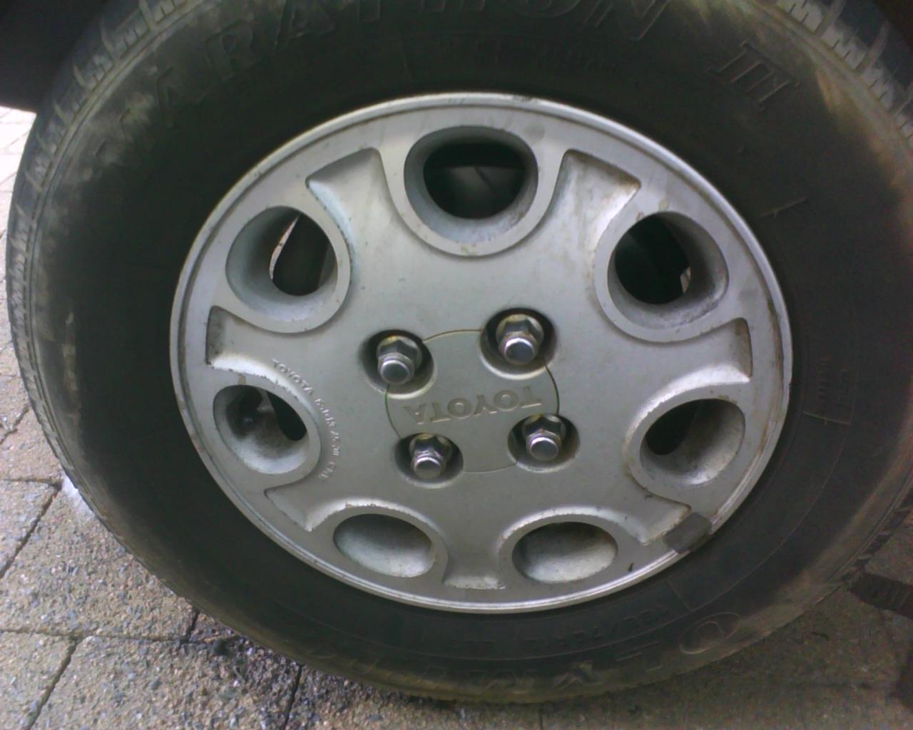

i want to find a nice set of 15s with open face spokes to show off my pretty rotors. when i get back to qld, ill put the car on jacks and remove the calipers and paint them, just unsure of what colour.

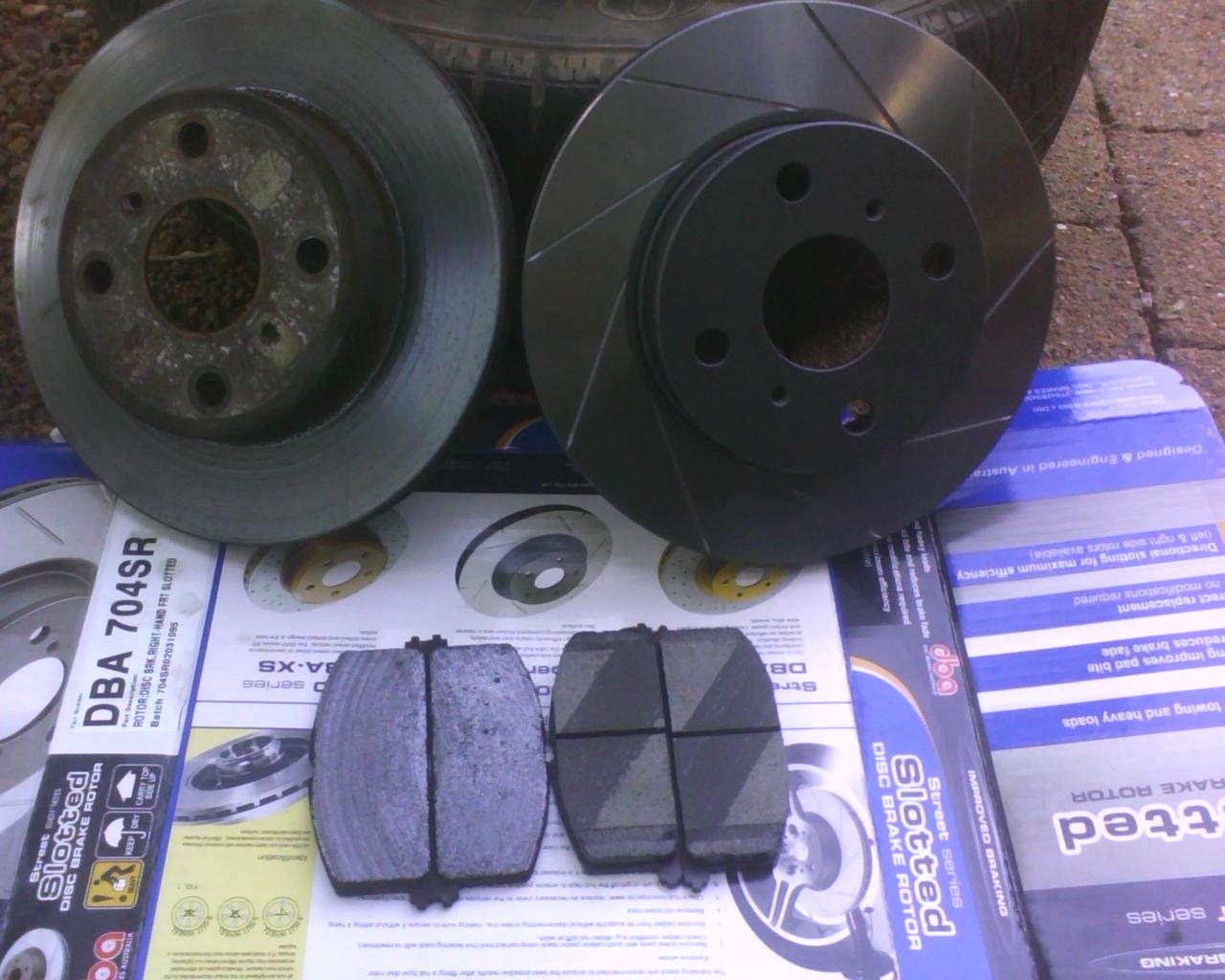

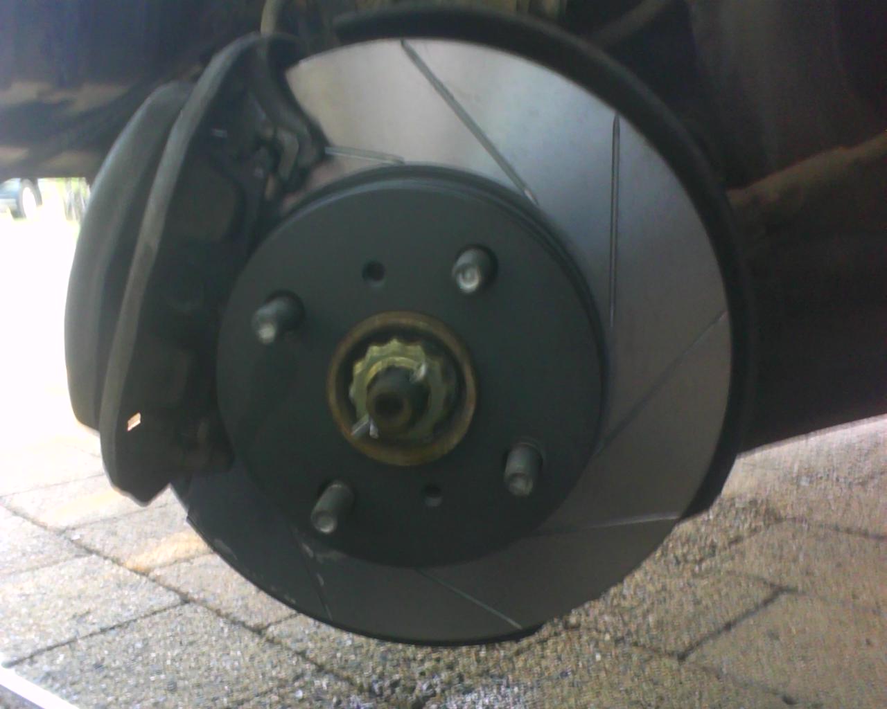

my sexcy slotted rotors arrived and got fitted day after :lol:
they are so great to be behind, so responsive over my old glazzed rotors... running the new pads is magic, wish my first rolla had this braking setup :(

nahh mate easy as... took me probs 45s mins each side, including time for me to dick around and make a few JD and coke :(

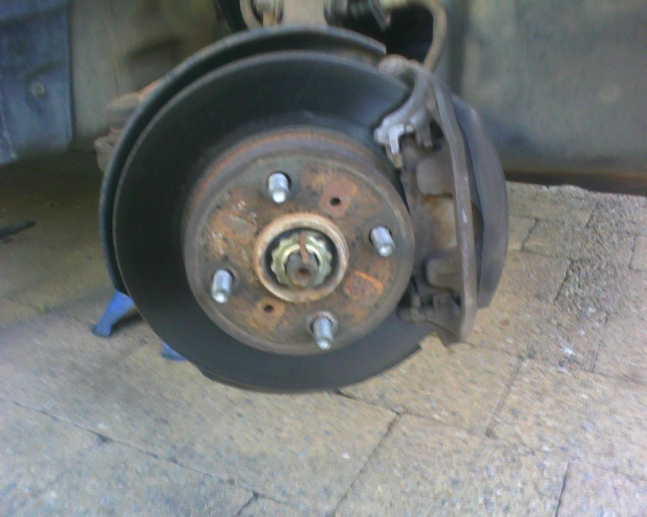

simply take ur calipers off, slide the piston back in with multigrips or a piston pusher, take the bracket off, pull the rotor off/hit with hammer to loosen rust seal/use two bolts to undo them carefully :lol:, then i sprayed the rotors with brake clean to get directional stickers off, simply slide then back onto hubs, and reit everything. if possible keep the lil anti-vib shims...
