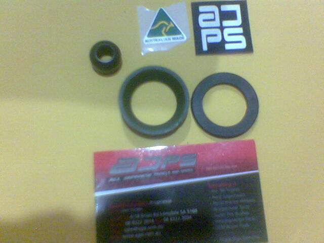

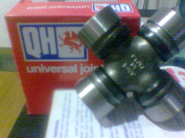

Got my AJPS shifter kit today and some UV joints made by QH.
Both Items Look pretty quality.
I'll see how they go in the coming days!

The T50 rebuild kit the best $55 i have ever spent, my shifts are that much better now good work man nice clean AE71,
love that interior trim to, keep up the good work. :D
yeah man. Big improvement over the shit bushes that were just in chunks and paste.

Haha lolz at your last comment, yea my rubber boot was a bit torn and cracked as well but wasnt leaking much all my bushes in my shifter were long gone as well just granules and rubber paste haha, when i drained my gear box i only got about 300ml of sloppy paste out of it instead of 2.7L of oil haha, i also put a new speedo drive in as my speedo drive was fecked, after a few days i really felt the difference in the smoothness of shifts after the fresh oil worked its magic. :D

Also I bought some UV joints for my tail shaft. Should I fit them before I fill up the box because, Will oil piss out the back if I take out the shaft?
Otherwise that would be a waste of oil if that does happen ;)
please shed some light. Danke schon!
