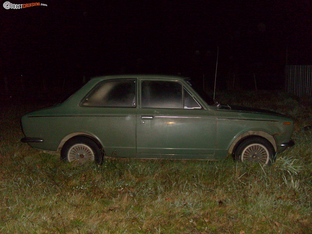

been after a ke10 for a while for a project. Had a guy send me a message saying he has a 'ke10' but side on it looks different.. its still sedan style but the boot looks longer and a slightly different angle..
what I'm wondering is.. can anyone tell me what is the differences between ke10 and ke11 body wise?

here is the photo also..

about the only differences in the actual body are the air vents on the C pillar of the 10's. Same goes with the Wagons, no air vents on KE16's only KE18's. This one doesn't have them, they're either bogged up which is common as they rust, or it's a KE10/KE10B.
It's also got later style indicators, so it's most likely a 10B
No body lines are different between 10's and 11's, all panels are interchangeable. Sprinters (KE15/17) have different doors, window rake is different.
Just look at the chassis number.
