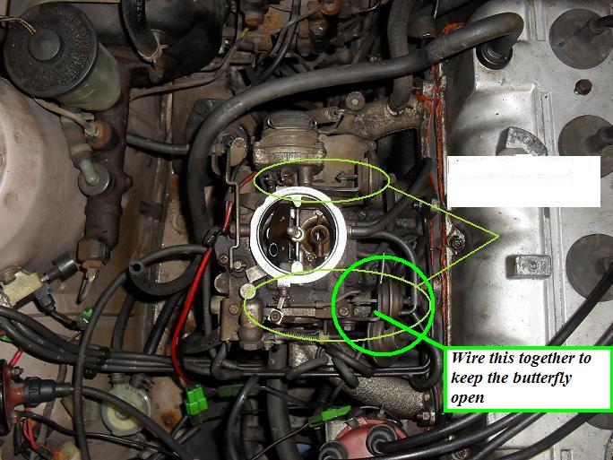

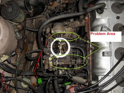

hey, would anyone know why my auto choke would be making the car rev right up(like 5k+ revs) when its cold.
If i hold the little arms/leaver(circle in picture) down to keep the butterfly open it seems to rev alright..... if i don't hold the leaver down the butterfly closes and the car wants to rev out till its warm. i had the carby off the car a while ago while i was doing some work to the motor. not sure if all the hoses are in the correct spots.
Cheers Zac

Your hoses look alright from that pic but i'll attach a vacuum hose diagram for you.
How open does your choke have to be before the revs are correct?
How shut is your choke for the revs to go 5k?

I checked all my hoses they seem to be in the right places, i ended up wiring the dashpot/butterfly leaver together to keep the butterfly open.... seemed to sort the problem out.
maybe give that a go dude
Where the green circle is, is the vacuum actuator for the Auto choke.
There is a neoprene diaphram inside it and they fail after 30 years.
Try Repco or a carby shop for replacement ones :)
