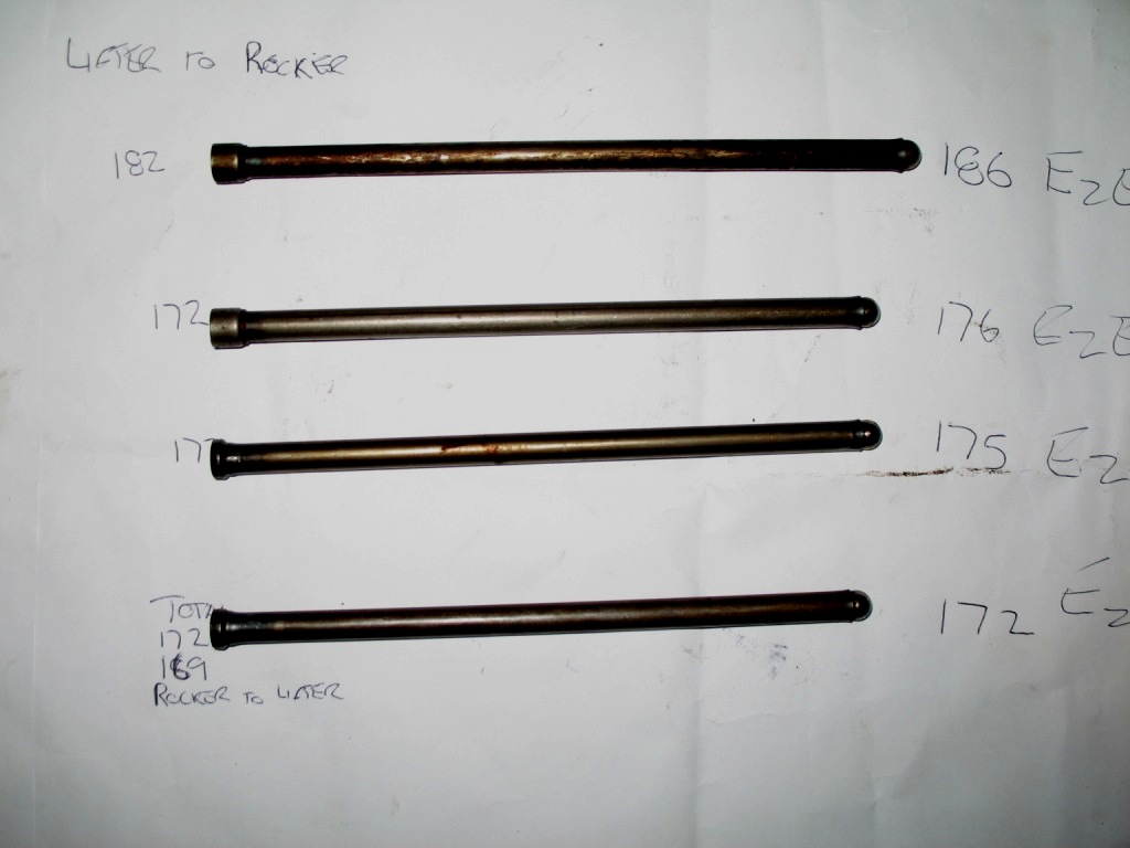

Found what I think are 4k push rods in a 3k engine of unknown history. this prompted me to pull apart a few other 3k's I have laying around, Now I'm confused.
Push Rod 1 Length end to end 186mm and from Lifter to Rocker 182mm. ( suspect 4k)
Push Rod 2 Length end to end 176mm and from Lifter to Rocker 172mm. 3k
Push Rod 3 Length end to end 175mm and from Lifter to Rocker 172mm. 3k
Push Rod 4 Length end to end 172mm and from Lifter to Rocker 169mm. ( suspect early 3k bigport ???? )
Note Also different cups

My guess is the short ones came off a head with the old style valve retainers, but I'm not sure.

The different lengths could also be to do with the different rocker post setups. Early alloy ones vs later cast ones.
