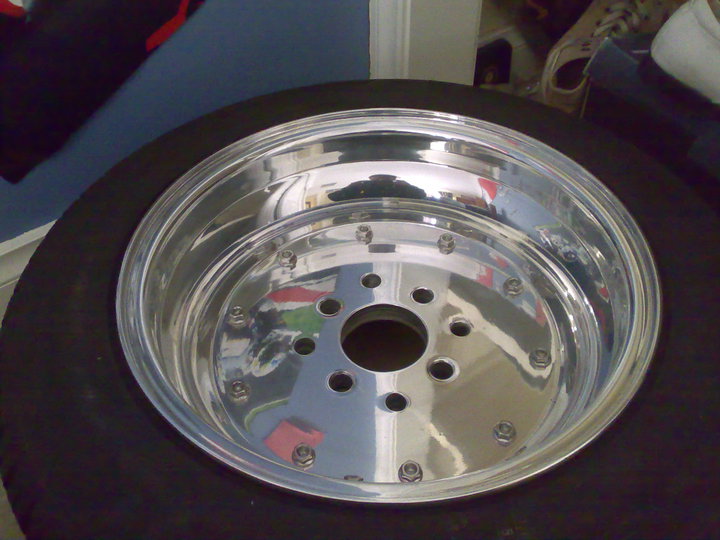

i recently bought a set of real good condition ssr mk1's for my ke35
as you can see they have been redrilled for another stud pattern
i know its a silly question, but when i bolt them on my ke35 what can i cover the extra holes with?
they reason i ask is because having them extra holes there kind of spoils it, it looks kind of ugly
thanks in advance guys ;)

Anyway to the question, maybe small welsch plugs? Theres also little red caps that you can buy off ebay and push into the holes, used on drag cars a fair bit. Ill try and find a link for you mate.
Edit: can't find them on ebay, maybe even machine up some alloy plugs and polish them? fairly simple to do.

nah i just picked them up for a reasonable price and there overrated conditon with mean dish so i just couldnt walk past them
i thought id just worry about the holes later on ahha..
yeaa thats true actually i could change the centres i don't know why i never thought about it.. ill look into that.

hehe yeah i know 14x7.5 -6 offset :) thats the rear though fronts are 14x7 0 offset
machining alloy plugs awsome idea it could work
thanks a heap man :)
if you want to turn up some alloy plugs, there's a really slick way to do it.
If you know someone with a good vernier caliper, get a good measurement of the hole diameter (to .0x of a millimetre) and let me know.
I can then tell you the right diameter plug to turn. A good machinist should be able to turn an accurate plug to the right diameter for a press fit size.
To get them in, get a bit of gentle heat on the mag, and put the plugs in the freezer. might need some slight persuasion but if it's done right they might drop straight in and as the temperatures match, it will be a tight as hell fit.

hey thats a smart idea could work real good philbey thanks mate
my old mans got the electric calipers and a lathe and his pretty good at using it so should be cake
I'm going his house today so ill tell you the measurement when i find out :dance:
