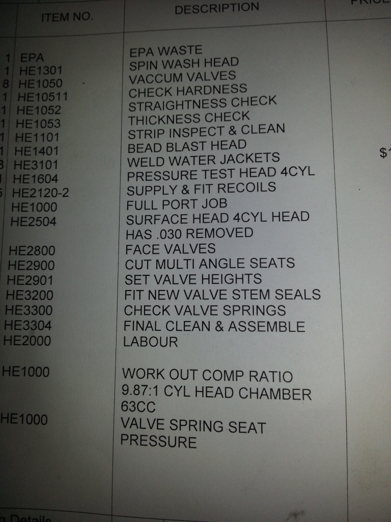

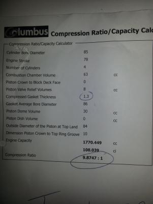

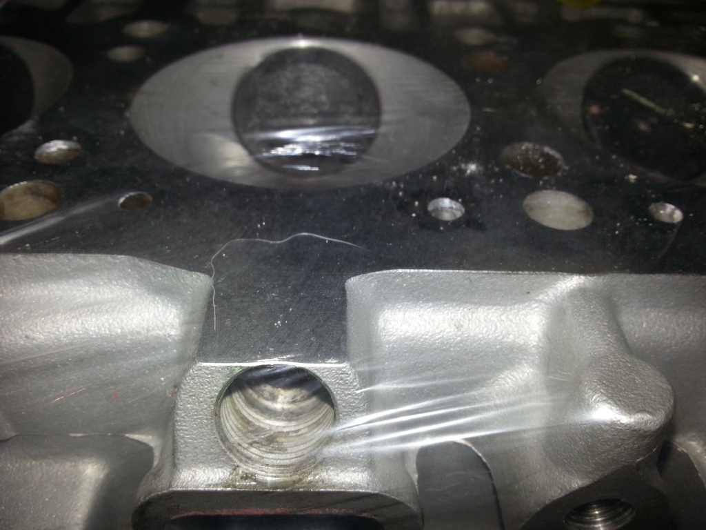

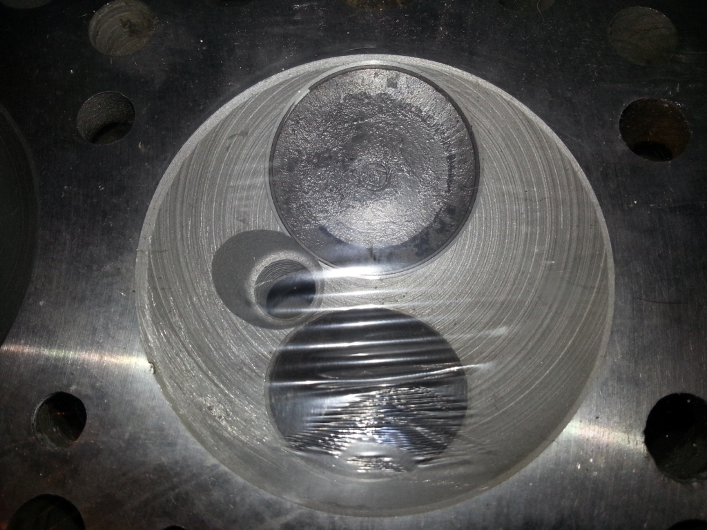

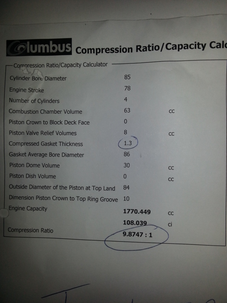

  12. Aww mate do it.. Ive put a 3tc in my ke30 its cammed 10.1 compression twin solex 40's still running stock pistons just new rings and bearings My points dizzy is a bit screwed and the carbys need a good tune From 40 till 120 i just pull away from my cousins auto vn commodore I couldnt belive my self, ive never driven a a stock one so i don't know how good they go Ive been in a mates big port 4age ae71 sounds good, great to drive nothing special tho The 3t would definantly give him a run for his money...but he sold it :( I'm runing completly standard breaks and drive line, my ke30 is an early one so i have the same diff as u (jap dif) Where abouts u from?
