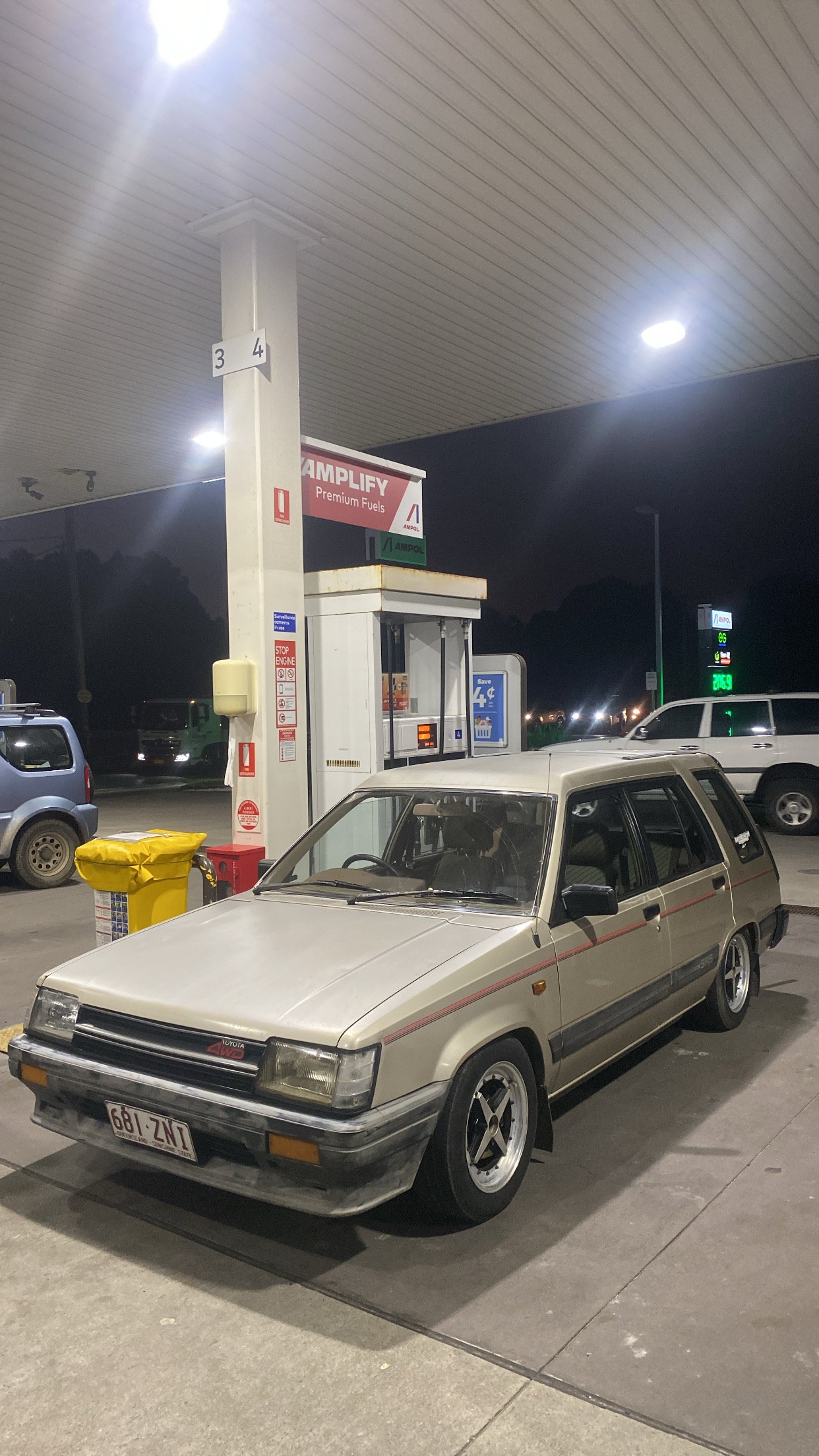

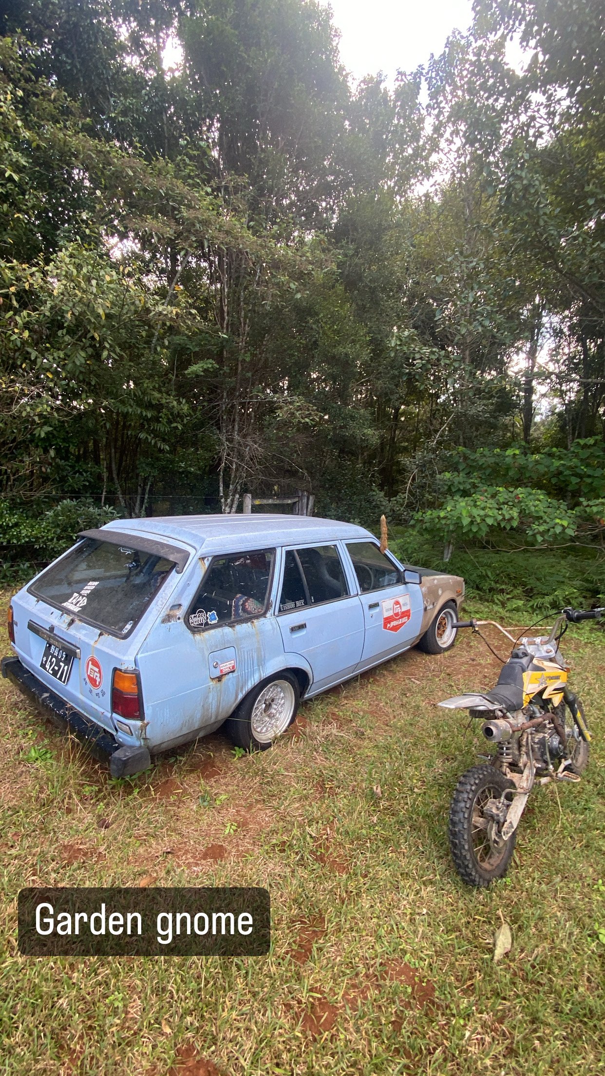

Hey fellas got a al25 1986 and looking to do 4age t50 with a ae86 diff got all the bits here done measurements have to use ke70 subframe and move it back about 60mm ke70 rack lcas coils etc (using ke70 subby cause it sits lower then ae71/86 ) to clear bonnet just wondering if any of you lads here have done it I seen a fella has tercel gear in a ke70 so should be able to be done the other way round . The car will be a daily drive / drift and circuit racing to piss the old man off in his charger Hahaa twin cam 4age mild cams twin side draft webbers cause cbf to run efi and surge tanks etc will post pics of car bellow and my ke70 wagon with 4age if I can first timer on this page . Cheers kaleb from Mullumbimby nsw
