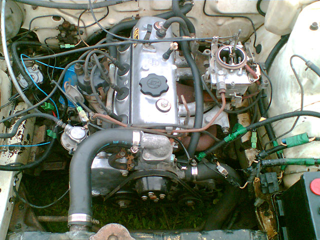

Swapped in a 4k. Unsure of its history... apparently it was rebuilt a few years ago. The rear-main leaks a bit I think (coz it was a shocking mess), but it turns over, and was running when the Rallycar Project arrived in my life. Couldn't get it to fire... I don't think I've wired it up properly. :D

This is the 4k that I installed. Nice and clean after a big degreaser session!!

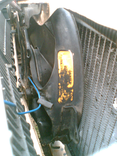

Added a thermo Fan to get rid of the one off the engine (apparently frees up a few more Horsies). Don't know how I managed to get this thermo, but I think it is off a Magna.
Fits nicely, and I hope it will work efficiently.

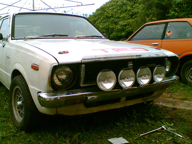

This was today... Fitted the 4 Narva lamps that were off my old 323 rallycar. You will all be able recognise me from a distance out on the road :jamie: May have to consider upgrading the alternator... ;)
