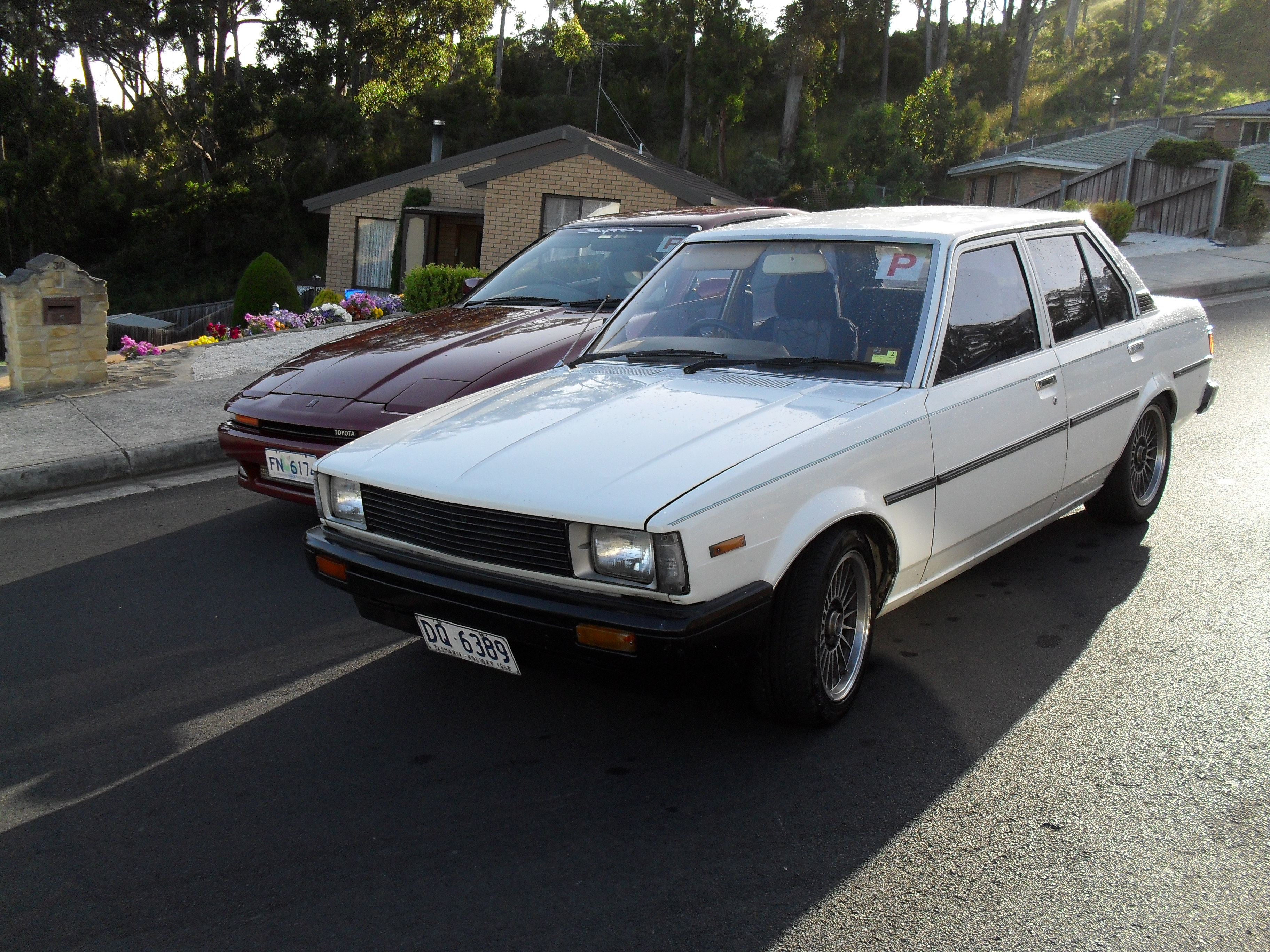

i've done an ae82 bumper swap. came out pretty good, would look better on a slanty front i reakon. I made custom brackets and held the bottom to the beaver panel with screws for support. But the indicator plugs are different so you have to put the ke70 ones on the ae82 indicators.
A easier better way i reakon would be pull the factory bumper plastic off the metal frame and screw the ae82 bumper to that.

Nice I like it :)
