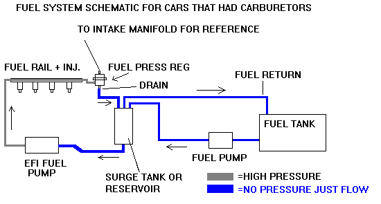

hey guys ive just recently fitted a surge tank setup in my car. However now my engine is not getting enough fuel as the car is not running smoothly and is misfiring. Ive double checked all the hoseing and everything looks to be in the right spot. I'm thinking the fuel pump is not pumping enough fuel?? Also when i switch the car to start the fuel pump doesnt prime, only until i completely turn the car on then it decides to pump fuel.
If anybody can help me out it would be greatly appreciated. Thanks

Have you got the lowest point of the surge tank feeding into the bosch pump, the facet feed above that and the return to the tank above that?
Is the return from the engine bay going back to the surge tank or to the fuel tank?

the surge tank should be always full, and over flowing when running (ie slightly pressurised). thus no priming needed.
dividee, maybe draw a diagram in paint exactly how you have hooked up the pipes. showing which pipe on the surge tank you have hooked up which line.
what have you done with the return from the fuel rail?
yep everything is correct. Lowest point to fuel pump > fuel rail. Than return from engine to surge and overflow back to fuel tank
