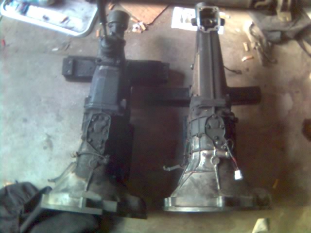

got ma gearbox's out so ready to swap in the 5 speed
il let you guys know how it turns out

gearbox swap was easy, extractors & exhaust done 1 3/4' into 2' ,

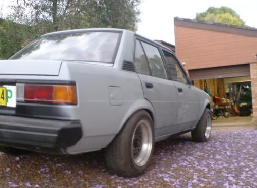

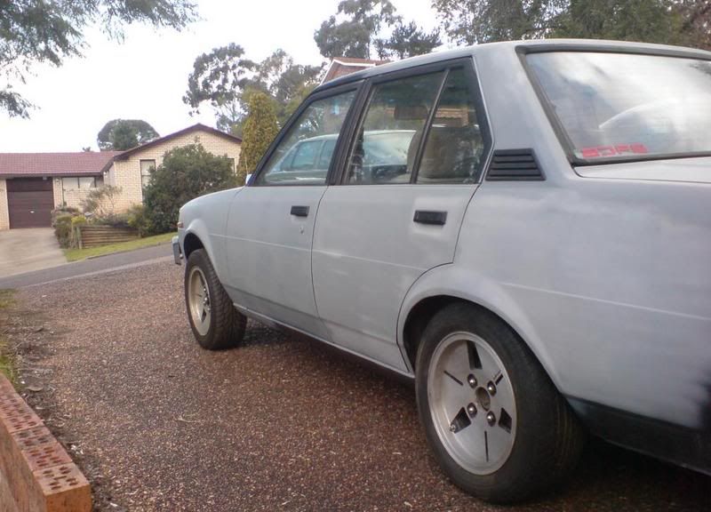

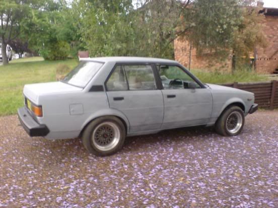

14x7 & 14x7.5 southern ways mesh wheels
14x6 advan wack-lookin wheels
dishy
wack lookin advans

That gearbox was a KE55 5 speed. It wouldn't have bolted straight in...did you change extension housing? Or modify things
modified the crossmember (drilled 2 new holes in it)
modified the original shifter position forward about an inch
