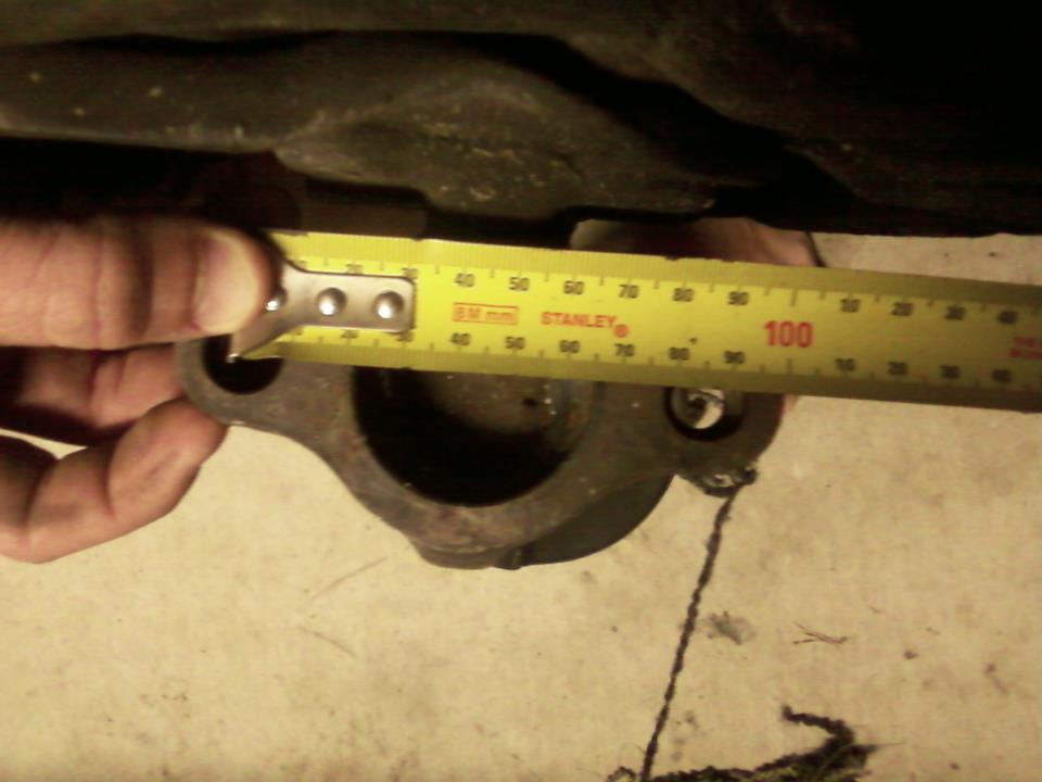

Just went out and measured my stock ke55 struts, cross reference with the measurements on AJPS: http://www.ajps.com.au/parts/rca_ncrca.asp
Of course they are not steering knuckles although they share the same bolt spacing as they go between the strut and steering knuckle. "Fit early Toyota's Celica, corona and AE86 type struts (85mm)"
As you can see my stock ke55 struts are 85mm center to center; the rca's that are on ajps are also 85mm. Chillin has also confirmed that 86 struts do in fact bolt up to ke55 steering knuckles, and can also confirm ae86 struts bolt to ke70 steering knuckles. I can confirm that these ke55 struts bolt to a ke70 as well. Steering knuckles/arms whatever you call them do not need to be changed in order to fit ae86 coilovers into ke30-70 and ae71's.
If you require more proof then I will happily take the 86 struts from my brothers car on the weekend and measure them too.
I can also take a photo of some xt130 struts the bolt spacing for them is 87mm so you will have to change steering knuckle/arm to suit a ke or ae.
