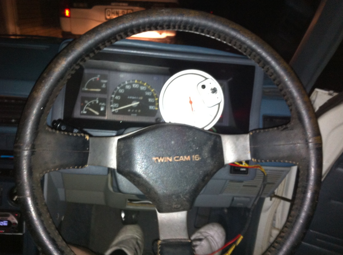

Running the stock 2sc but its been rebuilt 30k ago apparently. Already done a few mods to her. Put a set of Ma61 mags on an i stuck my old twinky wheel from my keto in too. Doesn't have a tacho, but instead rocking the huge clock. I have a 5" autometer tacho i could put in, but it seems a little over the top :/

Yeah once i thought about it for more than 5 seconds i realized it can only be in the dizzy since there wasnt a coil lead. Also, if anyone is interested to know, you cane use the black ground wire that disapears into the dizzy as a signal wire for a tacho, just need to tap into it.

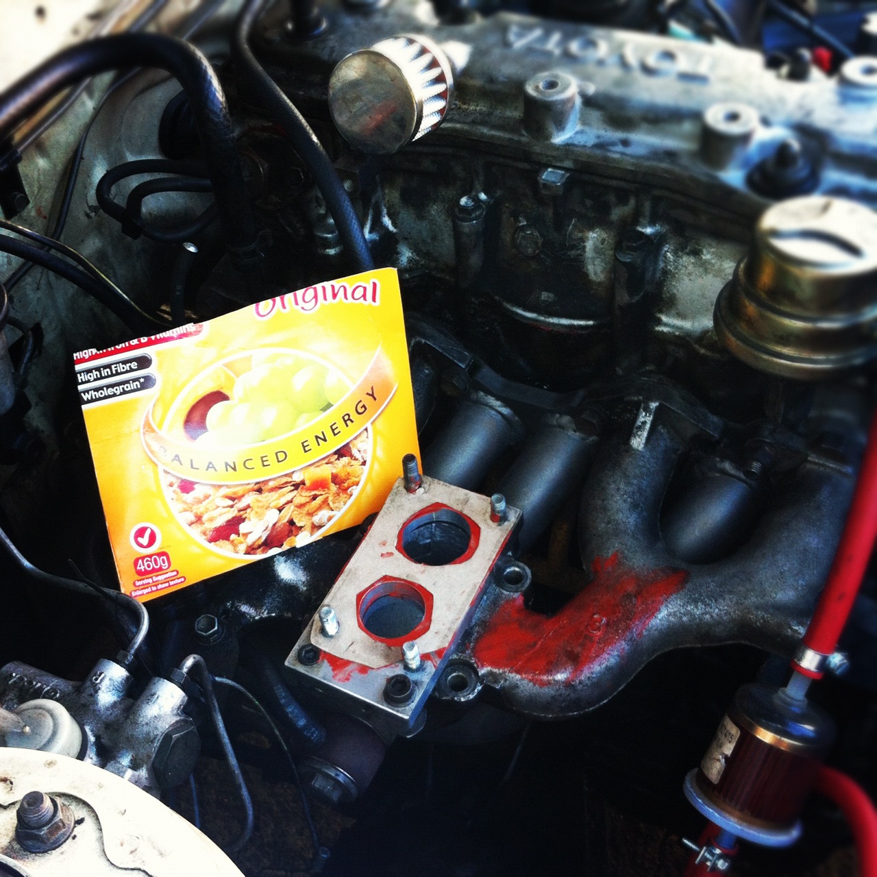

Installed my 32/36 today. Running a bit rough but i still have to adjust the mixtures and idle. Its a bit late to be doing it now. But took her for a test drive and its really amazing the difference a good carby can make to a motor. Been a few years since i played with carby cars.

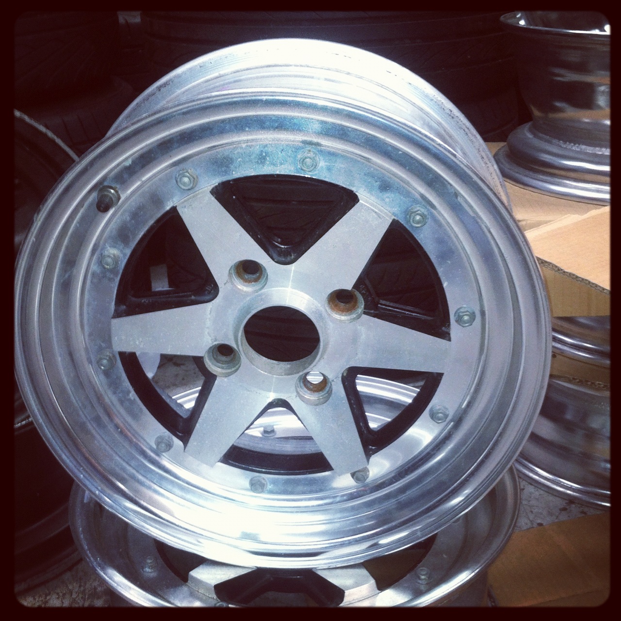

I found these at Just Jap, Unfortunetly they were a pretty poo offset. So temping with some 20mm spacers though...
Installing my heaps legit gasket.

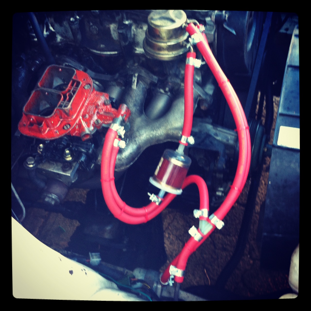

Did up new fuel lines for the webber as the old ones were a bit cracked and one had started leaking :/ Added the second filter as a bit of an afterthought for checking fuel to carby after pump, after wishing i had done it on two previous cars haha.

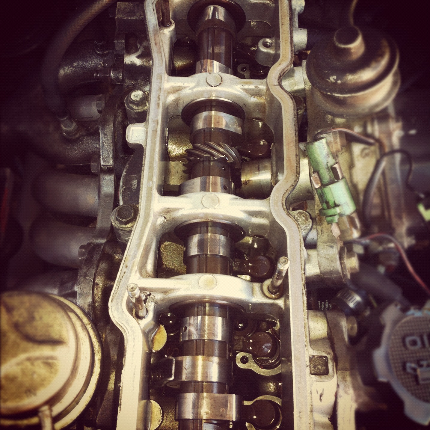

Finally got around to popping the top to check inside. The previous owner told me that the engine was rebuilt about 30k ago. Looks clean enough to be true to me.

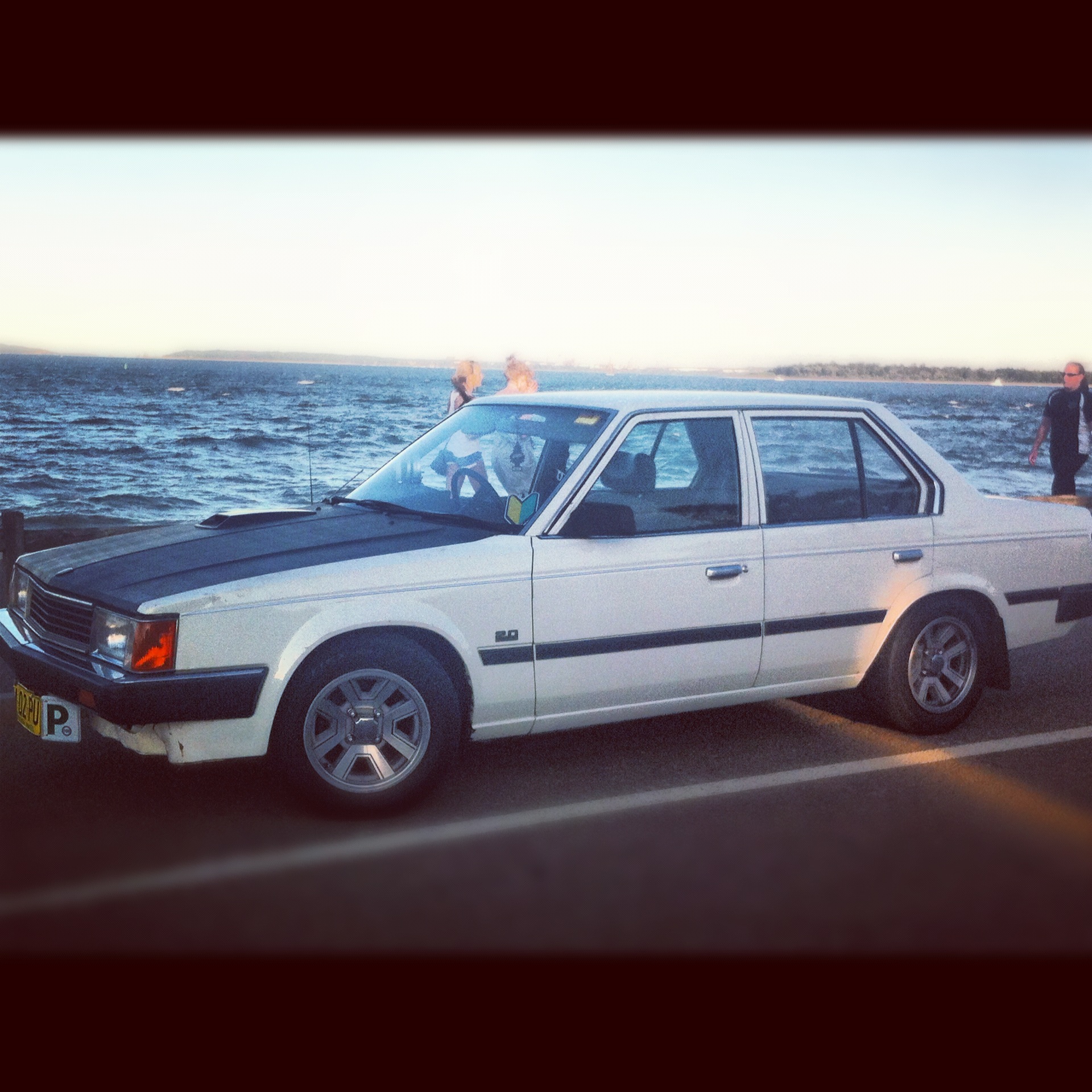

Snapped an artsy pic while waiting at the lights.
Looks good from side on, but needs more low I think.

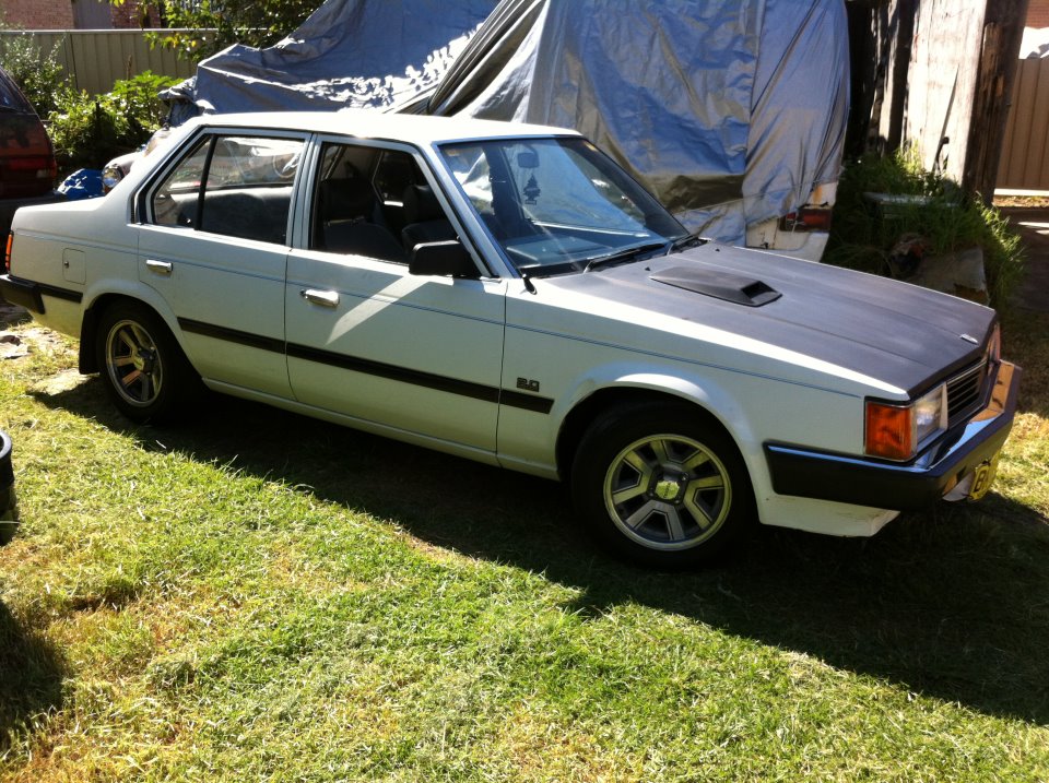

Took my wabaka out of the soarer. Its parked up for a while so might as well stick it on the daily haha
Please lose the bonnet scoop :P
Looks good so far though!
Yeah the previous owner actually cut a hole above the carby. Not sure if I should buy a new white bonnet or stick with it and make it more useful by building a cold air box around the webber. Haven't decided yet.

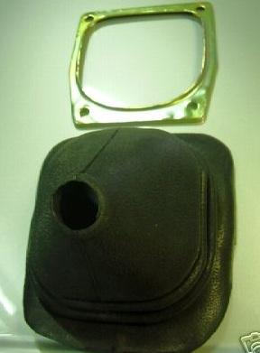

Small update: The car/engine has a pretty bad rattle between 3k and 4k. I looked down the top at the valve train but didn't see anything out of the ordinary. The motor runs very smooth under and above 3/4k. I tested with someone else driving pushing down on all the little bits of trim which i figured might be adding to noise to see if i could make the noise clearer so i could pin point it. I discovered that the shifter was making alot of the vibration and noise inside the car so i set to work seeing if i could improve it. I can't remember what model box it is but it has reverse as the top left gear, and you need to press down to engage it. Mine was so flogged out you didn't need to press down anymore and the spring and bushings were quite sad. It made a hell of a racket. had a look to see if i could use some washers to tighten up the spring a bit, but its not possible because of the thickness of the shifter. Instead, I used a spare new rubber shifter surround i had from my last ke70 build.
The metal holder was not the right shape, so I used the factory corona metal surround. The boot needed some coaxing, but in the end I got it to fit perfectly. The inside was now separated from the outside by the rubber boot. It still had a rattle, which I decided was partly because of the loose shift knob, so I replaced that too. The inside of the car is MUCH quieter now.
