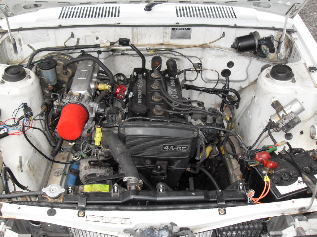

  5. 4age conversion is very easy,i did mine over easter last year. first motor wasn't so good but got another front cut for $400. i think japparts in lambton had a couple of fwd 4age corollas there. mine ended up costing me about $3000-4000 to convert. would love to turbo mine but funds aren't there at the moment. if ya need any help just send send me a message,am in newy too. this is my engine.

  14. hook them up to cooling system.I think one of mine goes to pipe out of back of w/pump,the other to a tee piece i have in other heater hose. hope pics make some sense.
  15. yep,looks like the two water pipes on t/body not hooked up. didn't have mine hooked up originally and it idled really high. the two pipes sticking out the bottom of t/body that are blanked of need to be hooked up to cooling system or you can take the fast idle unit off the bottom of the t/body and blank that off. hook up the pipes,works relly good on mine now.have fun...
