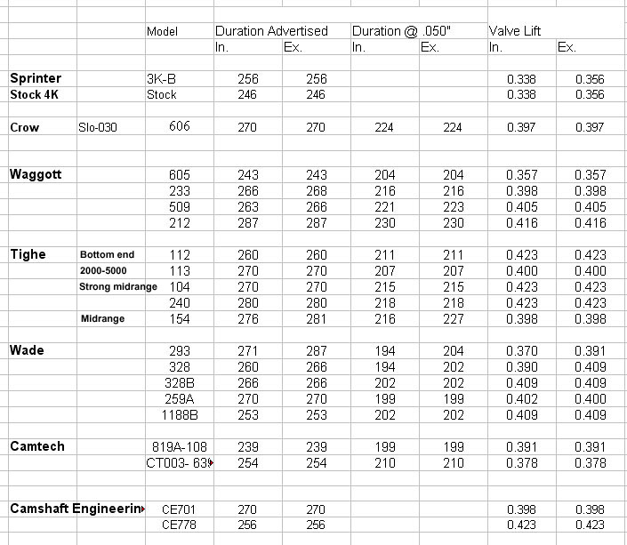

Right, as for the other stuff, so maybe a 275 cam grind? As for the the carbys, what would be the cheaper option?

Cams... you really need to drive a couple of guy's cars to see what cams are like. I listed the torquey cams when I was looking, as I wanted an easy daily-driver for the daughter. I've got the Crow 606 grind, a 270deg like Tighe's 113 grind, and I added Tighe's comments about their grinds. If you want to fly, there are lots of hot grinds I didn't list here, up around the 280-285deg. Find someone's build you like the look of and PM them for which cam they used.
