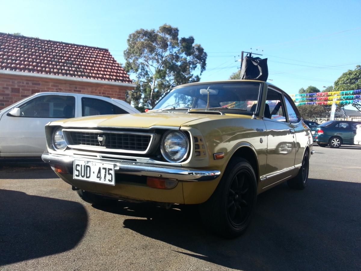

Thought id put a build thread up of my KE25.
Has been a country SA car most of its life, I'm the 4th owner, mother passed it to her daughter, friend bought it from her and kept it garaged for few years and i bought it from him.
Came with a glove box full of receipts and stuff going back to 1974!
Nothing special at the moment.
KE55 4K, KE55 5speed
5k Electronic dizzy
TRUST Air filter
Sports Radiator cap
Flipped leaf springs with TRD Blue short stroke 8-way adjustable shocks
Redrilled rear stock axles to 4x114.3
KE30 front brakes
1 coil cut front springs
14x6.5 Watanabes on rear 185/60 RE001s
14x6 BR watanabe copies on front with 3mm spaces 175/60 Yokohama Advan somethings (def from japan as can't get here)
New carpet
Nardi 330mm steering wheel on HKB boss kit
TE27 Centre console
TE27 Tacho guage cluster
Have picked up a KE55 4K and currently at the machine shop getting cleaned up and built as current motor is down on compression, uses oil, has rough idle and is bit smokey.
Plans:
Stockish rebuild on this motor
5k Electronic dizzy
Rebuilt twin solex carbs
Custom extractors and exhaust system
Ae86 coilovers
15mm or so lowering blocks in rear so can go lower (need to roll guards first)
Future Plans:
4AGE, maybe carbed undecided yet
T50
Shortened AE86 Tseries diff
TRD wing and front spiler/lip
Full respray in greenish colour

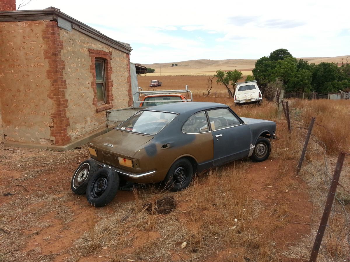

Also heres the current status of my brown KE25, serving as full time parts storage:
and my white KE25 got stripped and sold to a guy from NZ who lives in WA and works in the mines, apparently gonna fit a 13BT to it.
