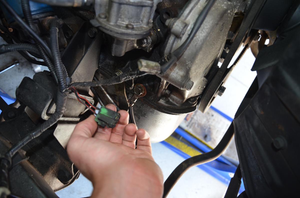

Hey guys, picked up this ke55 not long ago, and after doing a auto gearbox change I noticed two plugs that were just hanging there, and one emissions tube that was plugged (lol with a golf tee), I am just wondering what these are, and where they should be (connected to). I havent got a battery for the car yet, so am unsure whether these affect the normal operation.

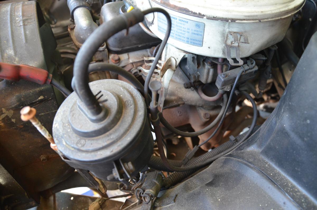

In reference to the photo below, its the rubber tube attached to the charcoal cannister, plugged with a golf tee

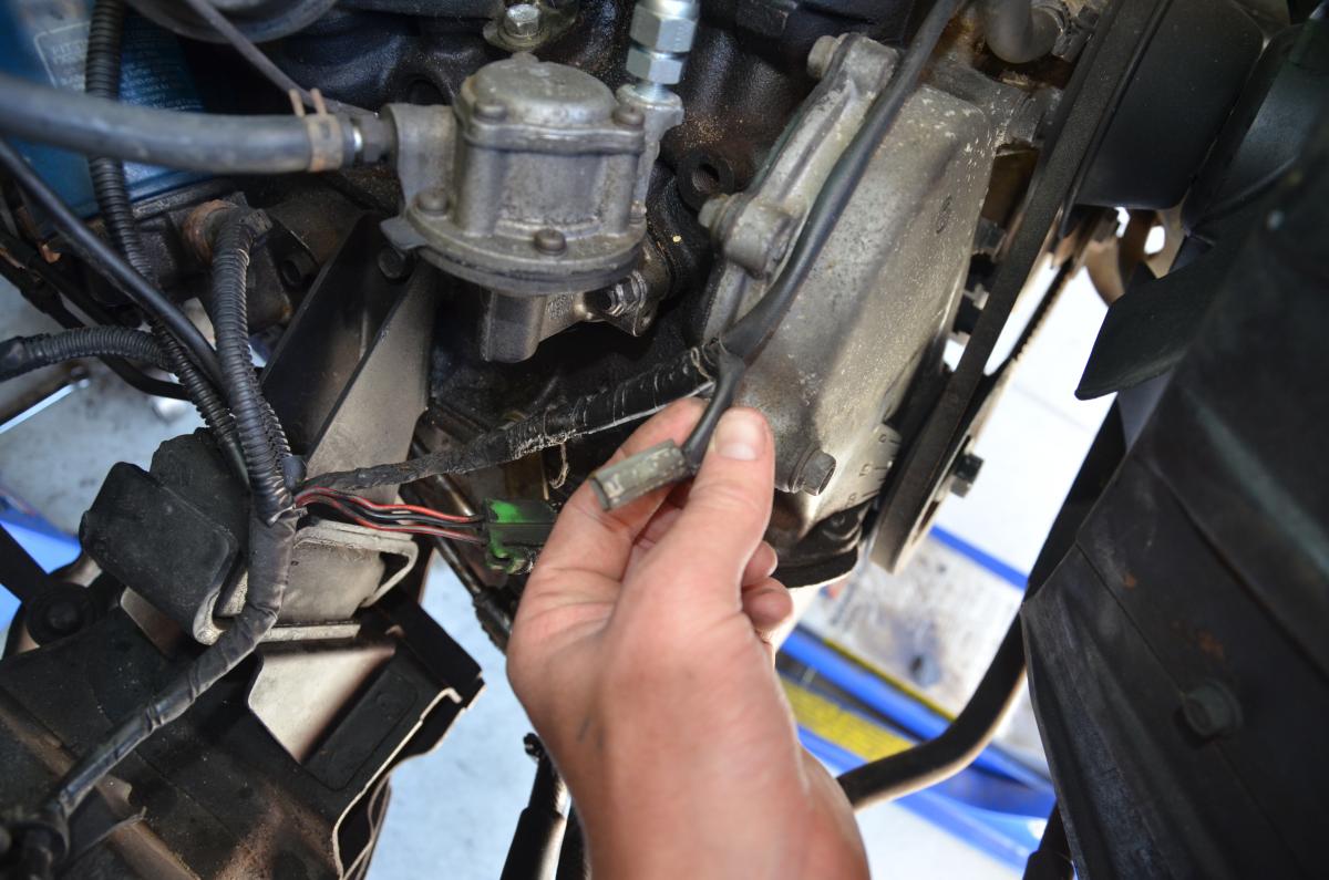

And the last one, this one is melted..
that makes sense, its where a compressor would be if there was one, just want to make sure they arn't needed before I go driving it around
Ok, its an auto though so the reverse wiring is in the car next to the shifter?
That green plug has the same coloured wires as the ones for the reverse lights.
Your right, Toyota made sure the one wiring loom worked for all models, both under bonnet and under dash reverse light wires,
cheers!
