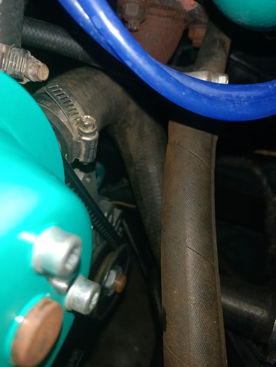

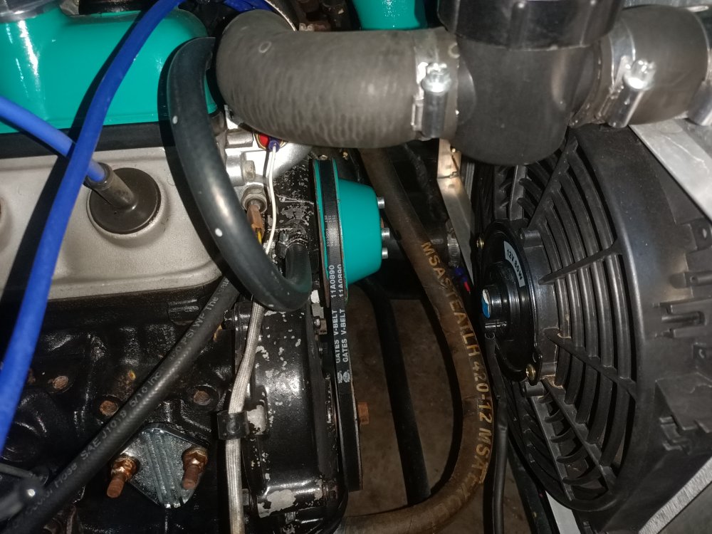

  3. I should have been a little more detailed with the heat soak issues, my bad, the problem isn't with the engine running hot or outside it's normal operating temperature, the issue lyes with the hot side of the engine, with the heat generated by the turbo, it transfers the heat to the carburettor and associated pipe work due to positioning of the turbo so close to everything.😩 It practically boils the petrol in the fuel bowl once turned off and sitting. I've tried to eliminate the issue by an isolating switch to the fuel pump so I can run it dry of petrol before the engine turns off, seems to help a great deal. Ah yes, the hose that connects to the front of the sump is the oil drain line from the turbo, the hose from the water pump is the turbo coolant return line, the feed line I've tapped into the top radiator hose water outlet.😃 The distributor side of things is just a standard 5k electronic distributor, I've removed the weights and wired the mechanical advance shut so it's constantly set at 8degrees. Nothing flash here that's for sure.🤣🤣 And in saying that, I've had to run much colder range spark plugs in order for it to run right whilst operating under boost, that certainly wouldn't be helping with hot starts either.😩 And yes, the thermo fan is wired to a temperature switch located in the lower thermostat housing, turns on and off with the ignition. Cheers.👍
  4. Hi banjo, cheers for the kind words and appreciation!! Yes, I practically done everything myself (with the help from the wife and a great mate) from paint and panel, tinting windows, suspension, mechanical, interior etc just to prove to myself that a budget build could be accomplished. One thing I can't take credit for is the turbo fabrication, I bought the setup already done and just improved on it. Yes, unfortunately I had to remove the engine fan due to the drain line from the turbo, if I could have kept the original engine fan and shroud, I certainly would have as I find they are way more efficient in keeping engine temps down to a normal level. The complete braking system is from a ke55 and isn't the native system normally in the early ke30's, don't get me wrong, it's certainly tight in there for a ke engine bay. I run the tefba filters on all my cars, in my opinion they're Fantastic and do a great job, never had an issue in the last 20+ years using them. They catch crud that I never thought would have been in there. Na, I'm not a plumber by any means, just a tight arse that doesn't want to spend money.🤣🤣 I've added a few pictures to help explain.
