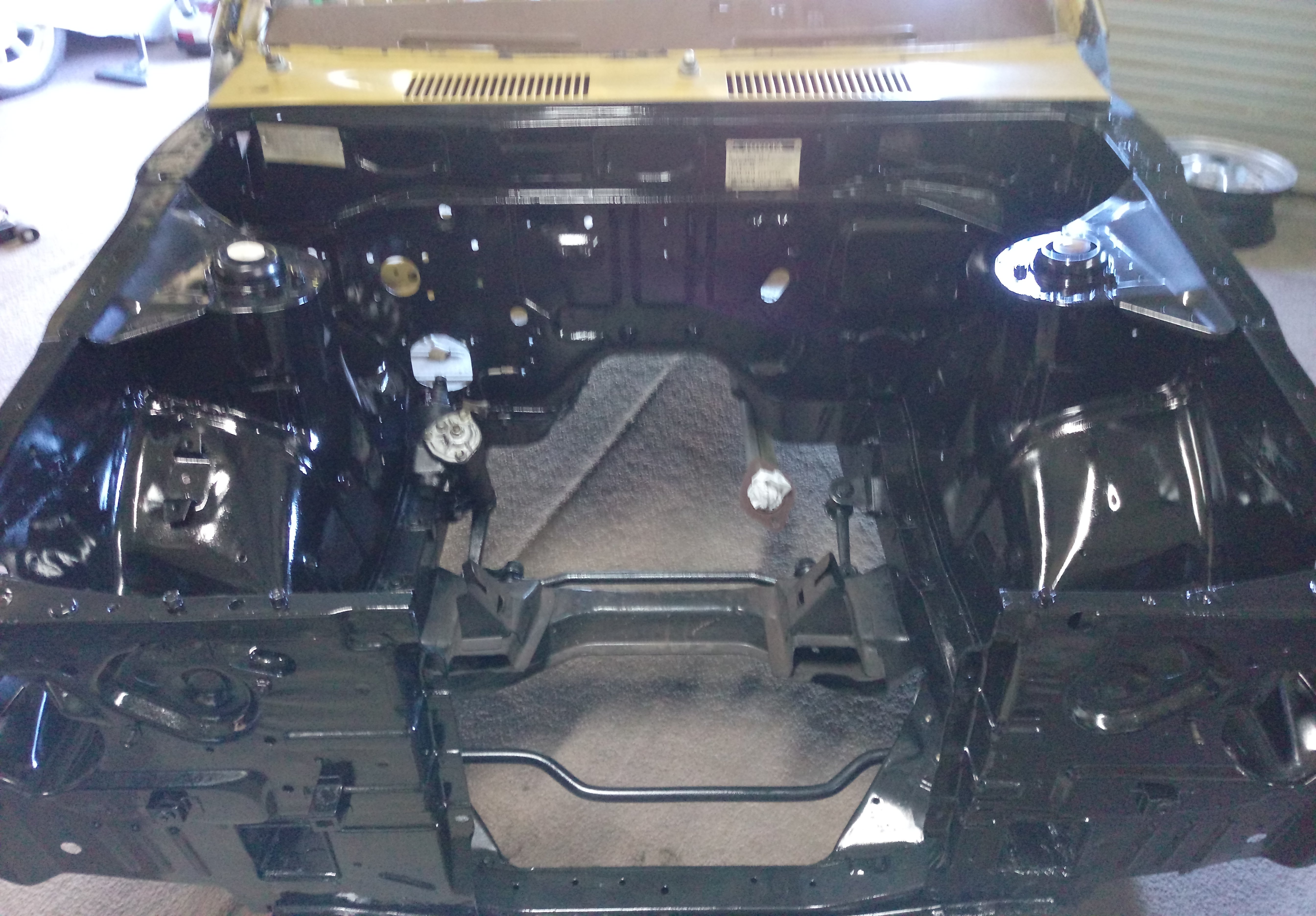

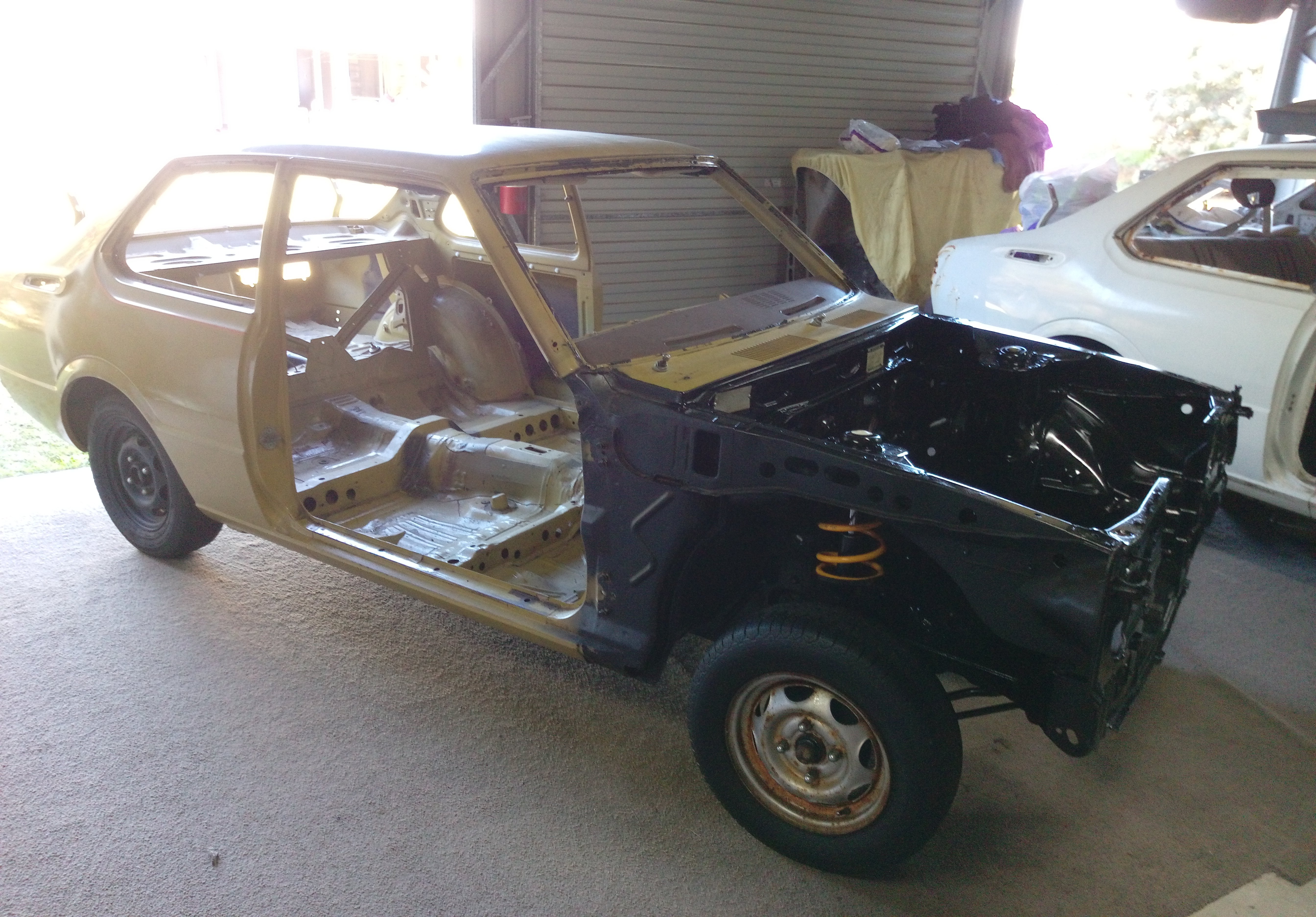

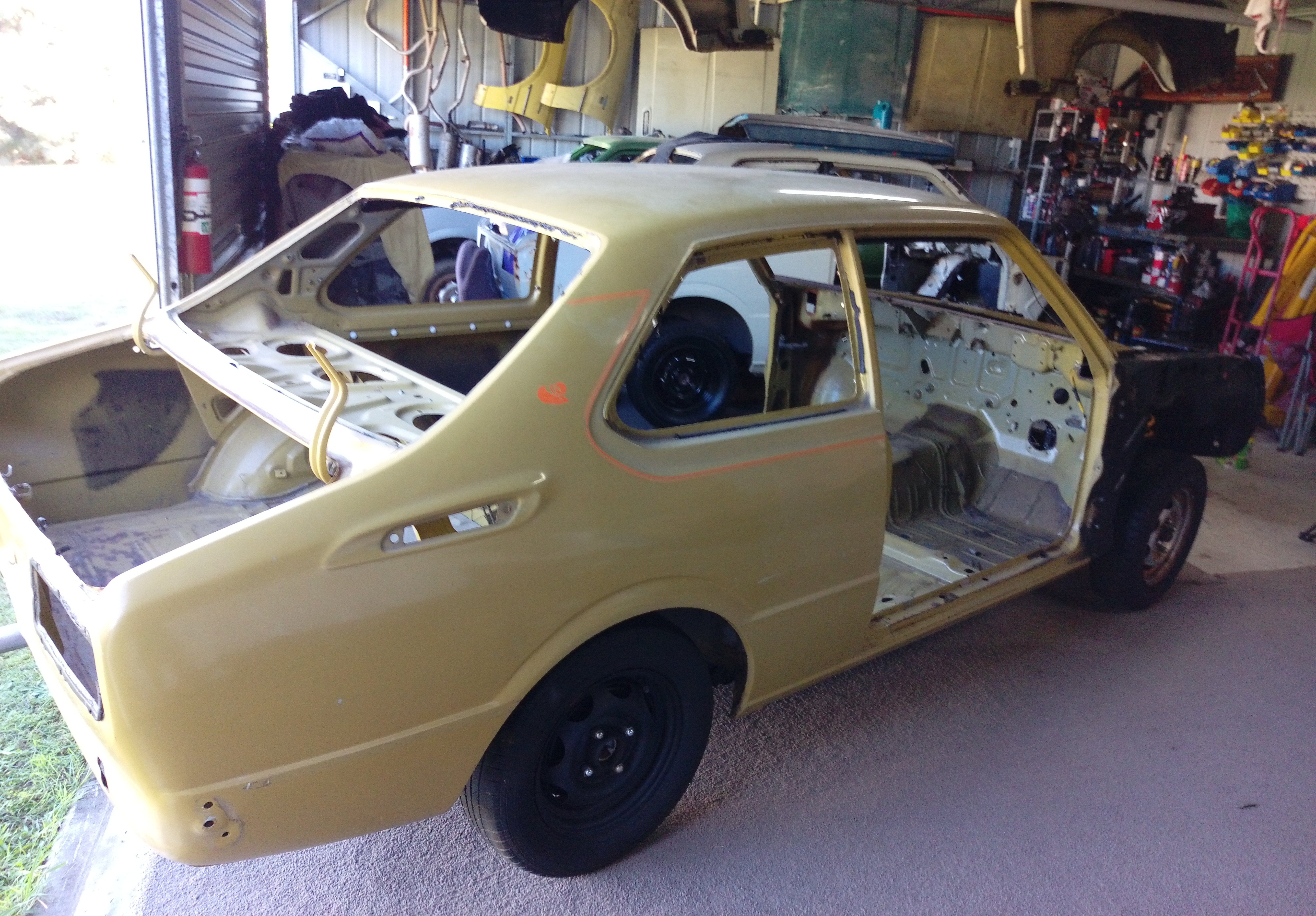

Clapped out Posted April 16, 2019 Report Share Posted April 16, 2019 Hiya fellow rollaclubbers! I've had a passion for ke30's for almost 20 years now, and thought I'd post up my slow going project!😂😂 I acquired this old girl 5 years ago, after being on chassis stands for that time, it's finally rolling again! So, the aim for this old girl, recycle and reuse the various shit loads of parts I have in my possession, and keep the build cost to an absolute minimum! This isn't going to be any show winning car, just a tidy driver! Story so far, All freshly painted underneath, engine bay! All new suspension bushes, shocks, springs, wheel bearings, running a 4.3 Borg Warner diff up back! That's it for now, stay tuned! 1 Quote Link to comment Share on other sites More sharing options...

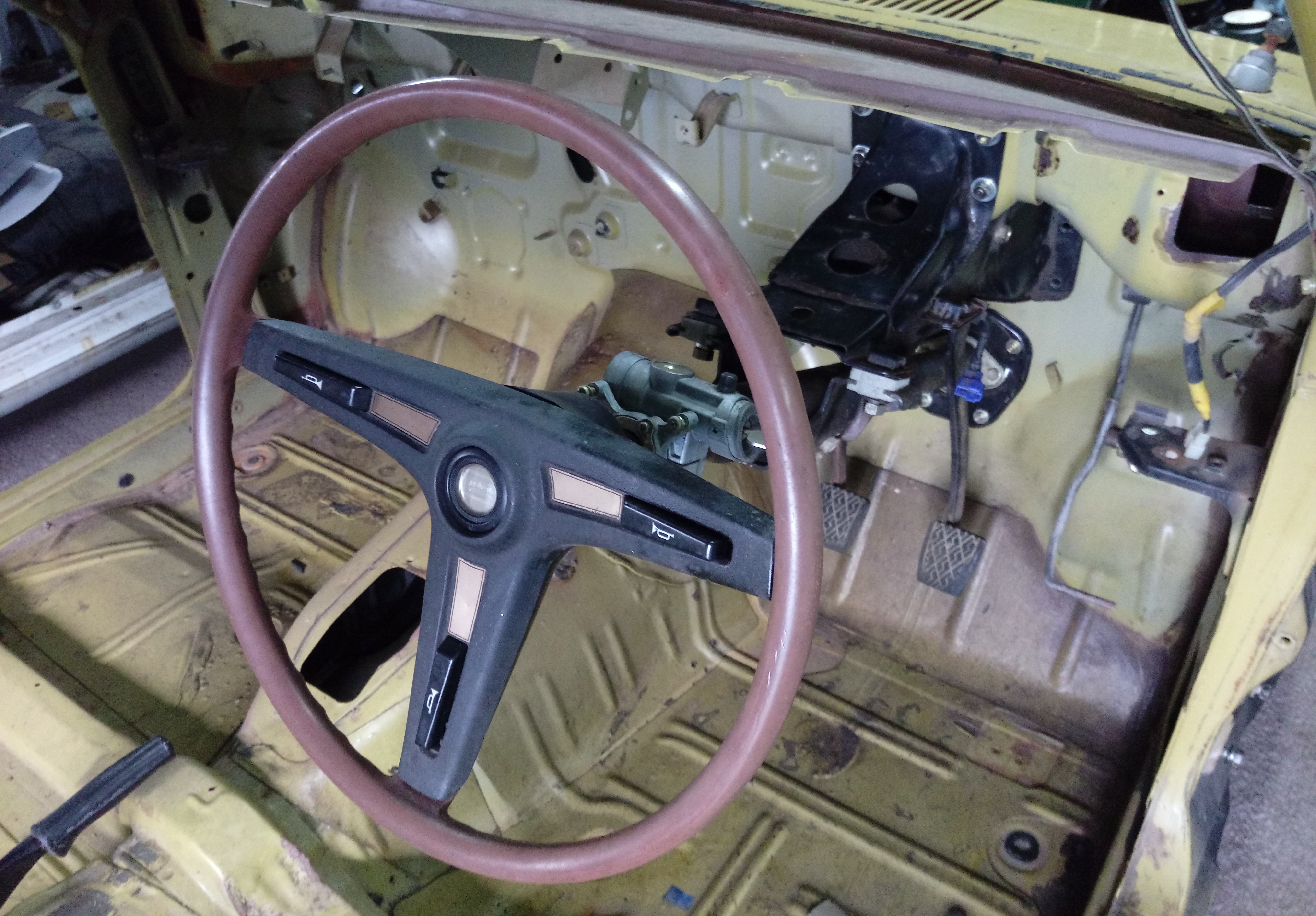

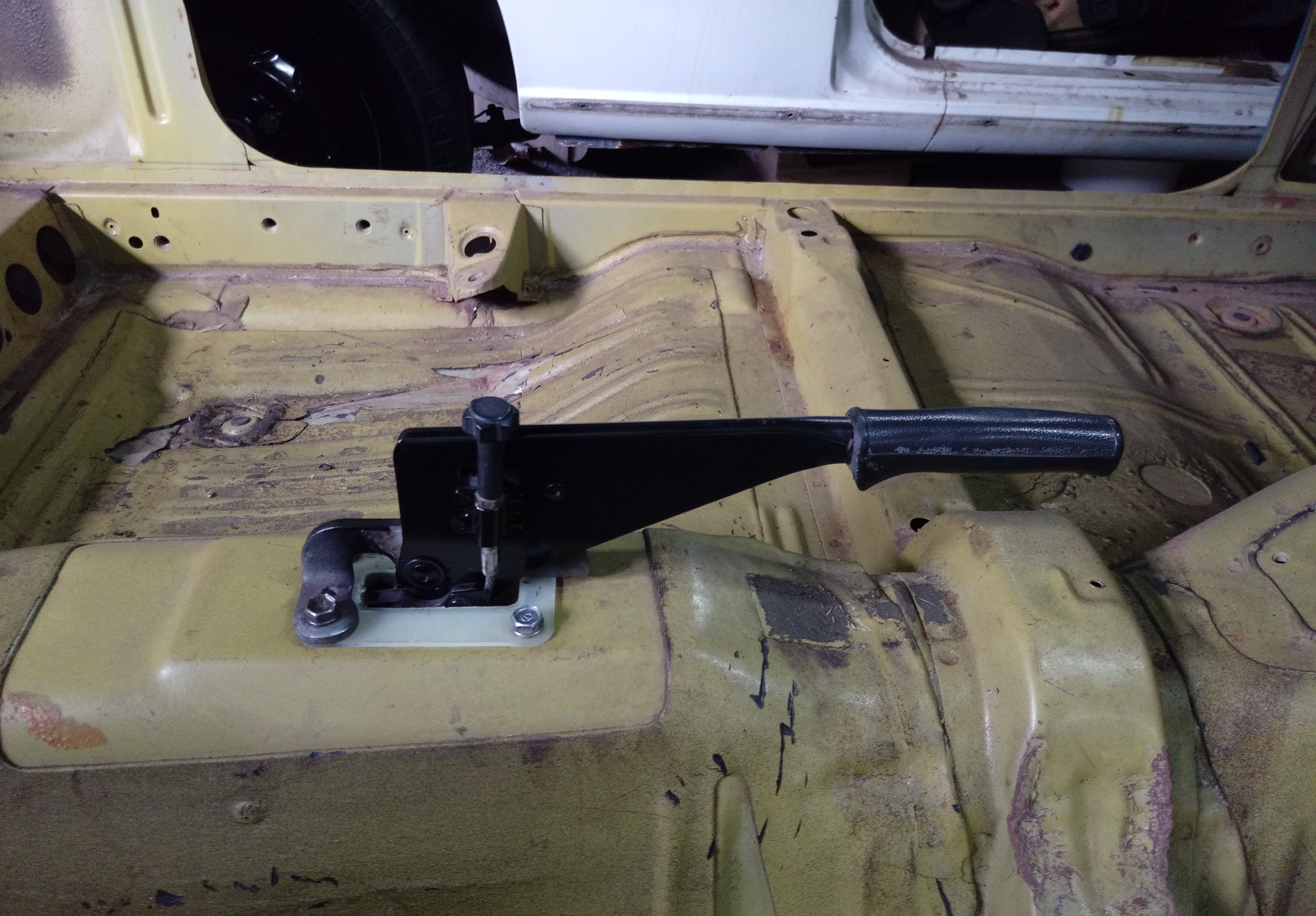

Clapped out Posted April 19, 2019 Author Report Share Posted April 19, 2019 Heya guys, Really appreciate your input Matt, will keep those pictures coming!😊😊 Not too much of an update guys, managed to put in a pedal box and steering column, also fished out a handbrake lever and got that side of things sorted! Quote Link to comment Share on other sites More sharing options...

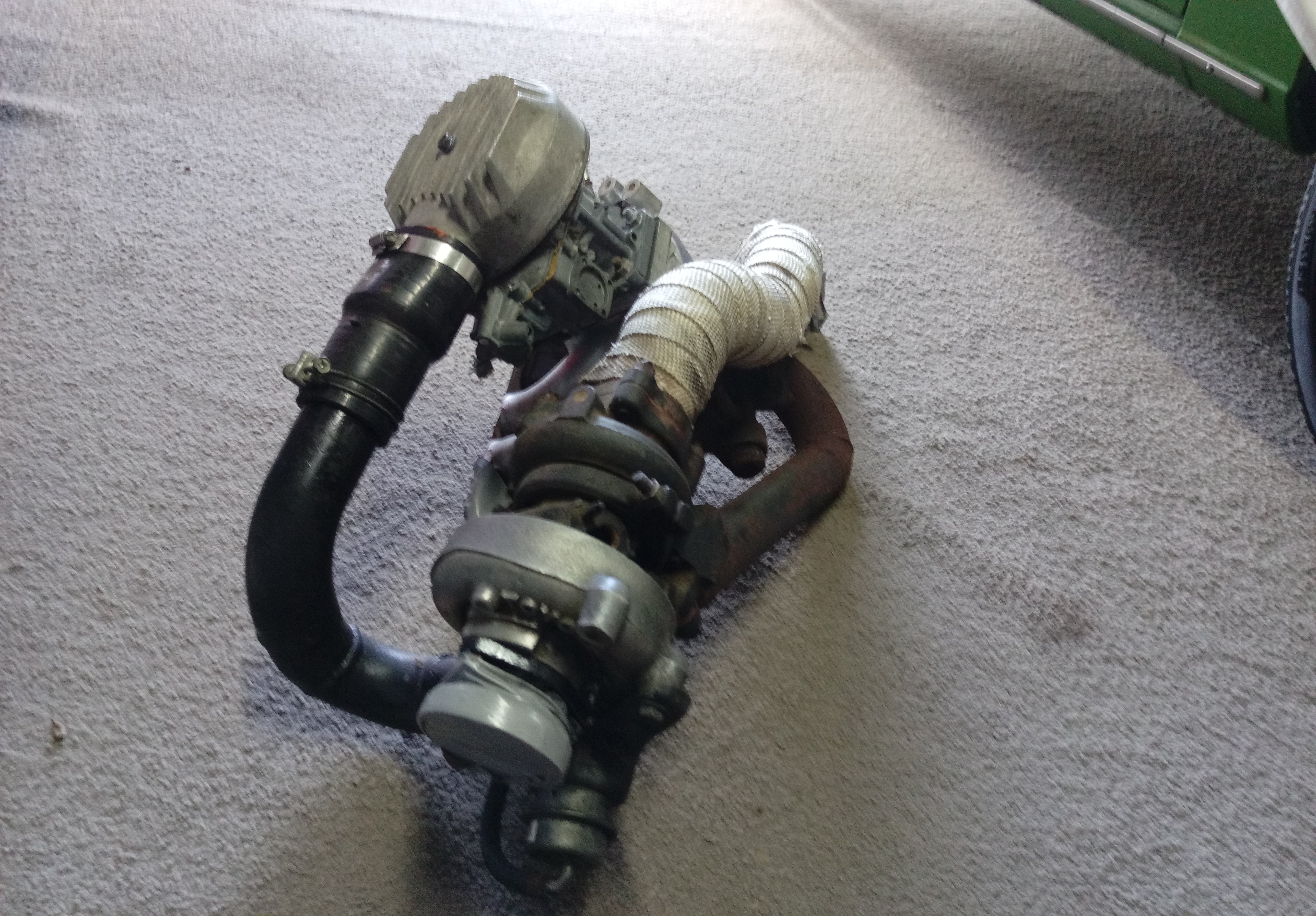

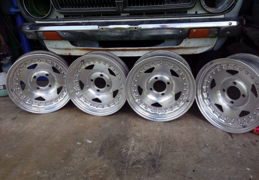

Clapped out Posted April 19, 2019 Author Report Share Posted April 19, 2019 While I was at it, I decided to fish out an intake and some wheels I've got sitting around, what you guys think?😂😂 2 Quote Link to comment Share on other sites More sharing options...
Taz_Rx Posted April 21, 2019 Report Share Posted April 21, 2019 It's that a ct12? They're a bit too small for a k really Quote Link to comment Share on other sites More sharing options...
Clapped out Posted April 21, 2019 Author Report Share Posted April 21, 2019 Hi taz, I'd totally agree with you on that one, it is small, and yes, a ct12. Although it is a budget build and I've got it sitting around doing nothing so might as well use it, the motor I have for this car has everything plumbed for it. Keep costs down!😂😂😂😂 Quote Link to comment Share on other sites More sharing options...
Taz_Rx Posted April 22, 2019 Report Share Posted April 22, 2019 I'm never going to dis you for turboing a k mate. Instead of the usual 'why bother, just put a 4age in it' comment.... fucking sheep. Just do yourself a favour and don't use anything but a stock cam. Response will be great, but top end a little dismal. Just crack another gear 😉 Quote Link to comment Share on other sites More sharing options...

Clapped out Posted April 30, 2019 Author Report Share Posted April 30, 2019 Yeah taz, the motor I'm using is pretty much stock standard, going to lock the dizzy and that's about it really. Obviously I'll throw a set of rings and bearings through it at most! Kickn5k, That sounds encouraging, although I will be mega happy with anything 60hp+ at the wheels!😁😁 Quote Link to comment Share on other sites More sharing options...

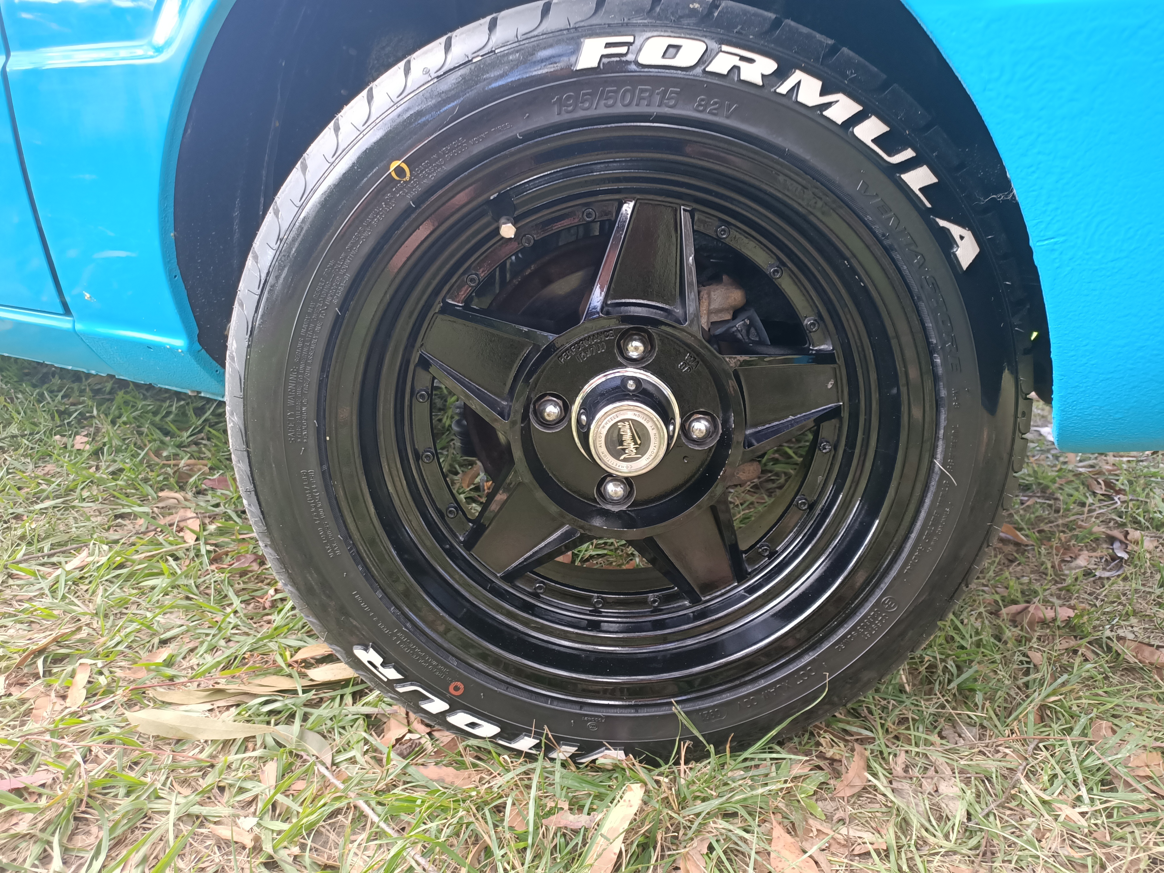

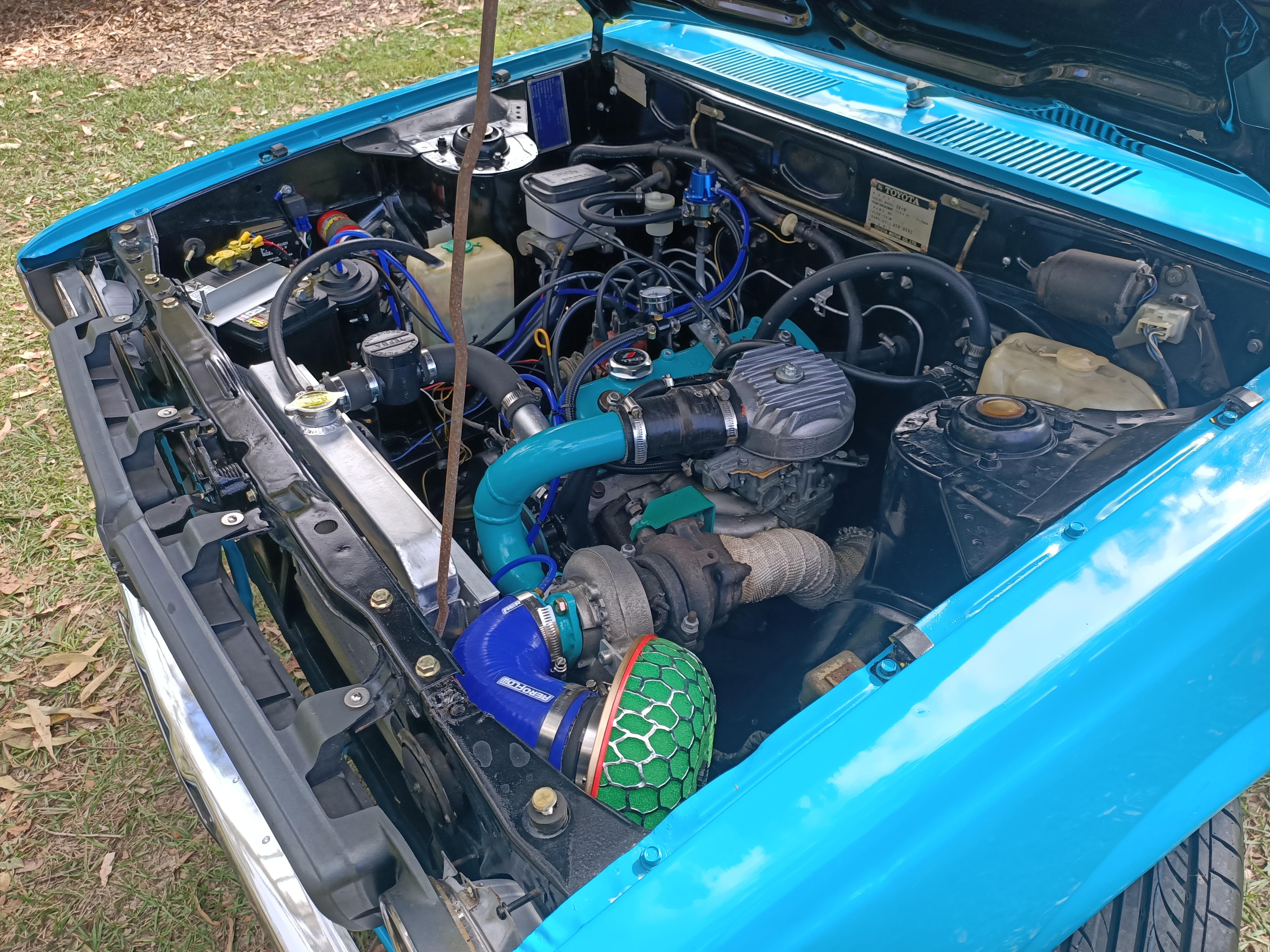

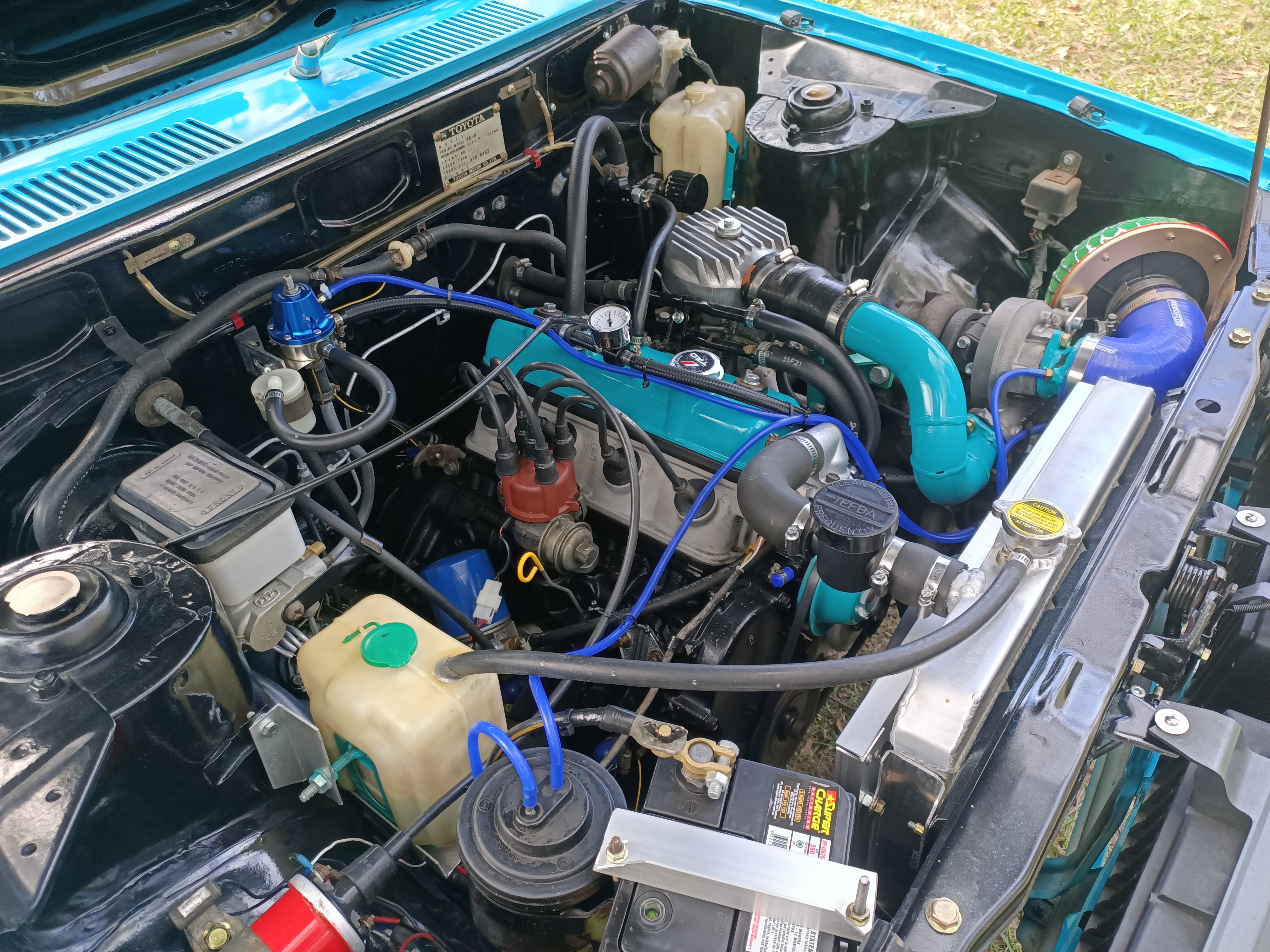

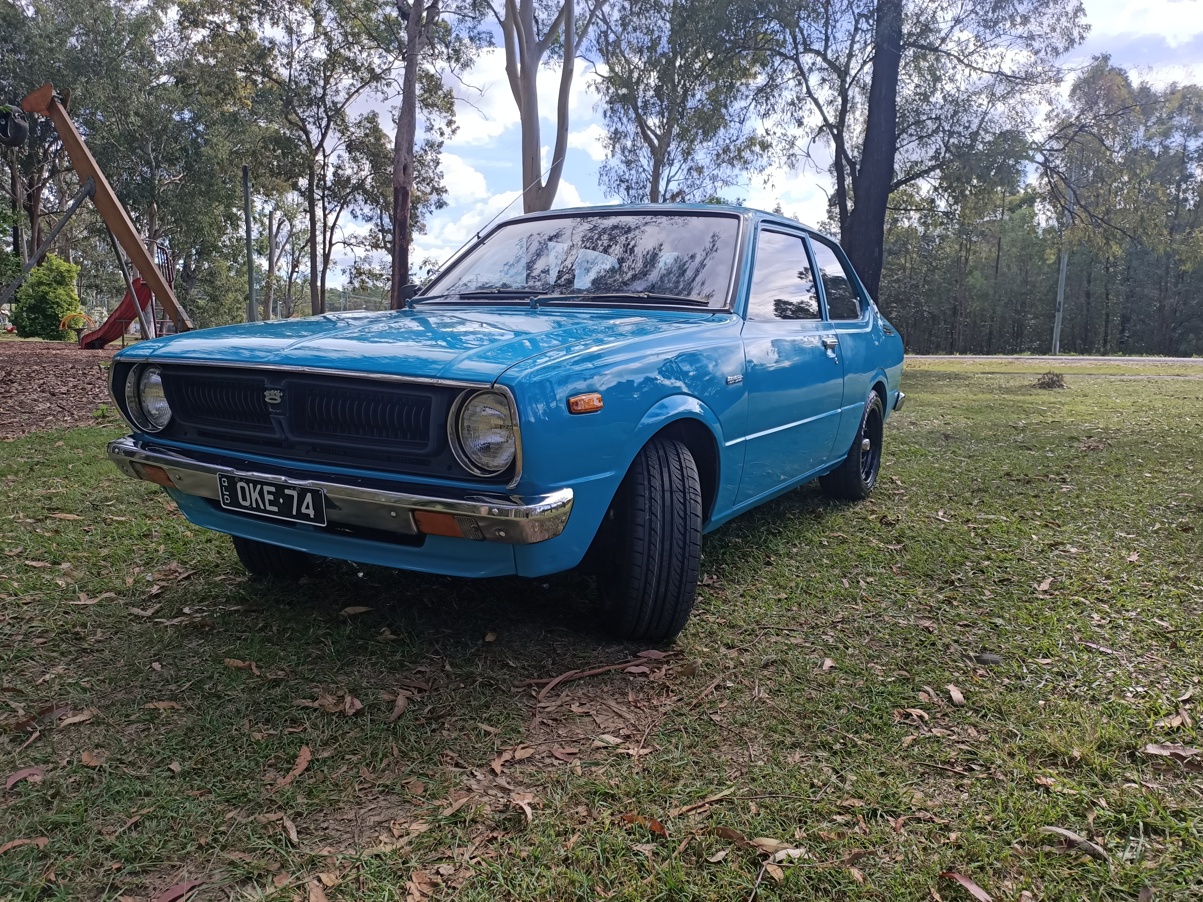

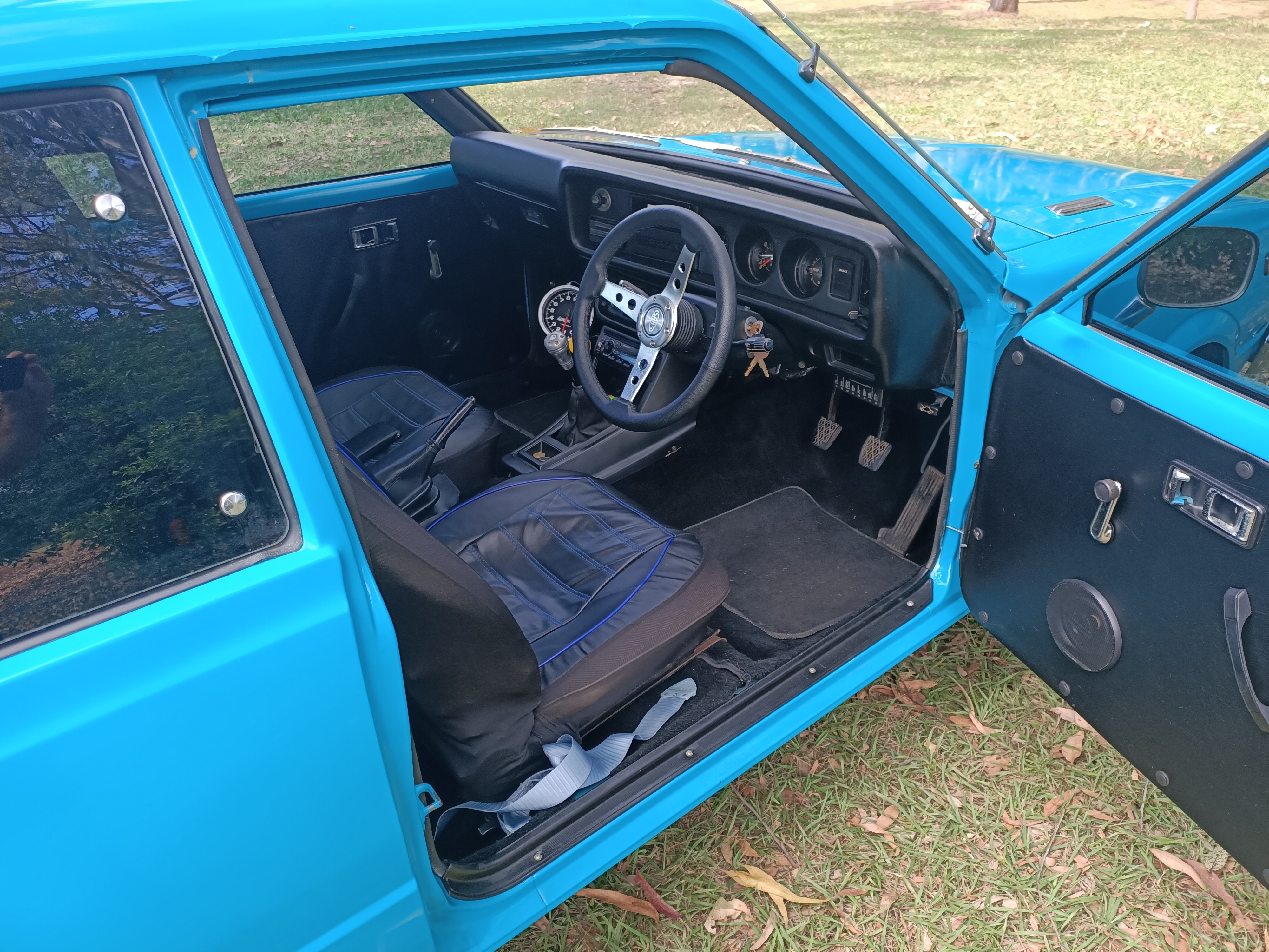

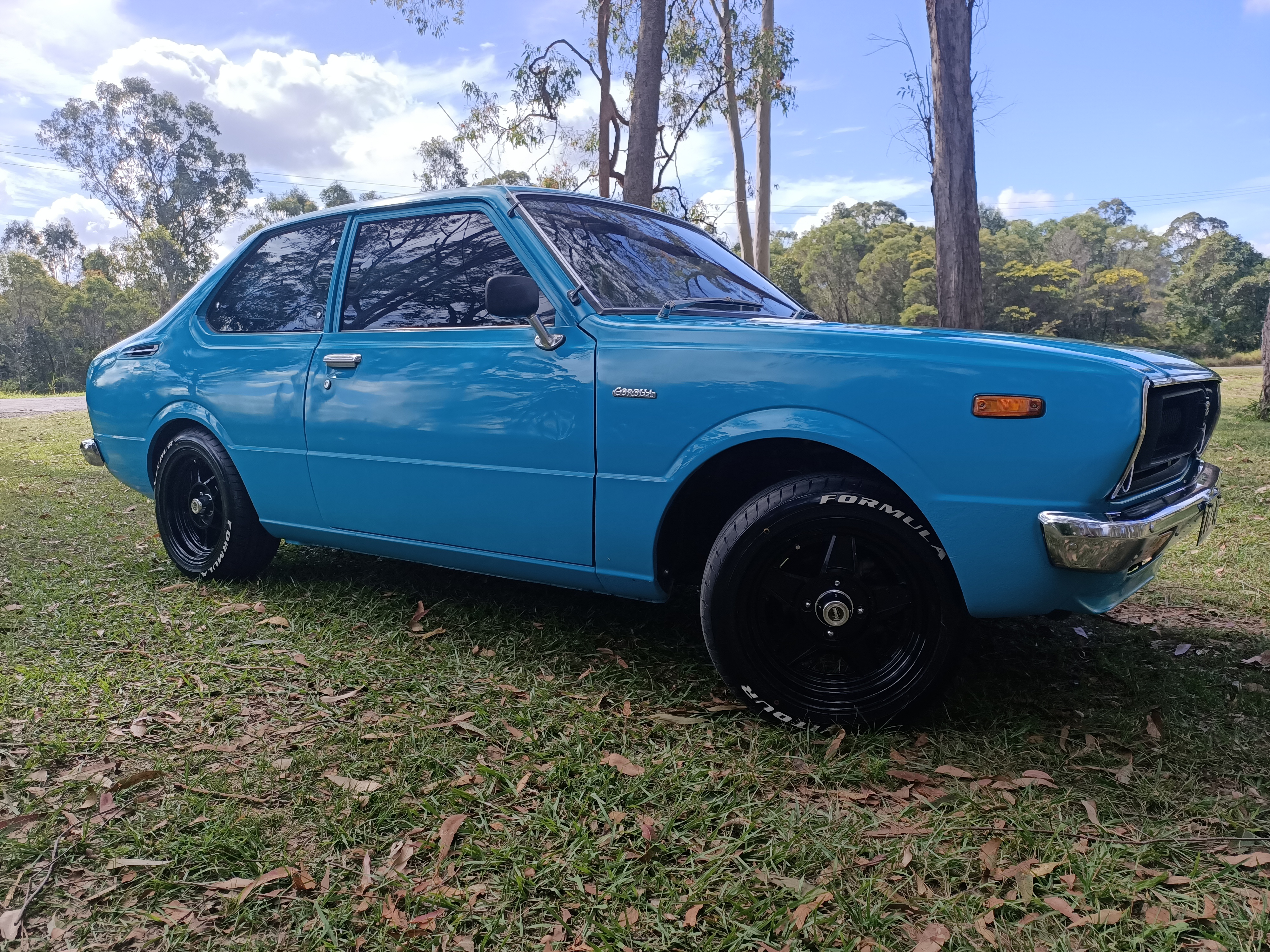

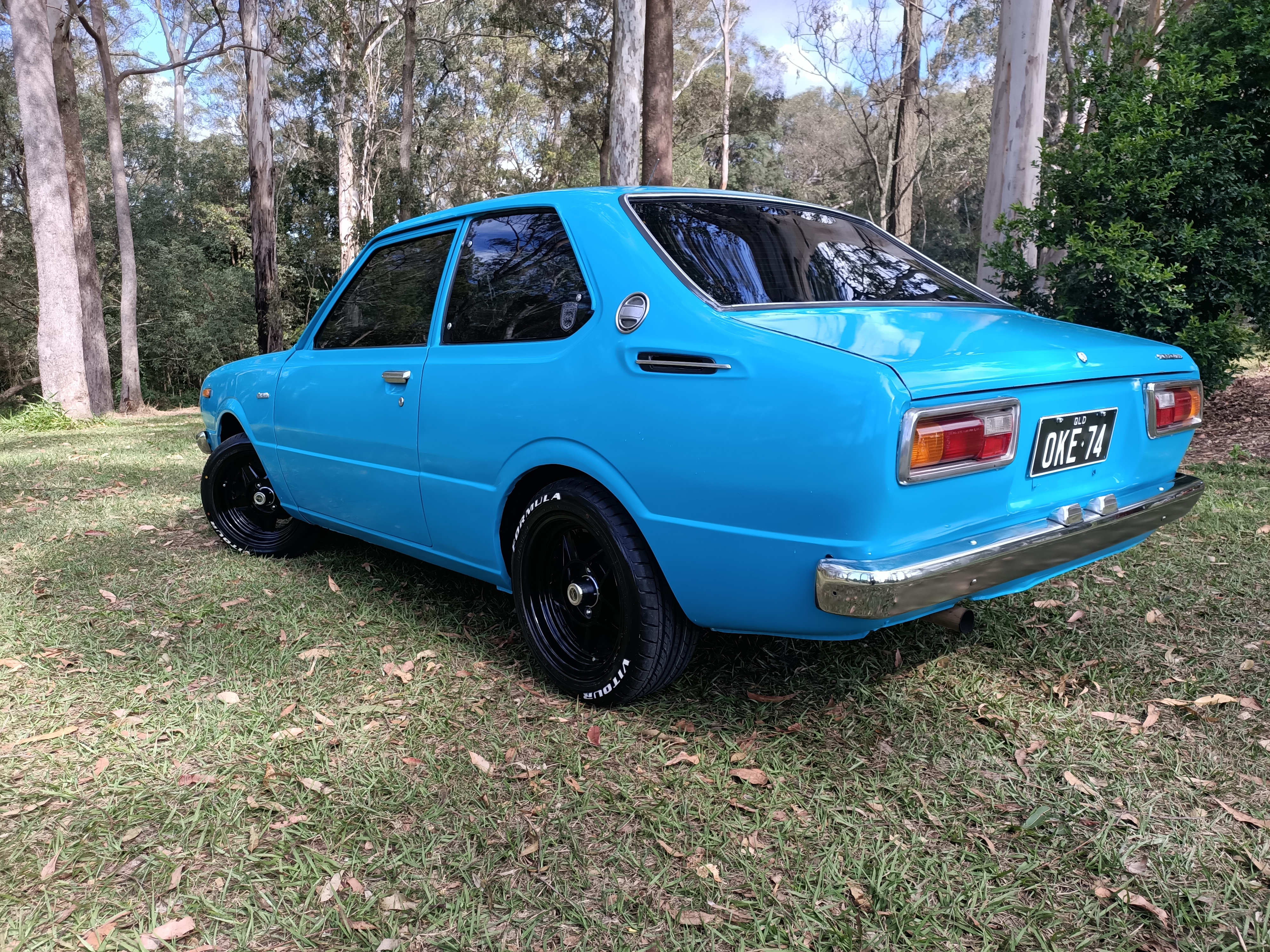

Clapped out Posted April 9 Author Report Share Posted April 9 And just like that, it's finished, slight change of plans on a few things, been on the road now for almost a year, and took 6 months of "trial and error" to get it to finally run as it should! 1 Quote Link to comment Share on other sites More sharing options...
