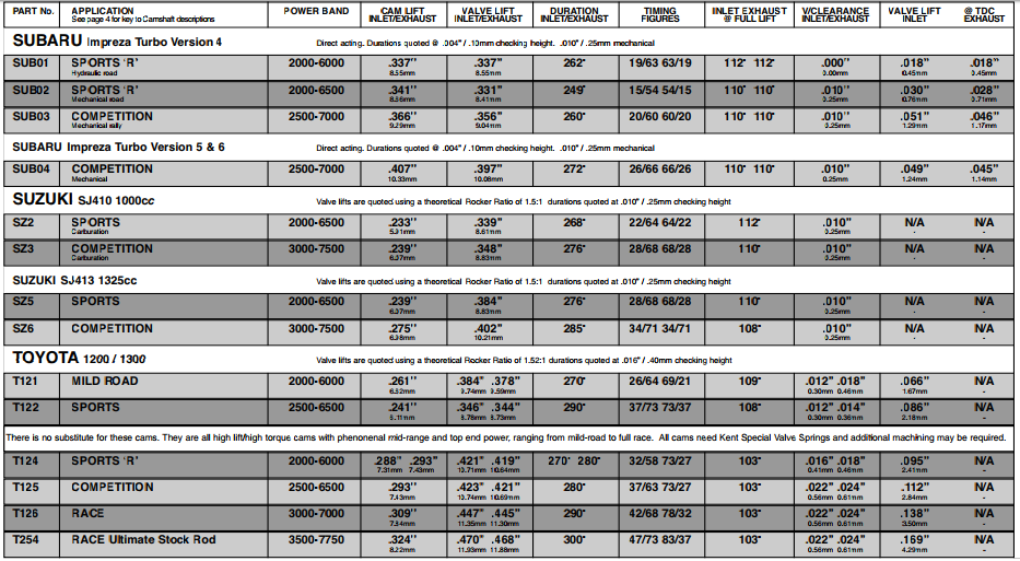

As for duration and lift I'm gonna present you a print from the Kent Cams catalogue with the camshaft data (T124 "Sports R" and T125 "Competition").

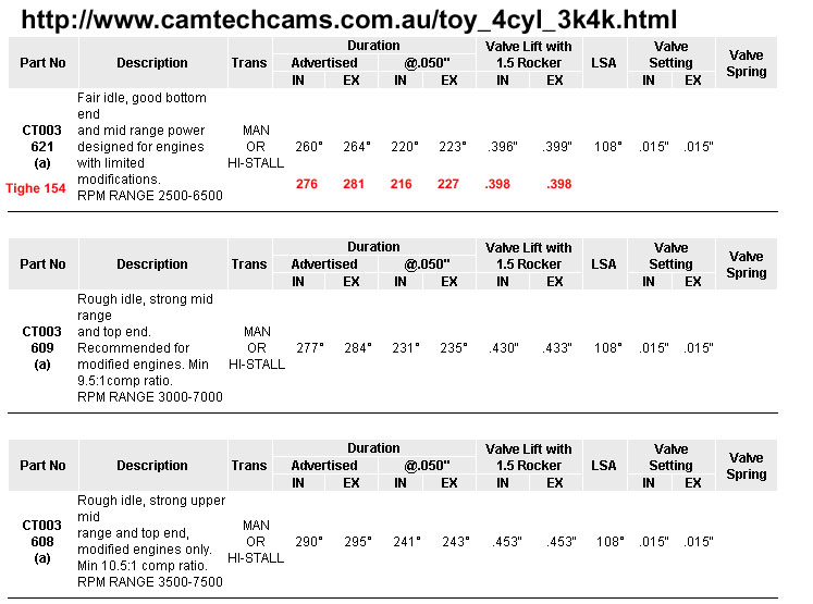

The usual max lift is 0.4" before you need aftermarket vavle springs, although guys on here say you can easily go higher.
The 50thou comment is because some cams open and close more slowly than others, so the duration at a 50thou tappet gap gives a better idea of the working duration than the 'advertised' duration.  If you don't have options for a cam supplier it just doesn't matter, but you can see it in the 5 companies cutting cams for K motors over here.
You can see the diffrence here-  look at the Tighe 154 two durations, and then the 609. The advertised durations are close, but the Camtech cam has a lot more at 50thou, which means more performance.
ps, personally I wouldn't polish your head ports, leave them rough so you get better mixture of your air/fuel, been there, done that, better results from being rough,
I get it, I'm gonna contact Kent and ask for diagrams with more deep info.

depending on the quality of fuel in your country, id be aiming for 10-10.5:1 compression and a road engine and over 11for racing
The t125 looks more like in line to your goals to me. With single barrel per cylinder carbys, it should be nice enough to drive

I think the T125 has the need for dual valve springs but on the other hand doesn't have the need of me sending my stock cam for regrind. Would an adjustable pulley be needed with the 125?
