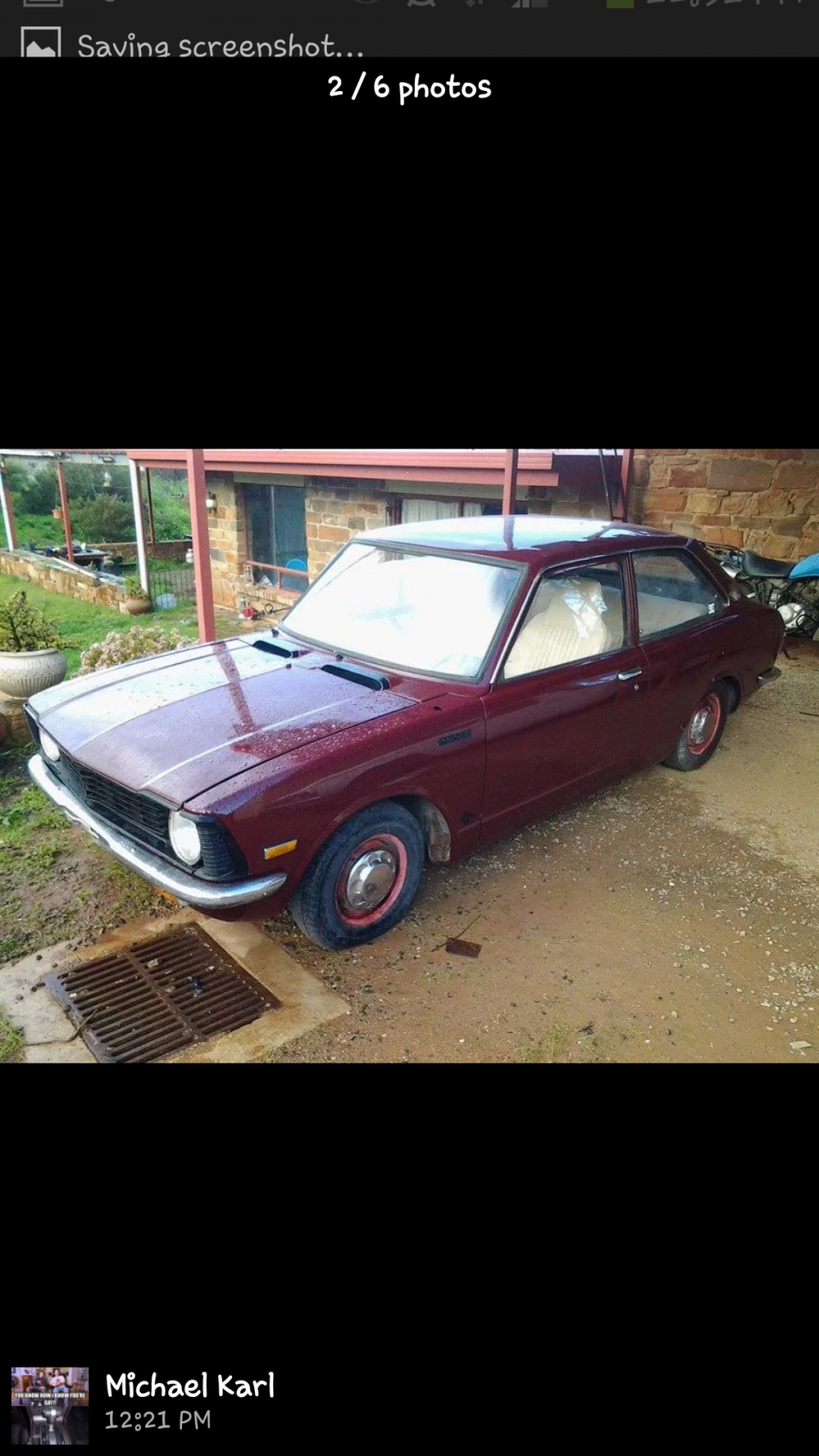

Hey guys.
Just purcahsed my first rolla, a ke20 with a 4k and 5 speed.
Paid $1500 so you can probably guess the condition of it ;)
Anyway, I'm having a hard time working out all the things that are wrong with it. I just want to get it running and mobile so I can take it places to get fixed. I like to think I'm the handy type (I love working on cars) but I'm not and have no clue what I'm doing haha.
If anyone down south morphette vale area knows a thing or two (I think it's mainly electrical) and feels like helpung or at least telling me what I'm in for I would be much appreciated and would work out some $$
That being said. I also have a spare freshly rebuilt 4k engine with 3k manifold a 5 speed box and brand new garret turbo that could go to someone for getting my car running ;)
Hope to meet some of you soon anyway tho :)
Thanks guy.
Yeah I will be throwing up pictures as I go.
Had a mate come round today, the starter motor is not wired properly and when it is wired has constant power. Thinks it may be ignition problem.
Things are already looking better.
