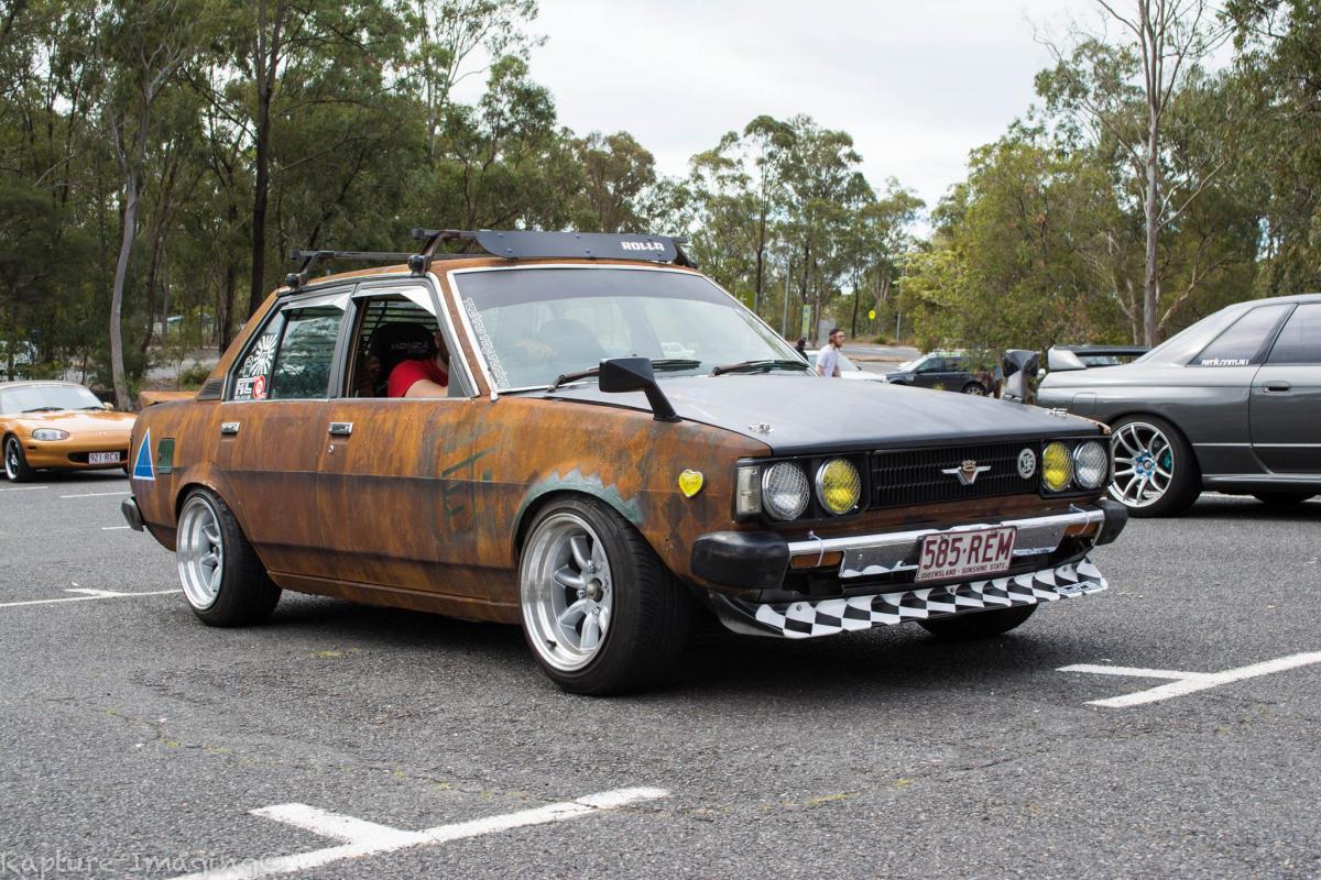

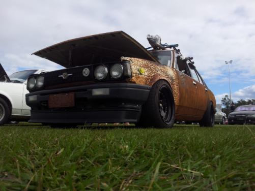

15x8 isnt as much work but it depends on the offset and how low you want your car?
You should get away with a minor roll of the guards and a 195 width tyre.

Do a google for "ke70 15x8 0" and you'll get an idea of how they sit
