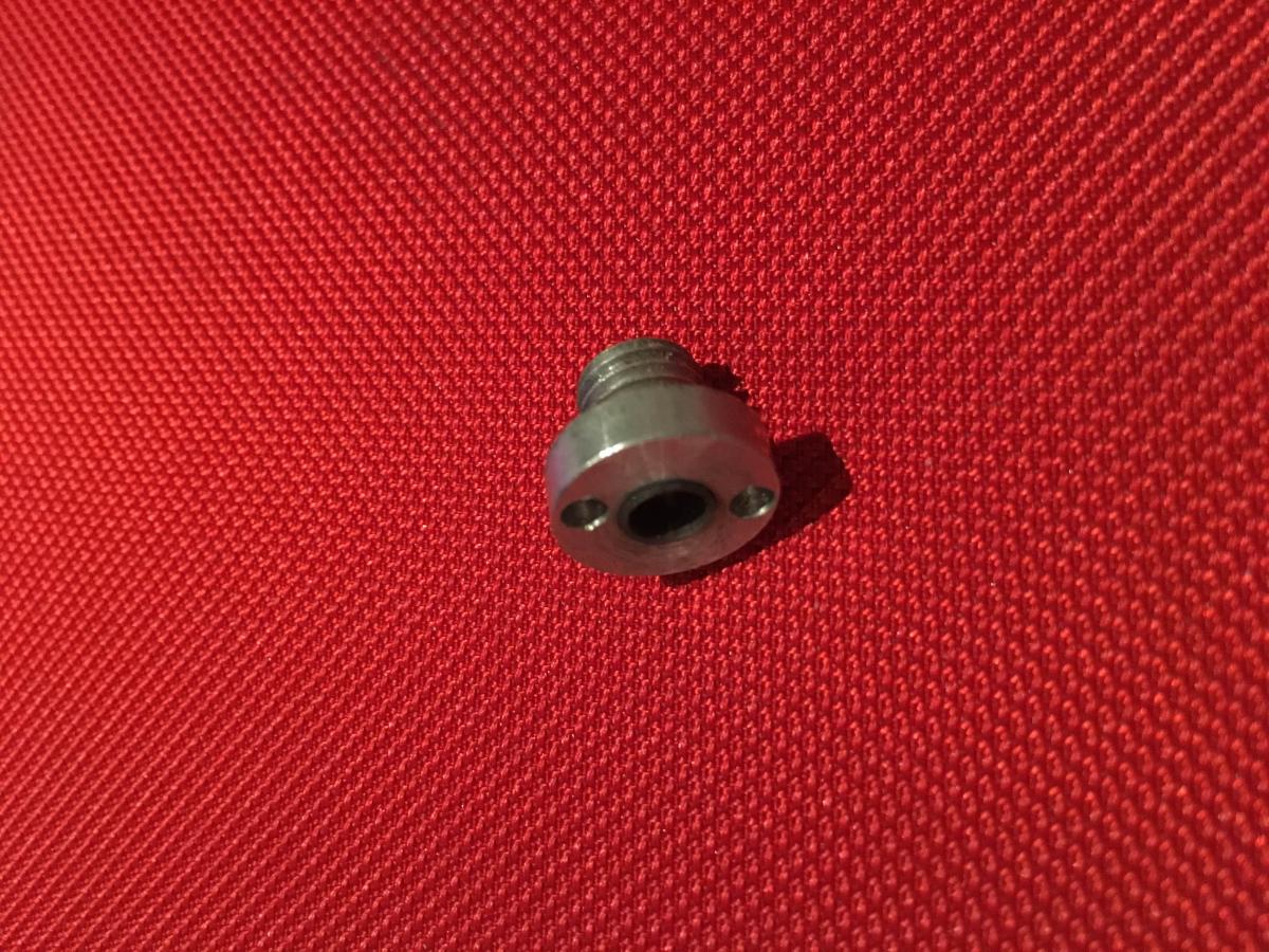

Hey guys what's wrong here ?
I can't get my switch to pull tight
What holds it at the back of the cluster there is no bracket that stops it moving when you pull the switch in and out.
Am I missing something
There is a little threaded "nut" that winds up the threaded switch shaft from the knob side and pulls the switch into the console firmly.
In earlier models it is a round aluminium looking job with two drilled points on the face you can tighten with the prongs of a long nose pliers.
Later models had a plastic nut you do up with a spanner.
I'm tipping from your photo you need the earlier type.
I'll put up a picture when I get home if someone doesn't do so first.
